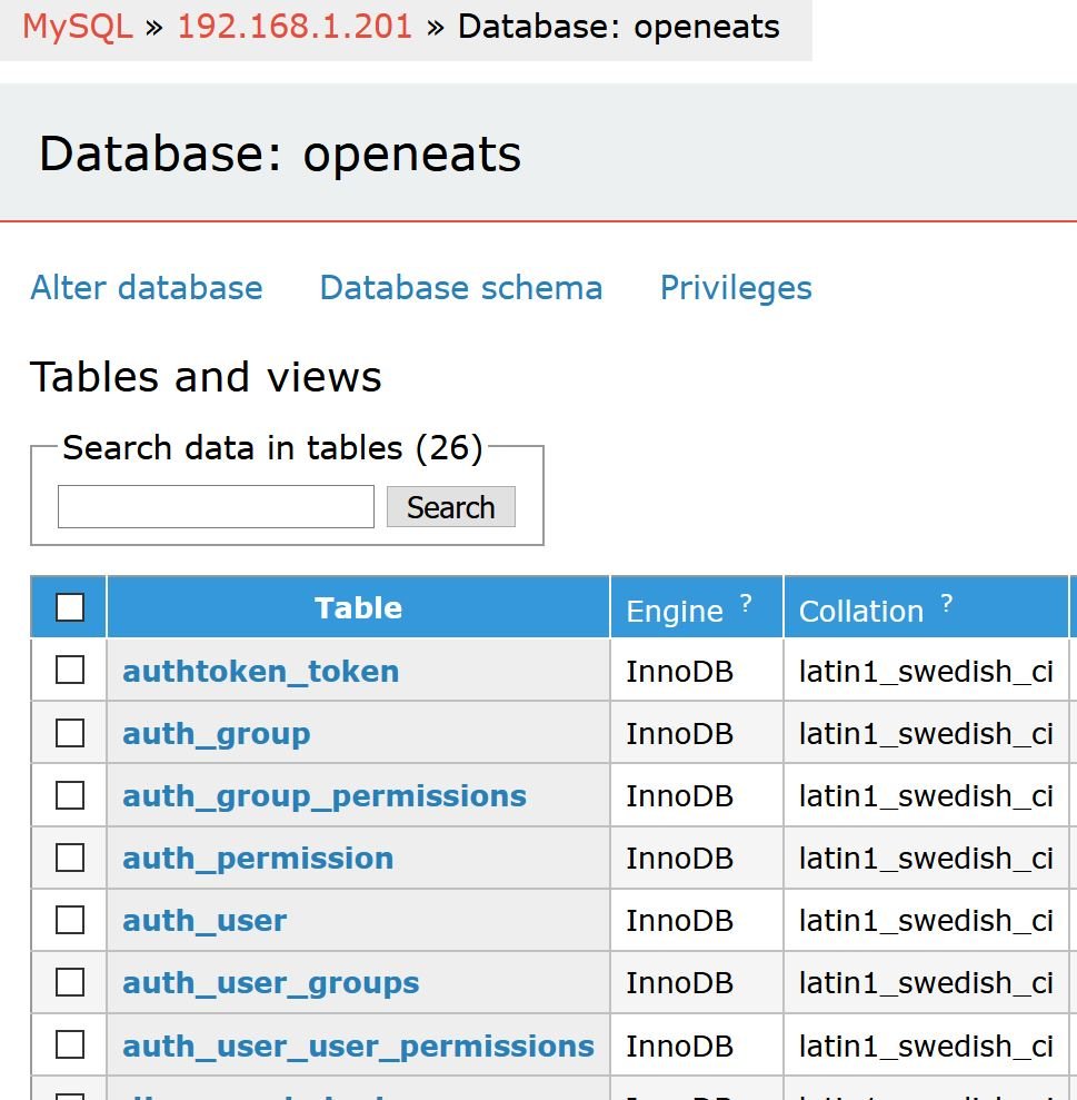

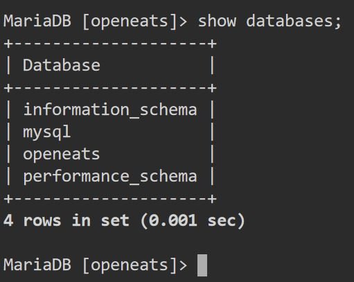

  2. New update, I think part of my problem was that I had the port on the end of the MYSQL_HOST line. After removing open eats and set it up. I left it off. I now have tables in my db. See below. Unfortunately, like @GhoulishPaladin I am not able to log in to the admin page, I still have the default Superuser_Name/Superuser_Password word set to openeats/openeats

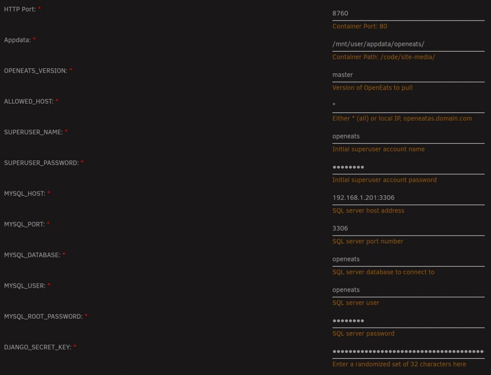

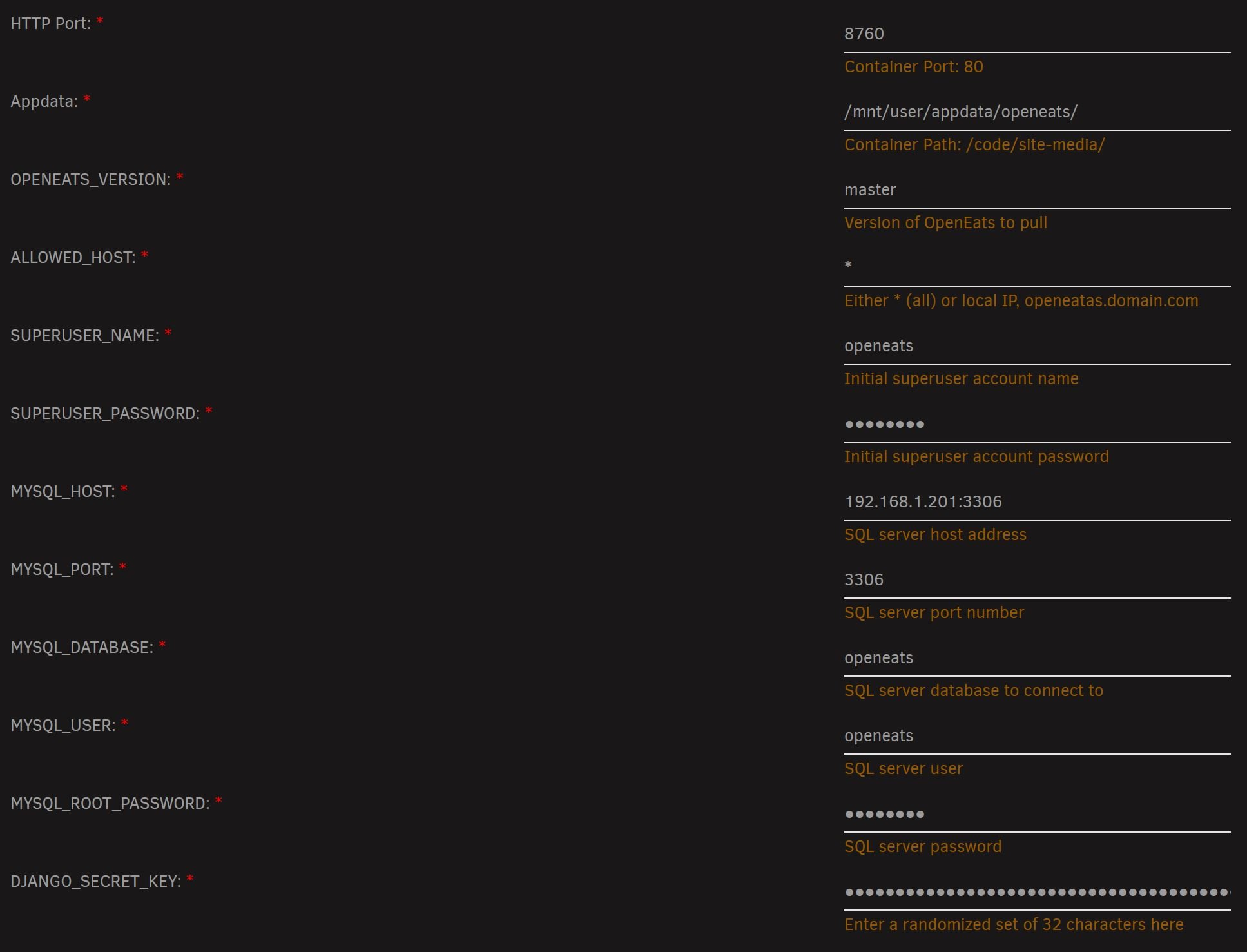

  3. Like this? because that didn't work either.

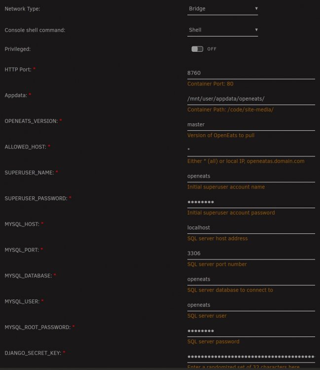

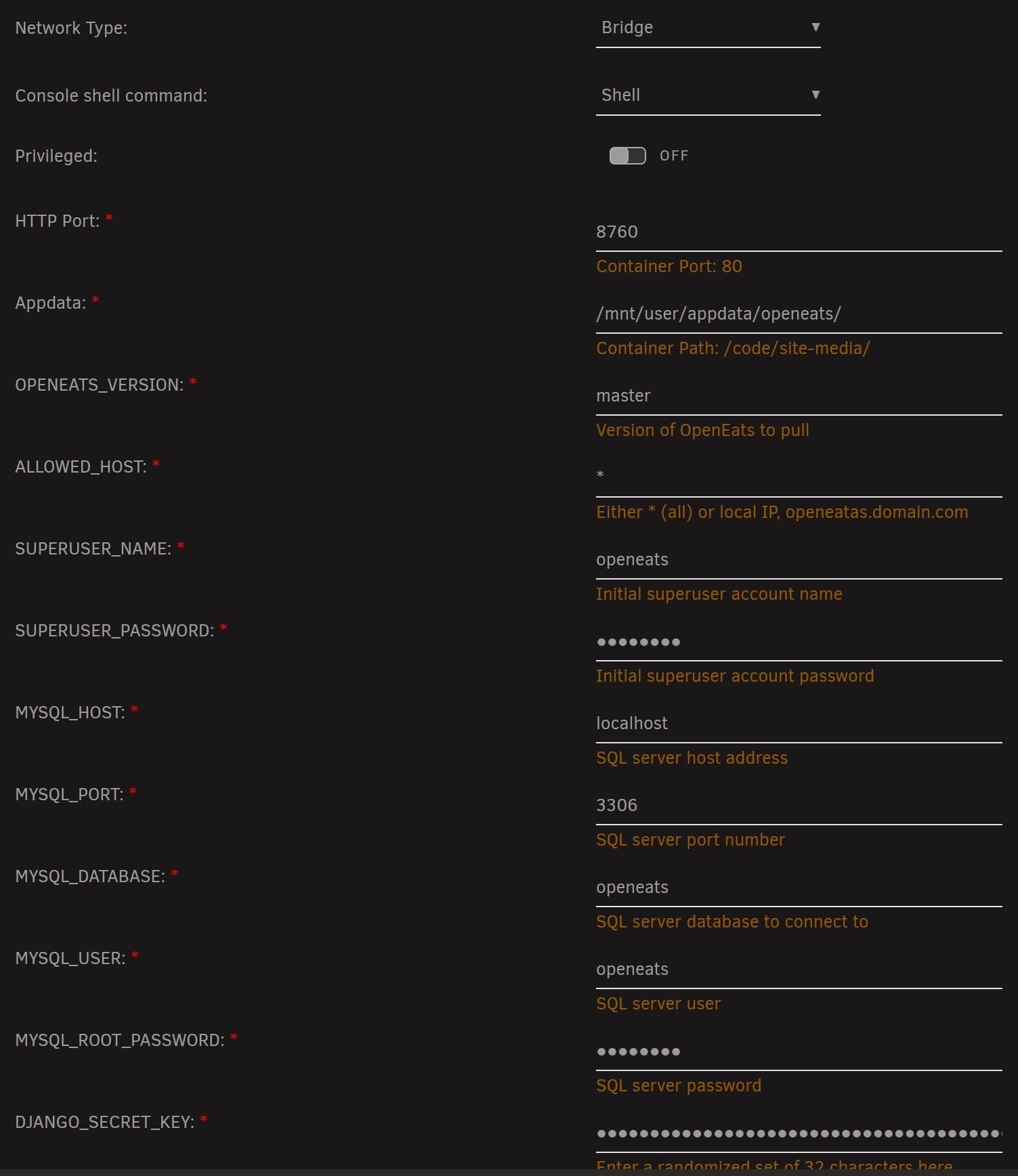

  4. I updated it to point to the server ip/port. Still no changes and unable to login.

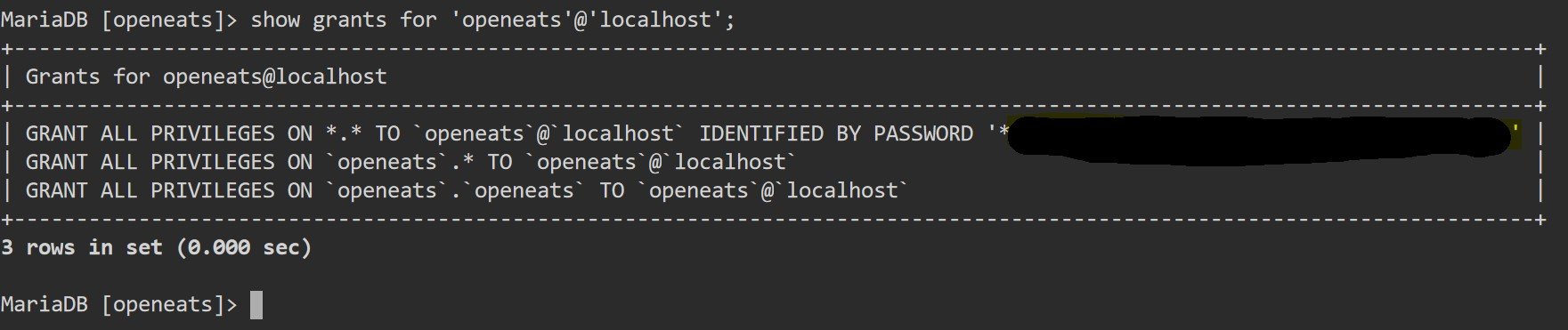

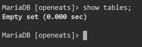

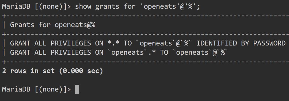

  5. I have been trying to get this docker setup for a few days. I have mariadb installed, I created a db named 'openeats', then created a user with all of the proper privileges. At this point I have a db and user with no tables. I then install the openeats docker but no matter how long I wait the tables are never created in the database. I check this via the terminal. nada. I also am unable to login to the admin page. I have deleted everything and started over multiple times. I don't know what I am missing. I have added all the settings and the log files. any help would be greatly appreciated. openeats logs.txt
