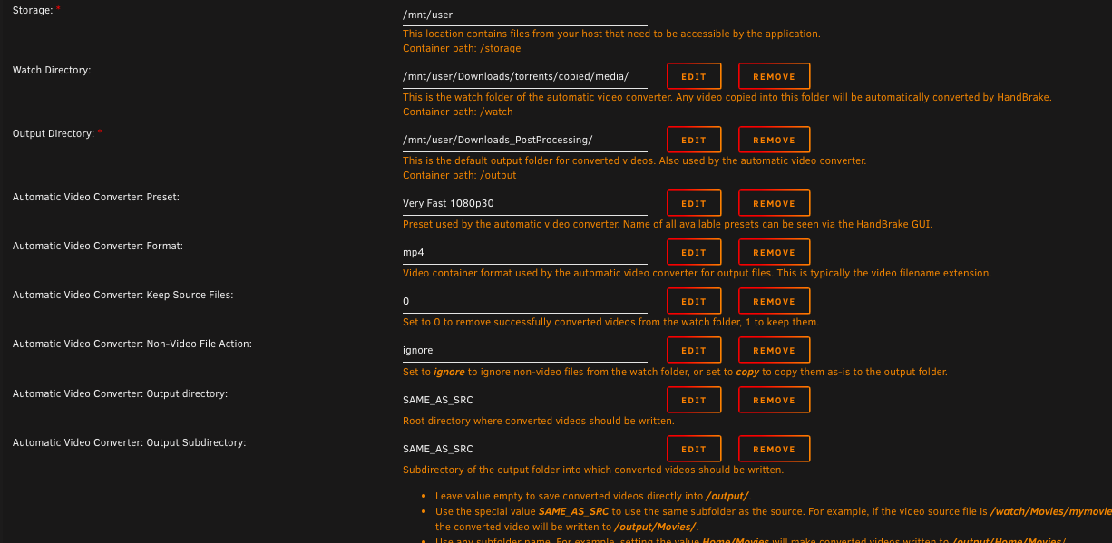

  1. Thanks for that I deleted both the sucessful_conversions and the failed_conversion and ran Handbrake again. It didnt work, however the container log is giving more info; Basically it is saying if I want to put media back where it came from the 'SAME_AS_SRC' flag it doesnt exist what is confusing.... I have also attached a pic of my container attached;
  2. I have navigated to that exact folder but there is no log file inside it? Handbrake is running inside my docker on unraid but no log in that folder. This extract is from the bottom of the Unraid Handbrake Docker log. The one when you click on Handbrake in Unraid and then press 'Log'; Any other ideas what could be happening?
  3. Hi, I have setup Handbrake to watch a media folder that I have made on a Download share. However HandBrake wont transcode anything that is put in the folder. I have extraced what I get from the Log; Any ideas how this can be fixed? Many thanks,
