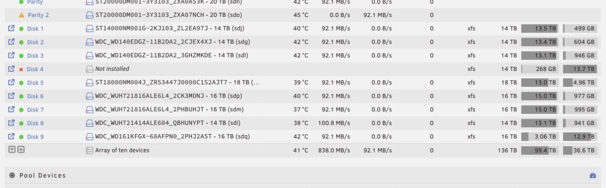

  1. This is what I'm seeing so far.

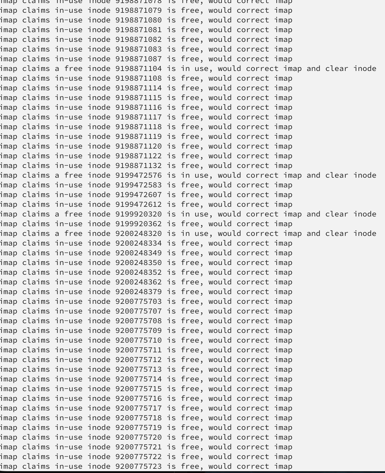

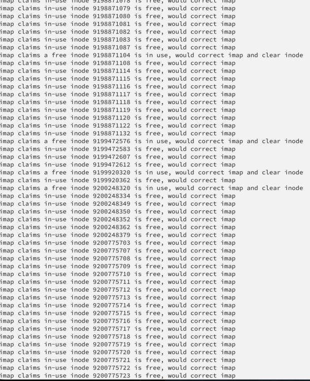

  3. I assume thats by clicking the check filesystem button next to the unassigned drive correct? How long does that take? It's going currently waiting for a finish to post the results.

  5. I do have the old disk it’s intact and attached as an unassigned device that’s unmountable. Currently parity is rebuilding parity due to the parity disk error. Should I stop parity. I will only have 1 parity drive at the moment. And try maintenance mode to repair the unassigned disk 4 file system?

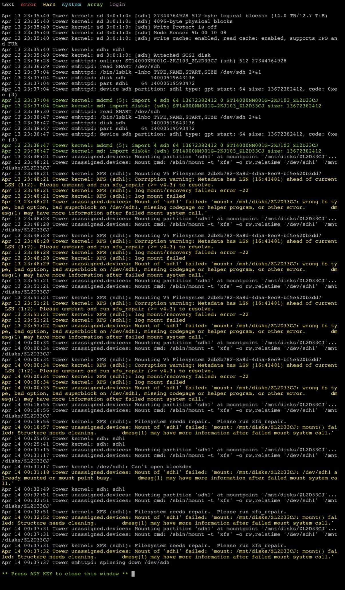

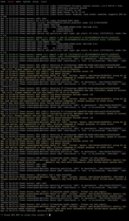

  7. Disk 4 was nearly full. At least I think so. I can’t answer if it was. When I click on disk 4’s contents via Krusader it has 2 folders with nothing in them. wierd that emulation would save 2 folders but not the other data correct? I have disk 4 still attached but in unassigned devices because it has data on it. I cannot mount disk 4 through maintenance the screen shot is of disk 4’s log. What should I do to mount that drive and hopefully save the data?

  9. This is the current mission disk. It’s in unassigned devices. I cannot mount it. I am attempting xfs_repair to fix the file system. Anything else I can do? The data that was on this disk in the array was being emulated. When the parity had errors it began to rebuild without disk 4 now there is no data on disk4 that data is sitting on the errored drive and unable to be rebuilt by parity since it doesn’t exist. New diagnostics attached tower-diagnostics-20260414-0041.zip

  12. Here are the diags tower-diagnostics-20260413-1105.zip
