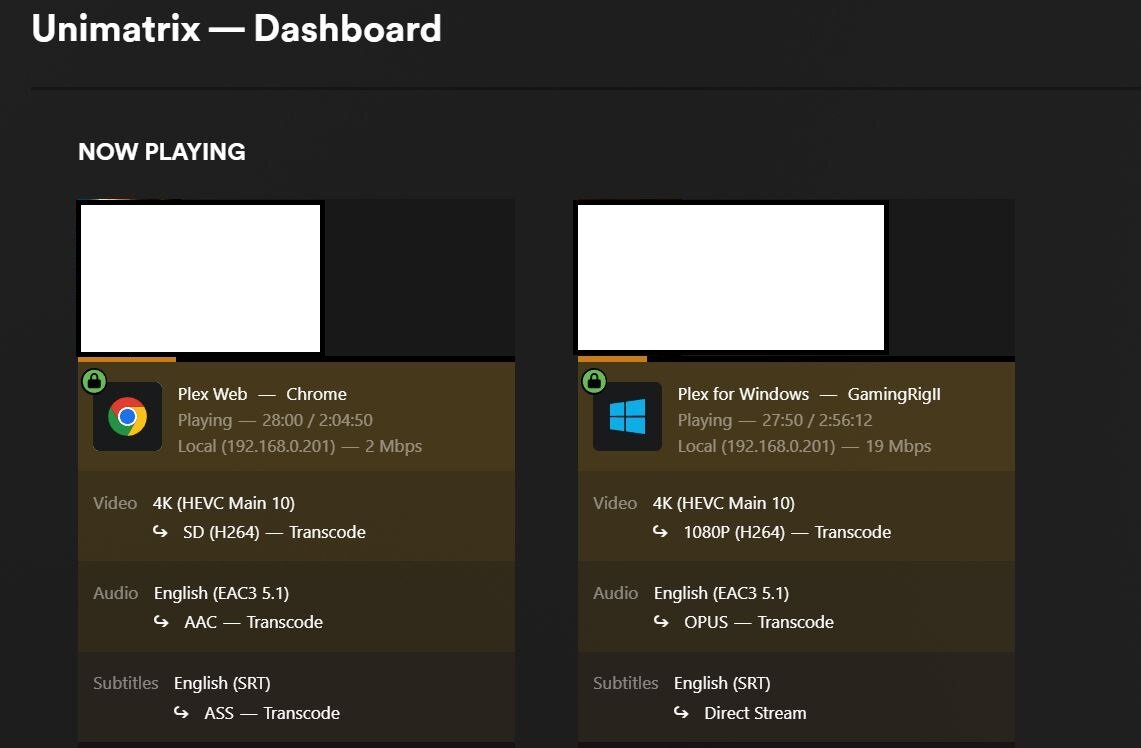

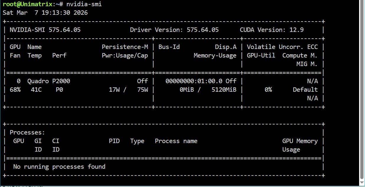

  1. -Dedicated plex players, yep got it. The browser was just more convenient for me. -So I've disbled the subtitles by default and I was able to get HW transcode with the video for the first time. Isn't it supposed to HW Transcode audio as well? -So i picked a movie i had both 1080p and 2160p and strangly, it would only HW transcode from 1080 file and not from the 2160. -Haven't touched the codec folder just yet. -I updated my nvidia drivers to v580.126.18 as you recommanded but after restarting Unraid, I'm now unable to change video quality weither it's from dedicated plex players or web browsers...
  2. I was never able to get Quick Sync to work either in the past, that's why i've added the GPU...

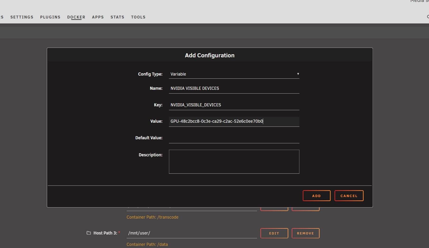

  3. Yes, I have a lifetime pass. I did add the Variable, copied/pasted the gpu id with no space at the end, command was successful, restarted plex. Same issue, the CPU is almost maxed out and does all the work no HW transcoding.

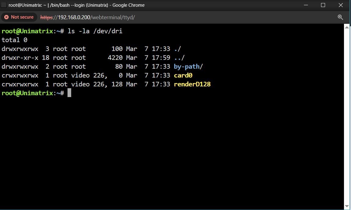

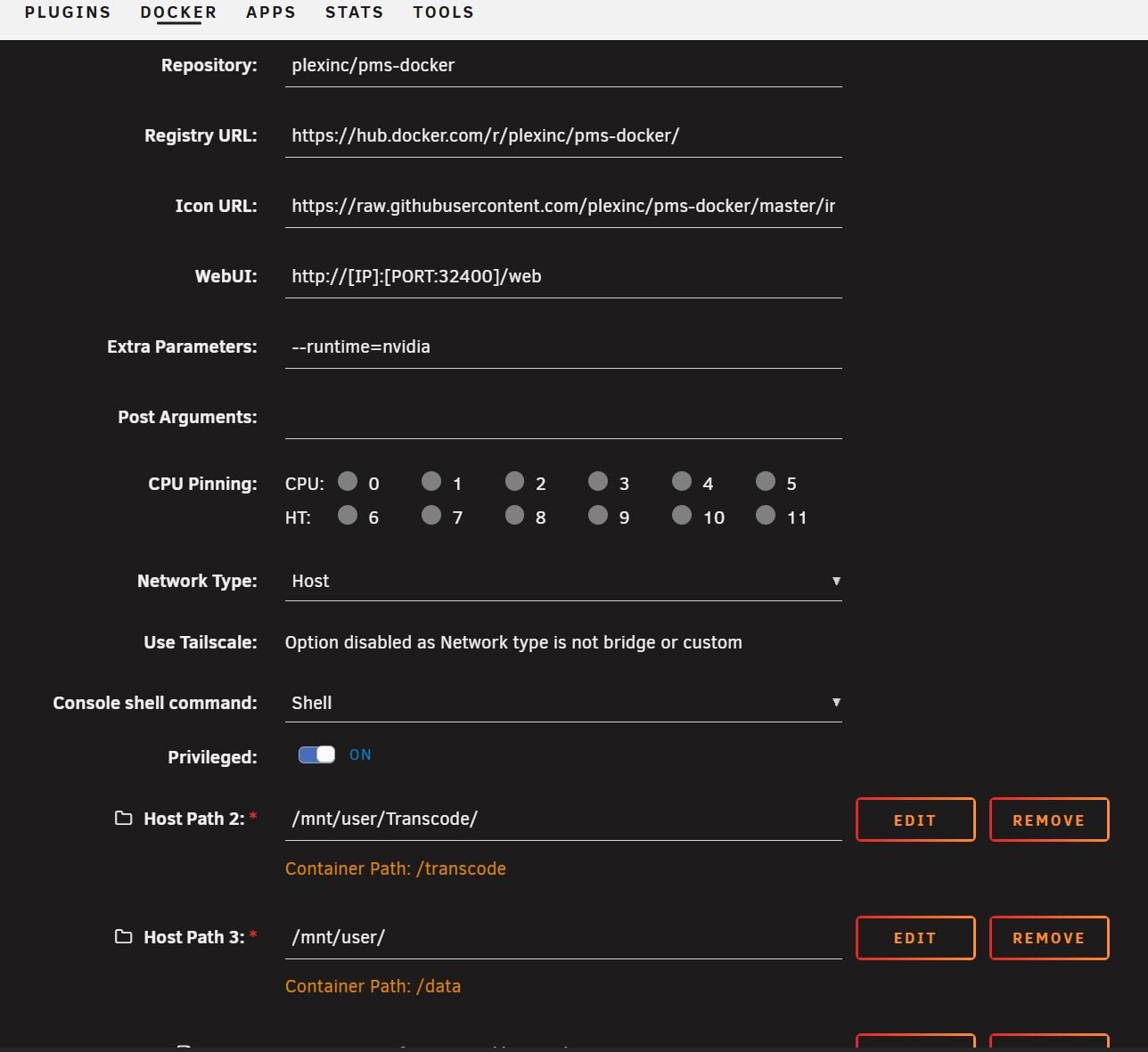

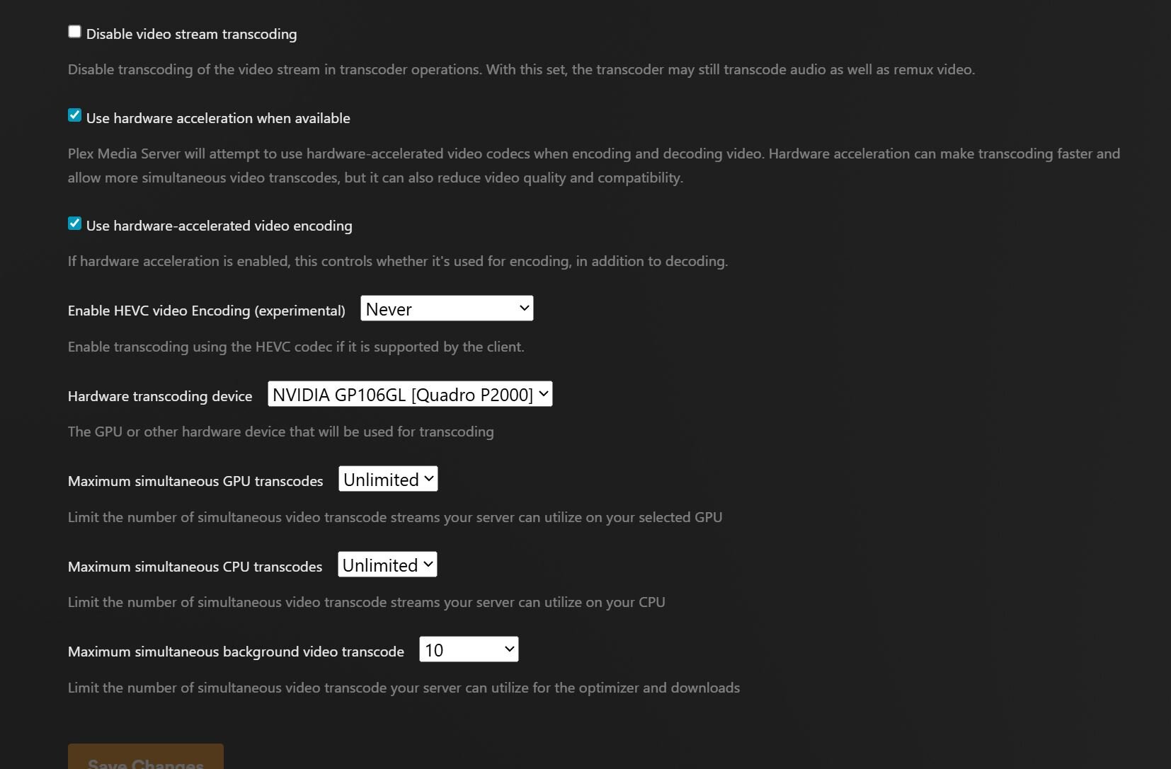

  4. Hello everyone, I've been struggling to get any HW transcoding (CPU Quick Sync) or GPU on my plex for months without any results. I've looked at every forum threads and youtube video i could think of and NOTHING worked!!! I'm getting really frustrated. I have an i5-11400, P2000 and 32gb ram. See screenshots below, also attached diagnostic. Also if I try to stream more than one stream, the second stream runs at like 1-2mb and no option playback quality to change from... Idk what else to do... Thanks! unimatrix-diagnostics-20260308-1342.zip

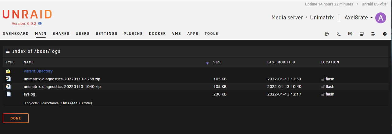

  15. Ok, my apologies. I went into the /boot/logs folder and I see one syslog file and two disgnostic files. See attached files. I hope that is correct... unimatrix-diagnostics-20220113-1040.zip syslog unimatrix-diagnostics-20220113-1258.zip
