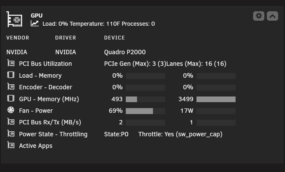

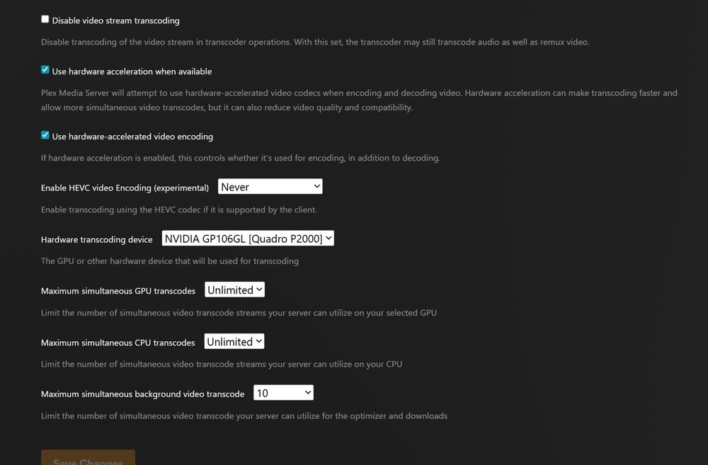

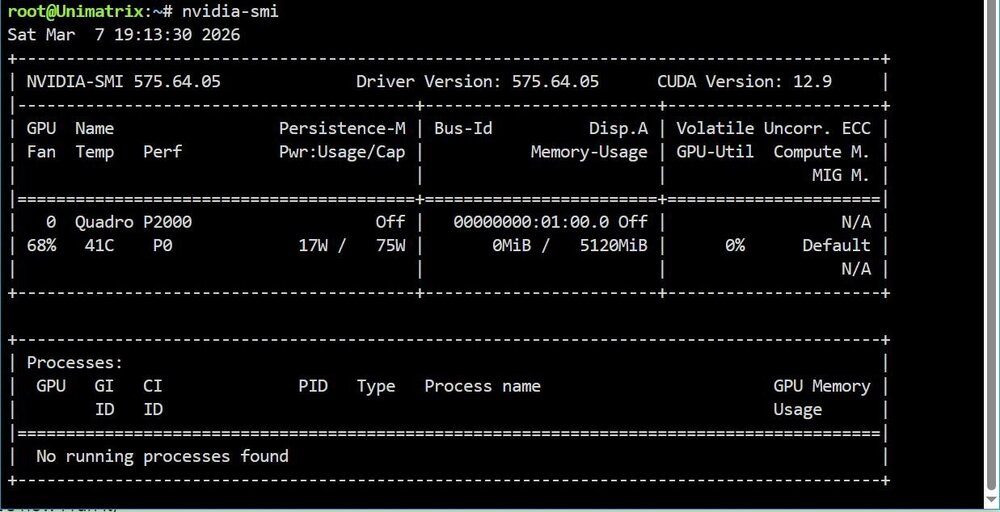

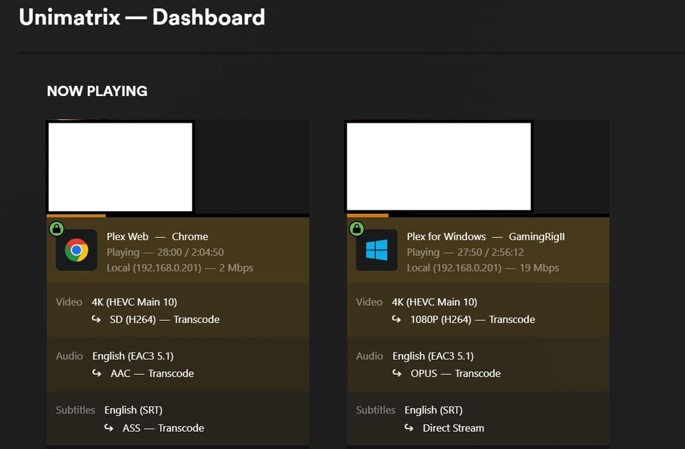

Hello everyone, I've been struggling to get any HW transcoding (CPU Quick Sync) or GPU on my plex for months without any results. I've looked at every forum threads and youtube video i could think of and NOTHING worked!!! I'm getting really frustrated. I have an i5-11400, P2000 and 32gb ram. See screenshots below, also attached diagnostic. Also if I try to stream more than one stream, the second stream runs at like 1-2mb and no option playback quality to change from... Idk what else to do... Thanks!

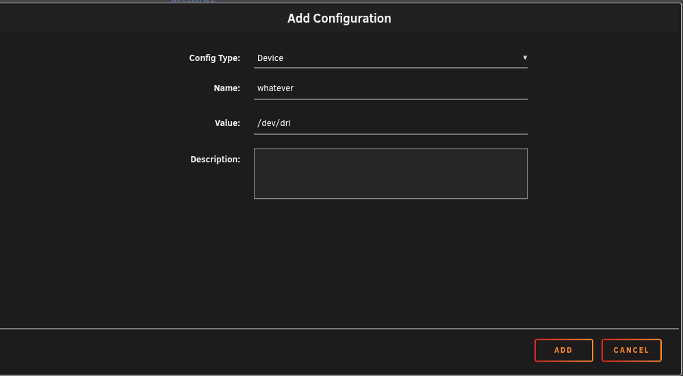

Two questions to confirm:

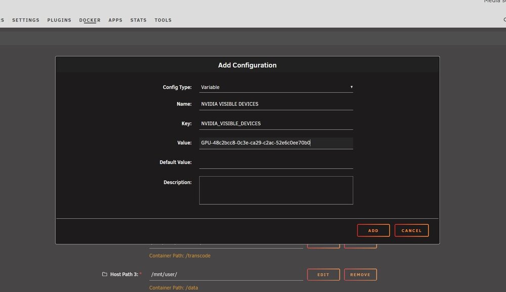

  • Do you have Plex Pass, and the server is claimed/recognizing this? Hardware only works with Plex Pass.

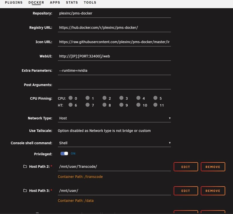

  • Do you have NVIDIA_VISIBLE_DEVICES as a Variable in your Docker template? If so, make sure the GPUUUID is correct, and doesn't have any trailing/leading space char.

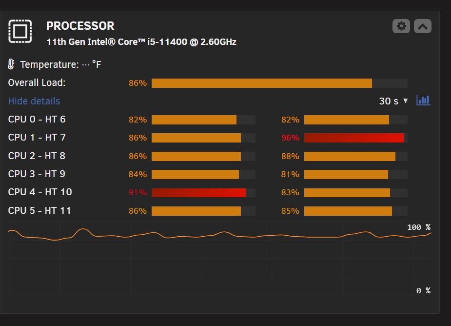

Yes, I have a lifetime pass. I did add the Variable, copied/pasted the gpu id with no space at the end, command was successful, restarted plex. Same issue, the CPU is almost maxed out and does all the work no HW transcoding.nvidia visible devices.JPG

This is an interesting problem. I looked through your syslogs, and didn't have anything out of the ordinary related to nvidia jump out at me. I will offer some things to try with troubleshooting which may help.
-- When troubleshooting, I recommend that you only test with dedicated Plex players, and never with the browser Plex web. The browser based Plex player is known to do wonky things when attempting to force transcoding.
-- Do not turn on subtitles in your testing. Plex cannot hardware transcode subtitles, and (in most cases) will not hardware transcode video if subtitles are turned on as well.
-- I see you are using the older v575.64.05 nvidia driver. I would try upgrading to v580.126.18, which is the last version of the v580 driver. Click the selection in Available Versions, not the Latest Production Version. This is the most recent version that works for Pascal based cards. The v590/v595 versions dropped support for Pascal (such as your P2000). I'm recommending this as Plex may have made a change which is looking for functionality that may not be in the version you are currently using.

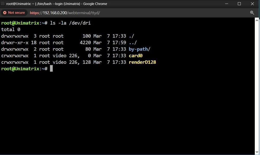

if its just the integrated intel gpu, adding the device parameter should allow Plex to see it. Multiple gpu probably complicating things.
Also check your integrated gpu is not disabled in bios.

-Dedicated plex players, yep got it. The browser was just more convenient for me.

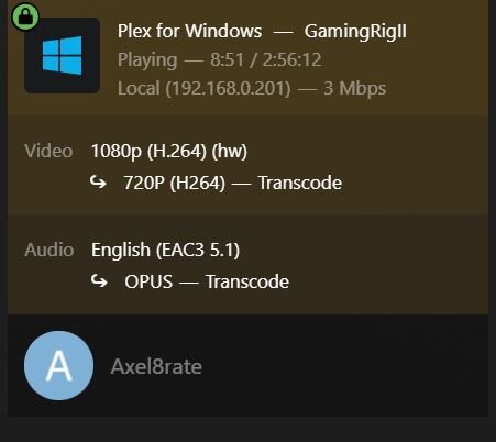

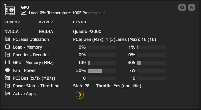

-So I've disbled the subtitles by default and I was able to get HW transcode with the video for the first time. Isn't it supposed to HW Transcode audio as well?
-So i picked a movie i had both 1080p and 2160p and strangly, it would only HW transcode from 1080 file and not from the 2160.
