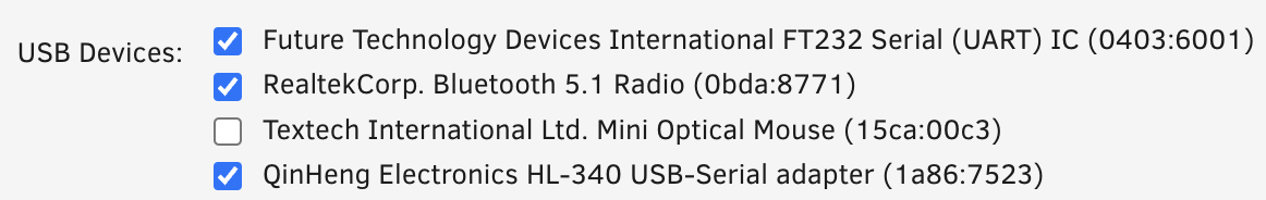

  9. I have three USB devices which I pass through to HOmeassistant in a VM, these have been working well and conneect on boot sucessfully for a long time now, They are all assigned to the VM: Dec 29 10:15:53 Server kernel: usb 1-13: USB disconnect, device number 8 Dec 29 10:15:53 Server kernel: usb 1-13.1: USB disconnect, device number 9 Dec 29 10:15:54 Server kernel: usb 1-13: clear tt 1 (90a2) error -110 Dec 29 10:15:54 Server kernel: usb 1-13.4: USB disconnect, device number 10 Dec 29 10:15:54 Server usb_manager: Info: rc.usb_manager usb_remove /dev/bus/usb/001/010 001 010 Dec 29 10:15:54 Server usb_manager: Info: rc.usb_manager Device Match 001/010 vm: HomeAssistant 001 010 Dec 29 10:15:54 Server usb_manager: Info: rc.usb_manager usb_remove /dev/bus/usb/001/009 001 009 Dec 29 10:15:54 Server kernel: usb 1-13: new high-speed USB device number 11 using xhci_hcd Dec 29 10:15:54 Server usb_manager: Info: virsh called HomeAssistant 001 010 Device detached successfully Dec 29 10:15:54 Server usb_manager: Info: rc.usb_manager Disconnect 001/010 vm: HomeAssistant running 001 010 Dec 29 10:15:54 Server usb_manager: Info: rc.usb_manager Removed 001/010 vm: HomeAssistant running 001 010 Dec 29 10:15:54 Server kernel: hub 1-13:1.0: USB hub found Dec 29 10:15:54 Server kernel: hub 1-13:1.0: 4 ports detected Dec 29 10:15:54 Server usb_manager: Info: rc.usb_manager usb_remove /dev/bus/usb/001/008 001 008 Dec 29 10:15:54 Server usb_manager: Info: rc.usb_manager Device Match 001/008 vm: 001 008 Dec 29 10:15:54 Server usb_manager: Info: rc.usb_manager Removed 001/008 vm: nostate 001 008 Dec 29 10:15:54 Server usb_manager: Info: rc.usb_manager usb_add 1a40_USB_2.0_Hub /dev/bus/usb/001/011 001 011 Dec 29 10:15:54 Server kernel: usb 1-13.1: new full-speed USB device number 12 using xhci_hcd Dec 29 10:15:55 Server kernel: ch341 1-13.1:1.0: ch341-uart converter detected Dec 29 10:15:55 Server kernel: usb 1-13.1: ch341-uart converter now attached to ttyUSB0 Dec 29 10:15:55 Server kernel: usb 1-13.4: new full-speed USB device number 13 using xhci_hcd Dec 29 10:15:55 Server kernel: ftdi_sio 1-13.4:1.0: FTDI USB Serial Device converter detected Dec 29 10:15:55 Server kernel: usb 1-13.4: Detected FT232RL Dec 29 10:15:55 Server kernel: usb 1-13.4: FTDI USB Serial Device converter now attached to ttyUSB1 Dec 29 10:15:55 Server usb_manager: Info: rc.usb_manager Autoconnect No Mapping found 1a40_USB_2.0_Hub /dev/bus/usb/001/011 001 011 port 1-13 Dec 29 10:15:55 Server usb_manager: Info: rc.usb_manager tty_add 1a86_USB_Serial /dev/ttyUSB0 Dec 29 10:15:55 Server usb_manager: Info: rc.usb_manager tty_add SHK_NANO_CUL_868 /dev/ttyUSB1 Dec 29 10:15:55 Server usb_manager: Info: rc.usb_manager Processing tty attach 1a86_USB_Serial /dev/ttyUSB0 Dec 29 10:15:55 Server usb_manager: Info: rc.usb_manager Autoconnect No Mapping found 1a86_USB_Serial /dev/ttyUSB0 port Dec 29 10:15:55 Server usb_manager: Info: rc.usb_manager Processing tty attach SHK_NANO_CUL_868 /dev/ttyUSB1 Dec 29 10:15:55 Server usb_manager: Info: rc.usb_manager Autoconnect No Mapping found SHK_NANO_CUL_868 /dev/ttyUSB1 port Dec 29 10:15:55 Server usb_manager: Info: rc.usb_manager usb_add 1a86_USB_Serial /dev/bus/usb/001/012 001 012 Dec 29 10:15:55 Server usb_manager: Info: rc.usb_manager usb_add SHK_NANO_CUL_868 /dev/bus/usb/001/013 001 013 Dec 29 10:15:56 Server usb_manager: Info: rc.usb_manager Autoconnect Parent 1-13 Dec 29 10:15:56 Server usb_manager: Info: rc.usb_manager Autoconnect No Mapping found 1a86_USB_Serial /dev/bus/usb/001/012 001 012 port 1-13.1 Dec 29 10:15:56 Server usb_manager: Info: rc.usb_manager Autoconnect Parent 1-13 Dec 29 10:15:56 Server usb_manager: Info: rc.usb_manager Autoconnect No Mapping found SHK_NANO_CUL_868 /dev/bus/usb/001/013 001 013 port 1-13.4 Any tips / tricks / hints greatly appreciated.. server-diagnostics-20221230-0909.zip

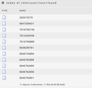

  15. Thank-you. I paused the parity rebuild, and fixed the fs in maint mode. Just restarted and partiy build is continuing on 2nd parity disk. Failed drive still emulated (red cross) but does not show unmountable any more. I have a spare drive so once parity2 is done I'll rebuild to that one..
