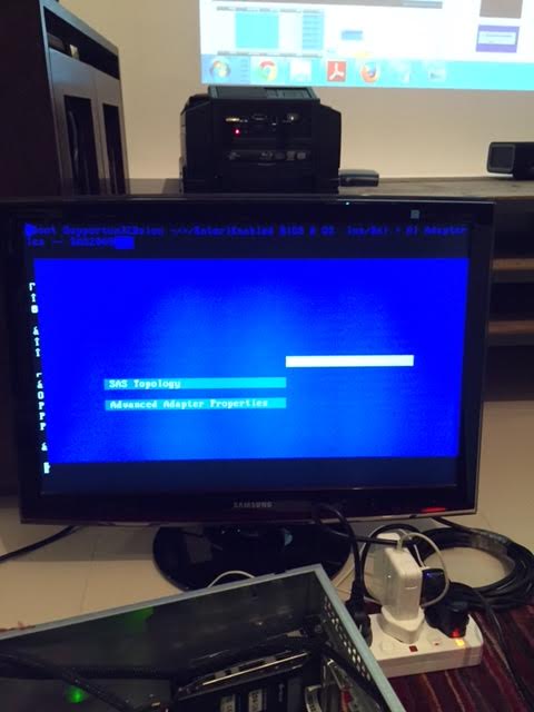

  1. Just an update, I read somewhere that i flash it without the ROM file, and i reflashed my card again without it. Now, I don't get the option for the BIOS of the card when the server boots. But what I did, i connected all the hard drives via the new card and the Intel extender, and my unRAID VM read all the drives as they were before, even the assignment to the slots are correct. Before i put my server into production, i want to be sure that it's ok and nothing is wrong. Update I brought the array up, and all was ok, and i tested spin up and down, and it worked. anything else i should test?
  2. This is another screen (after flashing) that shows the card with the firmware version P19 20mb image hosting

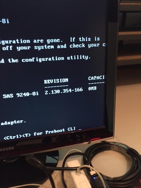

  3. Ok, so i did it, all went good, and attached is my original adapter info i got before flashing. However, now, when i press CNTL-C enter the card settings, i get this weird blue screen (attached) (the black screen attached is the info before flashing the card). the settings page (card BIOS/blue screen) is messed up, and i can't see any settings. i flashed with 9211-8i P19. Right now, only the card is installed, without any HDDs attached. what could be wrong? If so, is there I could go back? ADAPTERS_original.TXT Flashlog1.txt

  5. It's LSI SAS 9240-8i, it's in the original LSI retail box
