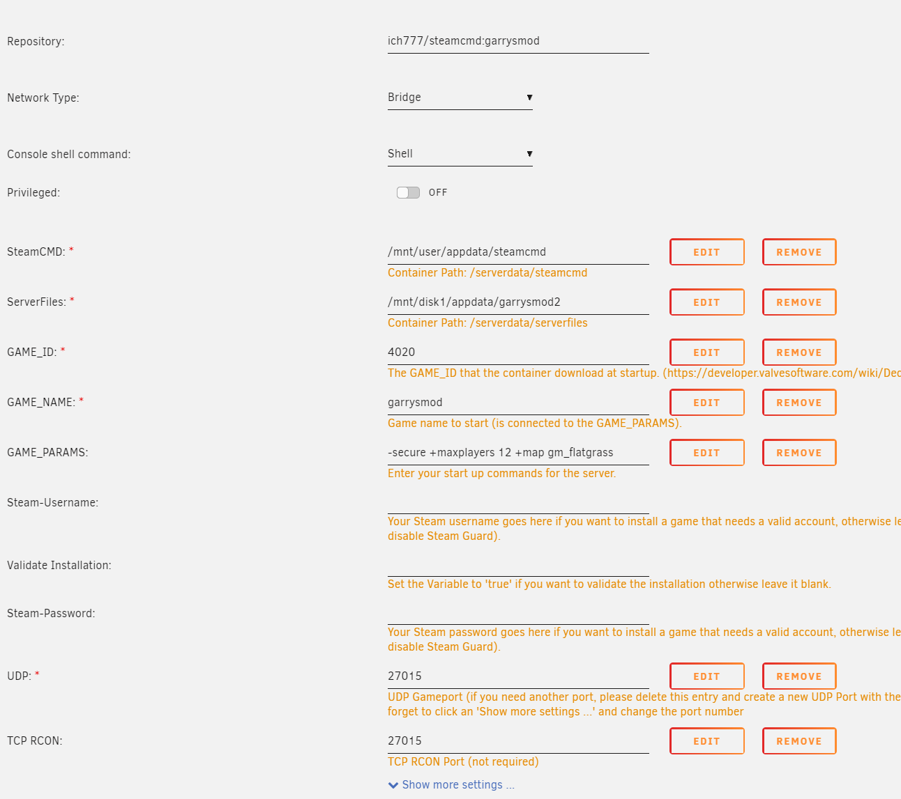

  7. Oh sorry I missed the question about the cache drive. No I don't have a cache drive. Are these the settings you are refereeing to?
  8. I'm running unraid 6.8.3 Didn't change any of the settings. Just left default. One thing I noted is in the error it reference AppID 4000 which is the ID for Garry's Mod rather than 4020 which is the dedicated server AppID. The default setting is still correctly set to 4020. Don't know if this is related or not.
