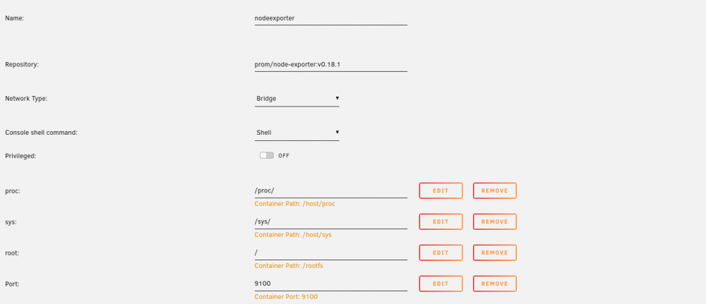

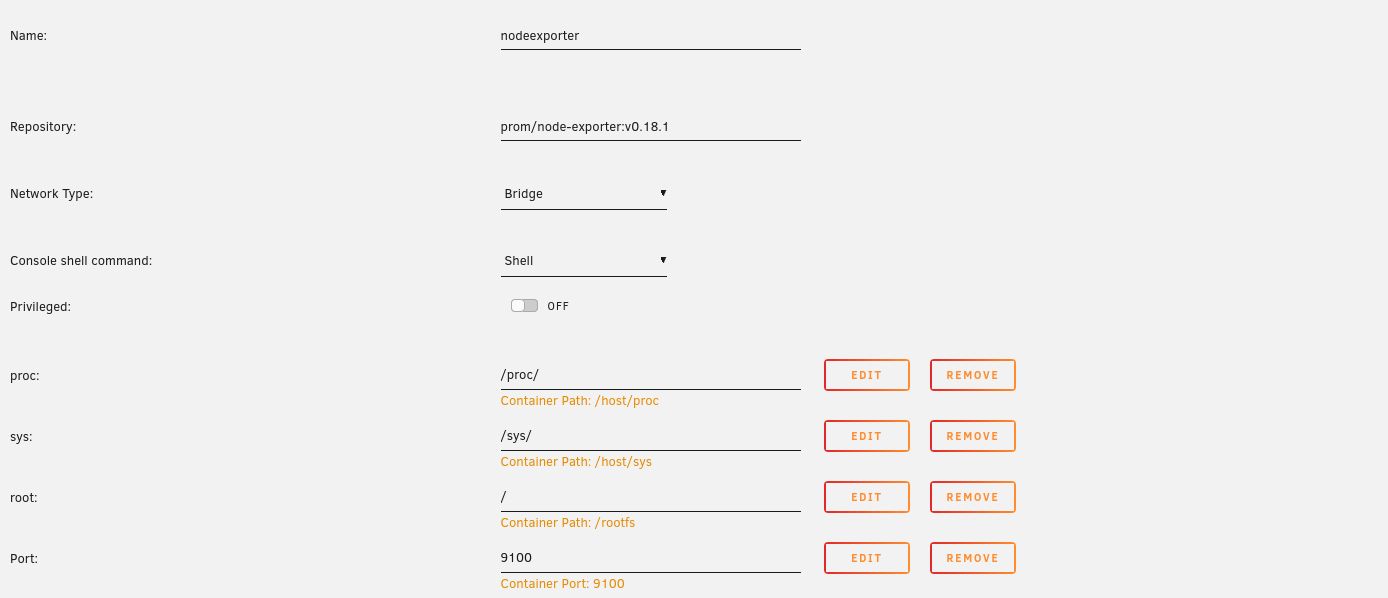

  1. I've been reading the vGPU wiki and the instructions for other linux os don't seem too hard. I'll give it a shot and report back. EDIT: You need a corporate email to sign up
