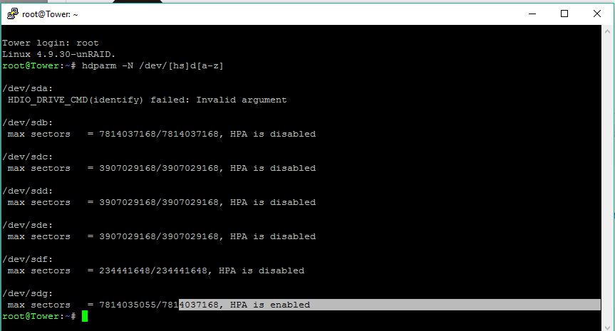

  1. I'm all good the unRaid server is actually a HP MicroServer, the HPA partition was actually created on a separate system (Gigabyte) I was using for preclear operations prior to transition to MicroServer.
  2. Thanks for the help. Parity drive and data drive have been upgraded and array successfully restored. Came down to removing HPA partition and letting array rebuild. At this point the size was corrected to allow inclusion of new data drive.
  3. Heres the results, sdg is parity and sdb is new data drive. Seems sdg is a bit smaller (HPA impact?) I'll swap them around, after another parity synch. But will need to disable HPA on my machine (Gigabyte) prior. Btw: have a great XMAS.

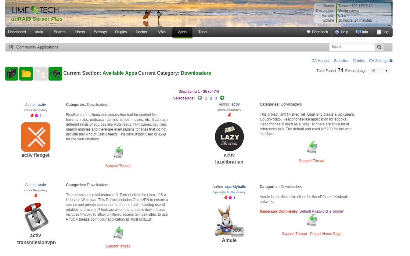

  5. I believe I may of consumed too my 'beverages' last night. I was fixated on seeing the 'Add' button without realizing the install option was ever present. I set "Docker Hub Searching" to yes and thought that enabled that option. Gone back to default settings now. Sorry for the curve ball.
  6. Ok thanks, changed setting to allow for install. thanks for a great product and the support.

  8. Sorry for the Rookie question. But after I inst all Community Applications, there is no "Add/Install" Apps.
