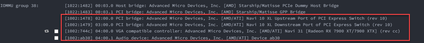

  5. I ive tried SR-IOV and it hasnt helped. Also, I did the ACS downstream and each of the devices ended up in their own iommu but passing through the VGA and Audio device to the win10 VM just got me a black screen on the monitor. I was able to boot to the bare metal on the VM with the 7900xt and it worked flawlessly. The question I have is I keep reading that everyone is passing all 4 devices through but Im only seeing two (23:00.0 & 23:00.1) what is yalls graphics card looking like in the device view? Also, when i try to manually pass through 21:00.0 & 22:00.0 i get a "Non-endpoint cannot be passed through to the guest
  6. When you say that you are "binding all 4 devices to vfio" are you referring to your equivalent of? Also when i map all 4 of the devices to the win10 vm i get the below error here is the portion of my gpu xml <hostdev mode='subsystem' type='pci' managed='yes'> <driver name='vfio'/> <source> <address domain='0x0000' bus='0x04' slot='0x00' function='0x0'/> </source> <rom file='/mnt/user/isos/vbios/RX7900XT-20230331.rom'/> <address type='pci' domain='0x0000' bus='0x04' slot='0x01' function='0x0' multifunction='on'/> </hostdev> <hostdev mode='subsystem' type='pci' managed='yes'> <driver name='vfio'/> <source> <address domain='0x0000' bus='0x04' slot='0x00' function='0x1'/> </source> <address type='pci' domain='0x0000' bus='0x04' slot='0x01' function='0x1'/> </hostdev> <hostdev mode='subsystem' type='pci' managed='yes'> <driver name='vfio'/> <source> <address domain='0x0000' bus='0x02' slot='0x00' function='0x0'/> </source> <address type='pci' domain='0x0000' bus='0x04' slot='0x01' function='0x2'/> </hostdev> <hostdev mode='subsystem' type='pci' managed='yes'> <driver name='vfio'/> <source> <address domain='0x0000' bus='0x03' slot='0x00' function='0x0'/> </source> <address type='pci' domain='0x0000' bus='0x04' slot='0x01' function='0x3'/> </hostdev> also fwiw i am running a xtx 7900xt on a wrx80 creator v2 with a 5955wx as the cpu on Unraid 6.12 rc2

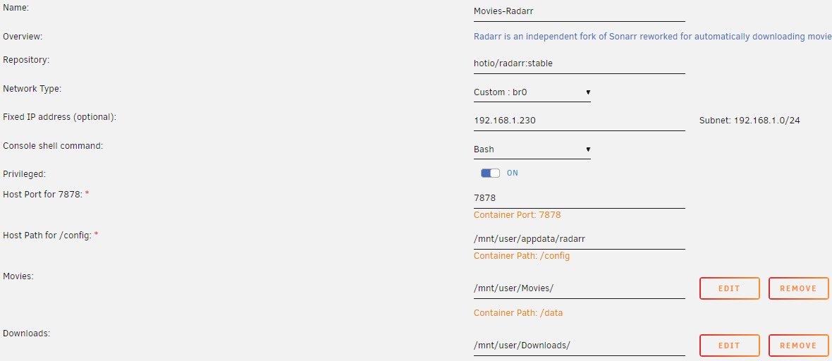

  8. Custom: br0. And, as far as i know the containers arent routed through other containers or proxies. sorry it was 192.168.1.0/24 here is a screen shot of my Radarr docker setting for clarification.
  9. I guess the question would be, is there something done when the docker performs the "[debug] Waiting for iptables chain policies to be in place..." that would cause dockers that are assigned a different IP address (while on the same 192.168.1.0/20 network) to be no longer accessible?
  10. Firstly, thank you for updating the docker and helping keep the community strong. Secondly, would I need to do the same for dockers that are not using the same IP address and not using the VPN?
  11. I was wondering if anyone else had/has the same issue as i am. After installing and running this docker, I can no longer access any of my dockers that dont use bridge network mode which is quite a bit of an issue for my setup and i would like to revert back to my previously working setup. Any help would be greatly appreciated as I am not very familiar with setting up or using IPTables for unraid. Below is the output for iptables -L -v -n Chain INPUT (policy ACCEPT 20812 packets, 5493K bytes) pkts bytes target prot opt in out source destination 28M 18G LIBVIRT_INP all -- * * 0.0.0.0/0 0.0.0.0/0 Chain FORWARD (policy ACCEPT 25238 packets, 17M bytes) pkts bytes target prot opt in out source destination 1888M 2261G LIBVIRT_FWX all -- * * 0.0.0.0/0 0.0.0.0/0 1888M 2261G LIBVIRT_FWI all -- * * 0.0.0.0/0 0.0.0.0/0 1888M 2261G LIBVIRT_FWO all -- * * 0.0.0.0/0 0.0.0.0/0 1888M 2261G DOCKER-USER all -- * * 0.0.0.0/0 0.0.0.0/0 1888M 2261G DOCKER-ISOLATION-STAGE-1 all -- * * 0.0.0.0/0 0.0.0.0/0 1084M 1363G ACCEPT all -- * docker0 0.0.0.0/0 0.0.0.0/0 ctstate RELATED,ESTABLISHED 7700 402K DOCKER all -- * docker0 0.0.0.0/0 0.0.0.0/0 591M 88G ACCEPT all -- docker0 !docker0 0.0.0.0/0 0.0.0.0/0 14 1472 ACCEPT all -- docker0 docker0 0.0.0.0/0 0.0.0.0/0 Chain OUTPUT (policy ACCEPT 18896 packets, 5692K bytes) pkts bytes target prot opt in out source destination 27M 79G LIBVIRT_OUT all -- * * 0.0.0.0/0 0.0.0.0/0 Chain DOCKER (1 references) pkts bytes target prot opt in out source destination 40 2080 ACCEPT tcp -- !docker0 docker0 0.0.0.0/0 172.17.0.2 tcp dpt:8000 364 19136 ACCEPT tcp -- !docker0 docker0 0.0.0.0/0 172.17.0.3 tcp dpt:7878 654 34496 ACCEPT tcp -- !docker0 docker0 0.0.0.0/0 172.17.0.4 tcp dpt:8989 244 12736 ACCEPT tcp -- !docker0 docker0 0.0.0.0/0 172.17.0.5 tcp dpt:6789 0 0 ACCEPT tcp -- !docker0 docker0 0.0.0.0/0 172.17.0.6 tcp dpt:9117 Chain DOCKER-ISOLATION-STAGE-1 (1 references) pkts bytes target prot opt in out source destination 591M 88G DOCKER-ISOLATION-STAGE-2 all -- docker0 !docker0 0.0.0.0/0 0.0.0.0/0 1888M 2261G RETURN all -- * * 0.0.0.0/0 0.0.0.0/0 Chain DOCKER-ISOLATION-STAGE-2 (1 references) pkts bytes target prot opt in out source destination 0 0 DROP all -- * docker0 0.0.0.0/0 0.0.0.0/0 591M 88G RETURN all -- * * 0.0.0.0/0 0.0.0.0/0 Chain DOCKER-USER (1 references) pkts bytes target prot opt in out source destination 1888M 2261G RETURN all -- * * 0.0.0.0/0 0.0.0.0/0 Chain LIBVIRT_FWI (1 references) pkts bytes target prot opt in out source destination 0 0 ACCEPT all -- * virbr0 0.0.0.0/0 192.168.122.0/24 ctstate RELATED,ESTABLISHED 0 0 REJECT all -- * virbr0 0.0.0.0/0 0.0.0.0/0 reject-with icmp-port-unreachable Chain LIBVIRT_FWO (1 references) pkts bytes target prot opt in out source destination 0 0 ACCEPT all -- virbr0 * 192.168.122.0/24 0.0.0.0/0 0 0 REJECT all -- virbr0 * 0.0.0.0/0 0.0.0.0/0 reject-with icmp-port-unreachable Chain LIBVIRT_FWX (1 references) pkts bytes target prot opt in out source destination 0 0 ACCEPT all -- virbr0 virbr0 0.0.0.0/0 0.0.0.0/0 Chain LIBVIRT_INP (1 references) pkts bytes target prot opt in out source destination 0 0 ACCEPT udp -- virbr0 * 0.0.0.0/0 0.0.0.0/0 udp dpt:53 0 0 ACCEPT tcp -- virbr0 * 0.0.0.0/0 0.0.0.0/0 tcp dpt:53 0 0 ACCEPT udp -- virbr0 * 0.0.0.0/0 0.0.0.0/0 udp dpt:67 0 0 ACCEPT tcp -- virbr0 * 0.0.0.0/0 0.0.0.0/0 tcp dpt:67 Chain LIBVIRT_OUT (1 references) pkts bytes target prot opt in out source destination 0 0 ACCEPT udp -- * virbr0 0.0.0.0/0 0.0.0.0/0 udp dpt:53 0 0 ACCEPT tcp -- * virbr0 0.0.0.0/0 0.0.0.0/0 tcp dpt:53 0 0 ACCEPT udp -- * virbr0 0.0.0.0/0 0.0.0.0/0 udp dpt:68 0 0 ACCEPT tcp -- * virbr0 0.0.0.0/0 0.0.0.0/0 tcp dpt:68
