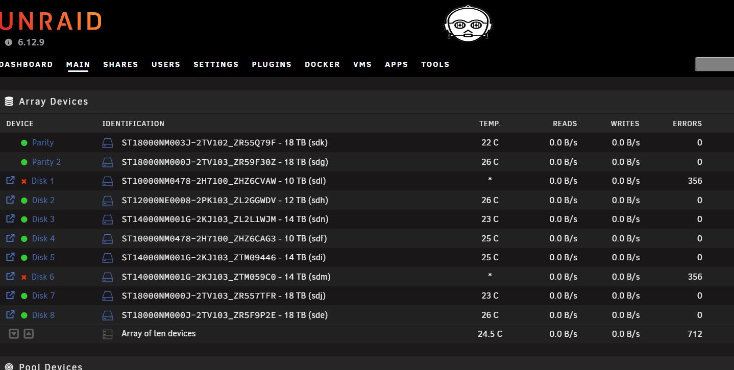

Similar issue on one of my servers that I can't sort out.
Thought it might be an HBA/SAS expander overheating issue, but not seeing anything glaring to that effect in the logs.
Added another fan blowing on both cards to see if that helps (since it helped a different server having the same issue (R2-D2)).
For this server (C-3PO), the same two disks dropped out twice and with the same amount of errors both times, so thinking its also a power issue or HBA/SAS/connections-related and not disks failing but anything is possible.
Any help is much appreciated. Thank you!
Diags and screenshot of disks attached.
