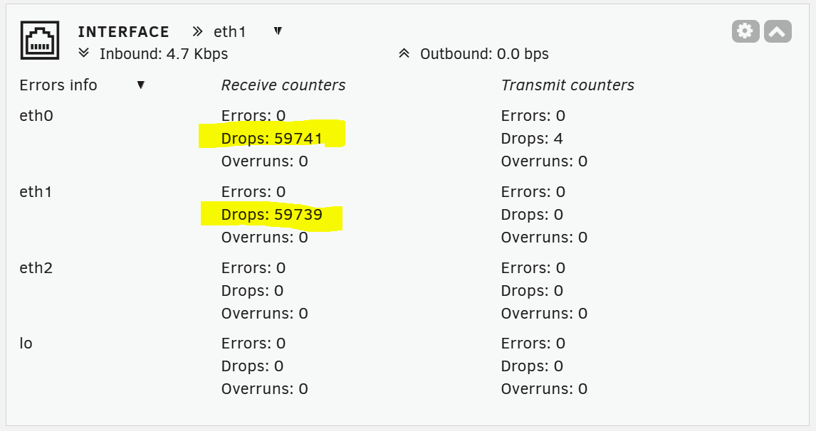

  1. 2 NICs were working before, eth1 was originally passed through to a Vm. Anyways, as suggested, I have unplugged eth1 (so there's only 1 active NIC on the Unraid server - eth0), and the drop count on eth0 is still ticking up.
  2. eth0 and eth1 are connected to the same Ubiquiti router using 2 different cables. Looking at the drop counts, I doubt it's the cable. But where should I begin to investigate further? Like what can I check on the Unraid server?
  3. Hi all, I've been seeing a lots of "Drops" on the network interface and have no clue why. Below is the number of Drops recorded over 20 days (Unraid running time). The only problem I've experienced is that the torrent client in a VM often has error reading from the disk (Unassigned Device) containing the torrent file. Both eth0 and eth1 connect directly to an Ubiquity router. The sheer number of drops is a little troubling... Any leads to resolves this? Hardware wise, I'm running the N355 board which has 3 ethernet ports. eth0 and eth1 settings below. I can attach diagnostics if needed.

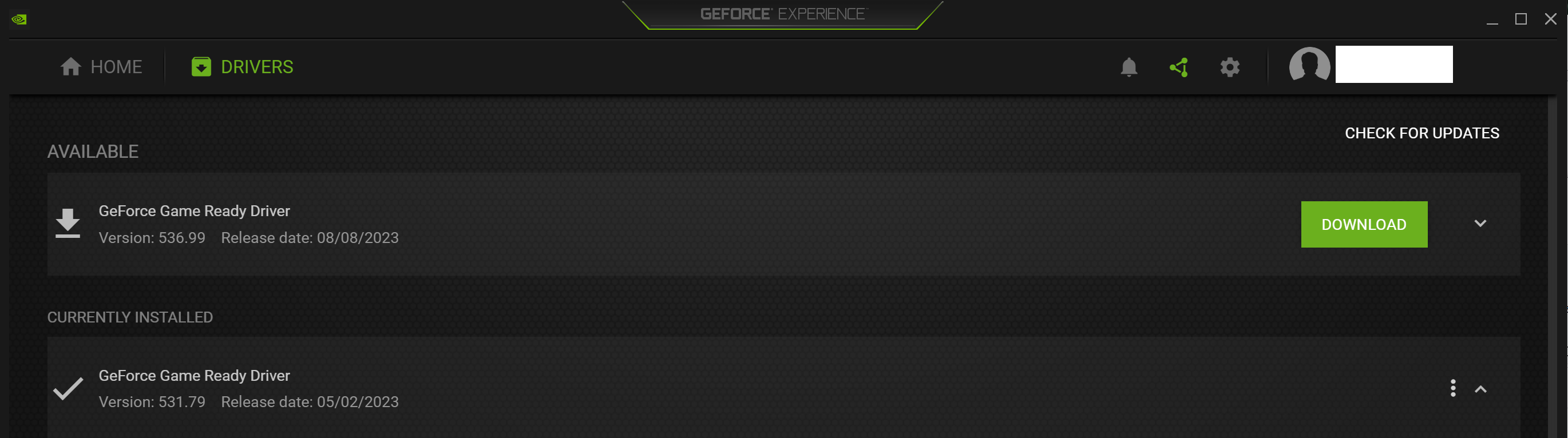

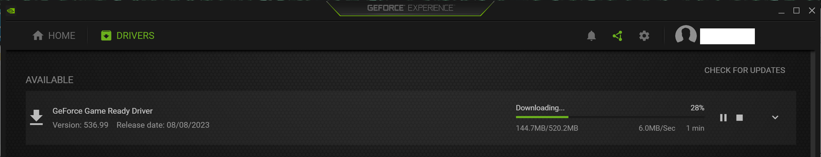

  6. Hi all, I have a Gigabyte Gefore RTX3060 passed through to a win10 VM. It runs fine, no known performance issues. Since I installed the card, I've been unable to update the driver using the accompanying GeForce Experience software. I've attached a few screenshots below. It sees that new update is available (GPU1.png), and downloads it (GPU2.png), but nothing happens after download is complete. No error message, no install, nothing after restart, just nothing. So basically after the entire exercise it goes back to looking like GPU1.png. Is there any specific steps I need to follow to update the GPU driver?

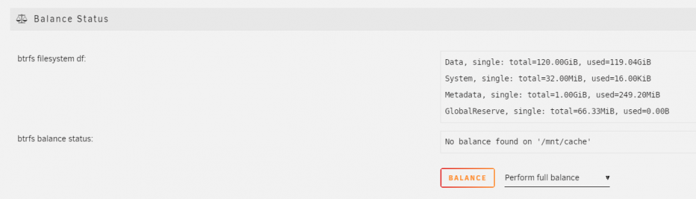

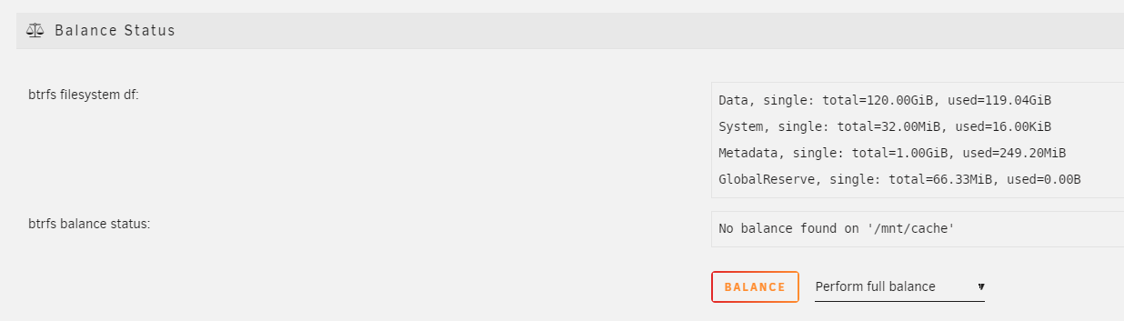

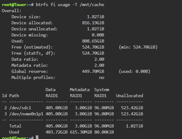

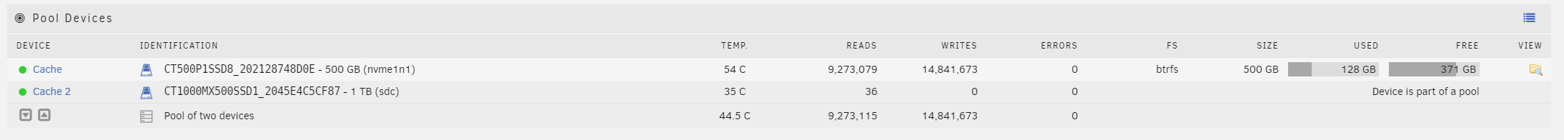

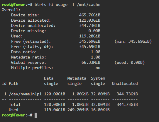

  13. Thx for getting back to me Jorge, I suspected it was an issue with the cache pool, something is still bugging out. So I ended up taking the long way around. 1. transferred all the cache data back to the array (for peace of mind as well) 2. deleted the cache pool 3. rebooted the server 4. recreated the cache pool (at some point I needed to use the "btrfs-select-super -s 1 /dev/nvme1n1p1" command again, because the system was preventing me from mounting the drive as an unassigned device) 5. now I think everything is in working order, the mover is still moving data from the array back onto the new cache pool. So just to confirm, this means the cache pool is working in RAID1 config right? Does the ID number matter as to which drive data will be read/written from/to? because 1 is SATA and 1 is NVMe.
  14. Hi Jorge, something is not right. I'm only at step 1, but dont think the device was correctly added to the pool (for reasons unknown to me). It says the 1TB sata ssd is "part of a pool". I tried to do "balance" in the GUI of Cache (nvme1n1), twice, each time completed without complaint. FYI it would not allow me to "convert to raid1 mode" here. Afterwards, using "btrfs fi usage -T /mnt/cache" I get this, doesn't even look like the device is in the pool... Tried to run "btrfs balance start -mconvert=raid1 /mnt/cache" posted on the other thread, and got error syslog says Dec 30 11:48:38 Tower kernel: BTRFS error (device nvme1n1p1): balance: invalid convert metadata profile raid1 P.S. I tried stopping the array and adding the 2nd cache device twice, same issues. syslog and new diagnostics attached. syslog.txt tower-diagnostics-20211230-1151.zip
