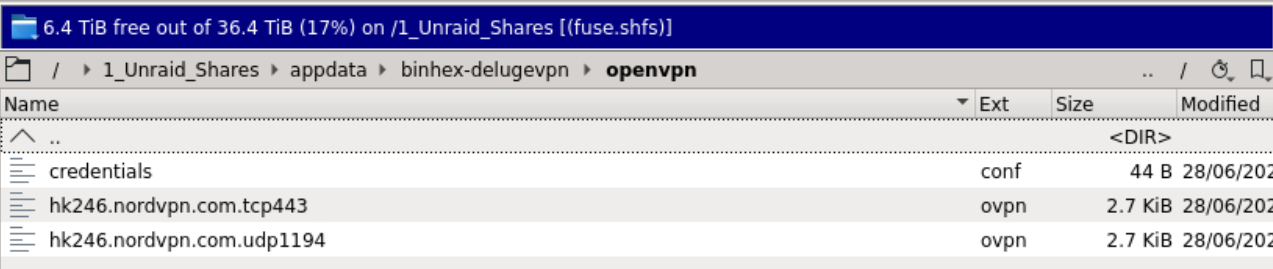

  2. Bro, you are genius, the /config is different. Don't know what did I do, but somehow, the /config in container change to /mnt/user/appdata/binhex-deluge (not delugevpn). That's why it can not find the opvn files. Change it to correct path, the container is running. Only problem the data is not the up-to-date as I remembered. I need to restore it from my backup. Thank you very much Binhex.
  3. Here is the screenshot:
  4. in /config/openvpn there are 3 files: 2 opvn files download from NordVPN website (1 with tcp443 and 1 with udp1194 in their name) + 1 credentials.conf with account and pass from NordVPN. They have been in this folder for couple months and running without any problem. I even downloaded a new 2 opvn files and replace the old ones, but it still show logs like that.
