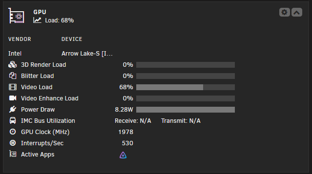

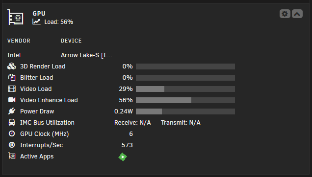

  7. I have my Ultra 7 265K iGPU working with the Unraid 7 release with a custom kernel 6.12.9. I assume this would work with the Arc GPUs as well. It transcodes with my Jellyfin docker on stable, but need the beta version of Emby. I used this guide https://gitlab.com/stefan99353/unraid-custom-kernel/-/blob/main/README.md but used kernel 6.12.9 and Unraid 7 release. It took a bit to get everything to compile, but it all seems to be working. If anyone wants the updated files to try let me know. NO WARRANTY or promises of course and I believe you can't use it if you use ZFS. Now that it's compiled it's pretty easy to try, just drop the files on your boot USB drive replacing what's there and boot up. Save the original files first and you can revert back if there's an issue.
  8. I have my Ultra 7 265K iGPU working with the Unraid 7 release with a custom kernel 6.12.9. It transcodes with my Jellyfin docker on stable, but need the beta version of Emby. I used this guide https://gitlab.com/stefan99353/unraid-custom-kernel/-/blob/main/README.md but used kernel 6.12.9 and Unraid 7 release. It took a bit to get everything to compile, but it all seems to be working. If anyone wants the updated files to try let me know. NO WARRANTY or promises of course and I believe you can't use it if you use ZFS. Now that it's compiled it's pretty easy to try, just drop the files on your boot USB drive replacing what's there and boot up. Save the original files first and you can revert back if there's an issue.

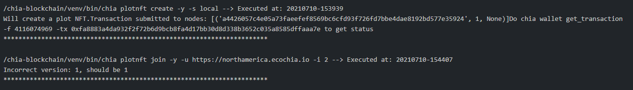

  10. Yup my wallet is like yours on the self pool. Still fails to join the real pool, even after hours. Either there's something wrong with the plotnft command (it has a slightly different set of arguments than the self pool), or is it possible the url isn't working correctly right now? Either way I'll just keep self mining until I figure this out. I'm generally pretty tech literate, but this Chia is streaching my knowledge a bit.
  11. Interesting, a self pool created fine. A real pool still fails.

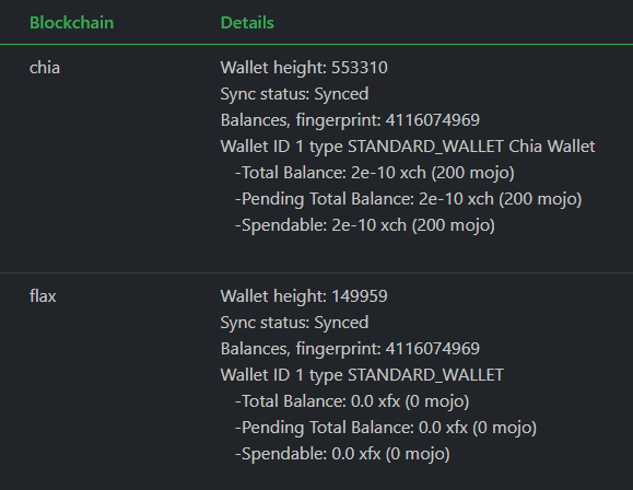

  12. Thanks for the reply. I have 2 Wallet IDs since the Machinaris update, one says chia, the other flax. The both say Wallet ID 1, is this an issue?
  13. Can anyone explain this to me when trying to join a pool? chia plotnft - log output /chia-blockchain/venv/bin/chia plotnft create -y -u https://northamerica.ecochia.io -s pool --> Executed at: 20210710-093810 Exception from 'wallet' Incorrect version: 1, should be 1 **********************************************************************

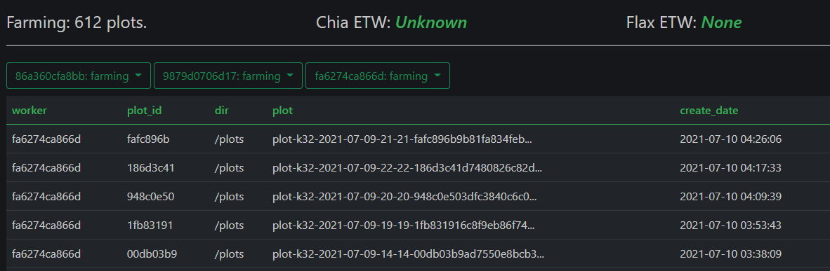

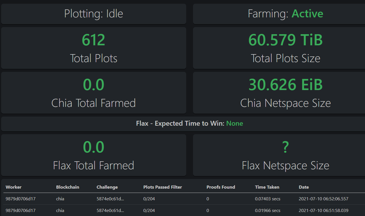

  14. Edit: nevermind I found it under workers tab and pruned the unresponsive workers. After the update I'm showing 3 farmers and 3x the plots. Any ideas on this? 2 of the farmer logs appear empty.
