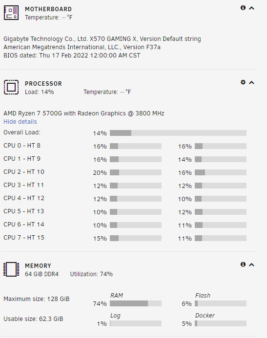

  1. I never ran any VMs when I was using the B450, I also had a Ryzen 3600 in there. I've only had the 5700G for a short while, bought it 2022-04-18. The X570 board I've had for a long time, I got that when the 2nd gen Ryzen first came out, had a 2700x in it, then 5800x, now this 5700g (which surprisingly didn't post even tho 5800x worked fine).

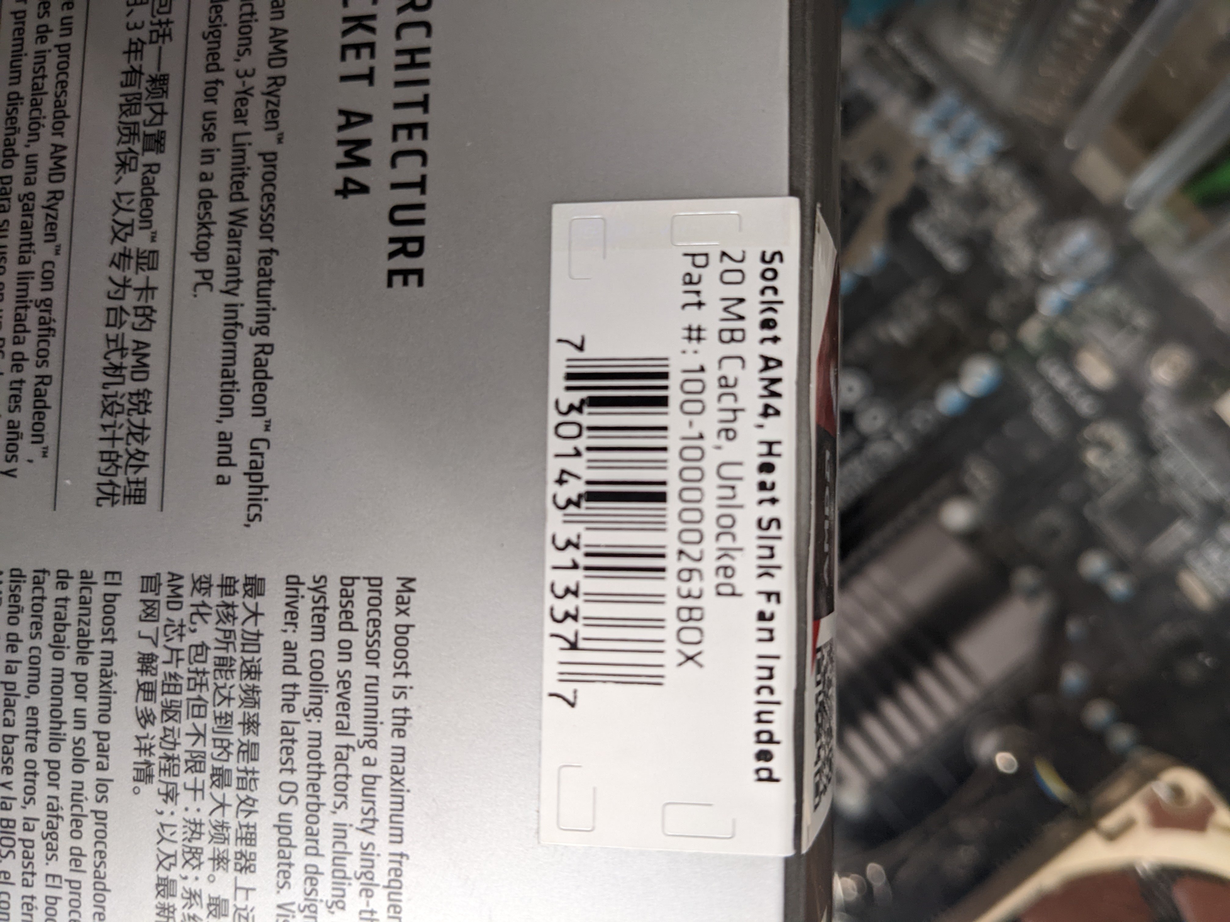

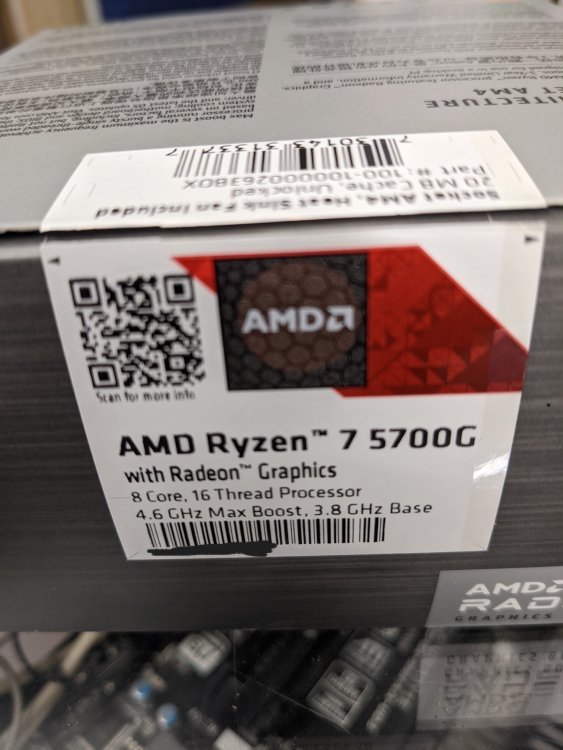

  2. I bought a retail box 5700G from microcenter. I was actually using a ASROCK B450M PRO4 as well before this, I also tested a X399 TR 2920 combo.

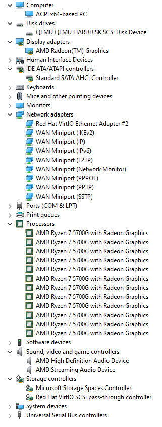

  7. I ran into an interesting problem that I cannot seem to figure out. I passed the AMD audio device, but I cannot get it to pass audio out through HDMI. This works when its setup bare metal with Windows. I see the device, I passed it, shows up in device manager, but says disconnected when you look at it.

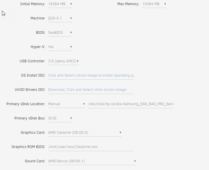

  12. I was able to get my 5700G to pass through, I'm on a Gigabyte X570 Gaming X I did have to use SeaBios and Q35, along with the bios posted above: Here are the IOMMU groups my machine posted with: IOMMU group 0: [1022:1632] 00:01.0 Host bridge: Advanced Micro Devices, Inc. [AMD] Renoir PCIe Dummy Host Bridge IOMMU group 1: [1022:1633] 00:01.1 PCI bridge: Advanced Micro Devices, Inc. [AMD] Renoir PCIe GPP Bridge IOMMU group 2: [1022:1634] 00:01.2 PCI bridge: Advanced Micro Devices, Inc. [AMD] Renoir PCIe GPP Bridge IOMMU group 3: [1022:1632] 00:02.0 Host bridge: Advanced Micro Devices, Inc. [AMD] Renoir PCIe Dummy Host Bridge IOMMU group 4: [1022:1632] 00:08.0 Host bridge: Advanced Micro Devices, Inc. [AMD] Renoir PCIe Dummy Host Bridge IOMMU group 5: [1022:1635] 00:08.1 PCI bridge: Advanced Micro Devices, Inc. [AMD] Renoir Internal PCIe GPP Bridge to Bus IOMMU group 6: [1022:1635] 00:08.2 PCI bridge: Advanced Micro Devices, Inc. [AMD] Renoir Internal PCIe GPP Bridge to Bus IOMMU group 7: [1022:790b] 00:14.0 SMBus: Advanced Micro Devices, Inc. [AMD] FCH SMBus Controller (rev 51) [1022:790e] 00:14.3 ISA bridge: Advanced Micro Devices, Inc. [AMD] FCH LPC Bridge (rev 51) IOMMU group 8: [1022:166a] 00:18.0 Host bridge: Advanced Micro Devices, Inc. [AMD] Device 166a [1022:166b] 00:18.1 Host bridge: Advanced Micro Devices, Inc. [AMD] Device 166b [1022:166c] 00:18.2 Host bridge: Advanced Micro Devices, Inc. [AMD] Device 166c [1022:166d] 00:18.3 Host bridge: Advanced Micro Devices, Inc. [AMD] Device 166d [1022:166e] 00:18.4 Host bridge: Advanced Micro Devices, Inc. [AMD] Device 166e [1022:166f] 00:18.5 Host bridge: Advanced Micro Devices, Inc. [AMD] Device 166f [1022:1670] 00:18.6 Host bridge: Advanced Micro Devices, Inc. [AMD] Device 1670 [1022:1671] 00:18.7 Host bridge: Advanced Micro Devices, Inc. [AMD] Device 1671 IOMMU group 9: [10de:10c3] 01:00.0 VGA compatible controller: NVIDIA Corporation GT218 [GeForce 8400 GS Rev. 3] (rev a2) [10de:0be3] 01:00.1 Audio device: NVIDIA Corporation High Definition Audio Controller (rev a1) IOMMU group 10: [1022:57ad] 02:00.0 PCI bridge: Advanced Micro Devices, Inc. [AMD] Matisse Switch Upstream IOMMU group 11: [1022:57a3] 03:04.0 PCI bridge: Advanced Micro Devices, Inc. [AMD] Matisse PCIe GPP Bridge IOMMU group 12: [1022:57a4] 03:08.0 PCI bridge: Advanced Micro Devices, Inc. [AMD] Matisse PCIe GPP Bridge [1022:1485] 05:00.0 Non-Essential Instrumentation [1300]: Advanced Micro Devices, Inc. [AMD] Starship/Matisse Reserved SPP [1022:149c] 05:00.1 USB controller: Advanced Micro Devices, Inc. [AMD] Matisse USB 3.0 Host Controller Bus 001 Device 001: ID 1d6b:0002 Linux Foundation 2.0 root hub Bus 001 Device 004: ID 1c4f:0002 SiGma Micro Keyboard TRACER Gamma Ivory Bus 001 Device 005: ID 04f2:0939 Chicony Electronics Co., Ltd USB Optical Mouse Bus 002 Device 001: ID 1d6b:0003 Linux Foundation 3.0 root hub [1022:149c] 05:00.3 USB controller: Advanced Micro Devices, Inc. [AMD] Matisse USB 3.0 Host Controller Bus 003 Device 001: ID 1d6b:0002 Linux Foundation 2.0 root hub Bus 003 Device 002: ID 048d:8297 Integrated Technology Express, Inc. ITE Device(8595) Bus 004 Device 001: ID 1d6b:0003 Linux Foundation 3.0 root hub IOMMU group 13: [1022:57a4] 03:09.0 PCI bridge: Advanced Micro Devices, Inc. [AMD] Matisse PCIe GPP Bridge [1022:7901] 06:00.0 SATA controller: Advanced Micro Devices, Inc. [AMD] FCH SATA Controller [AHCI mode] (rev 51) IOMMU group 14: [1022:57a4] 03:0a.0 PCI bridge: Advanced Micro Devices, Inc. [AMD] Matisse PCIe GPP Bridge [1022:7901] 07:00.0 SATA controller: Advanced Micro Devices, Inc. [AMD] FCH SATA Controller [AHCI mode] (rev 51) [5:0:0:0] disk ATA Samsung SSD 840 5B0Q /dev/sdb 128GB [9:0:0:0] disk ATA ST18000NM000J-2T SN02 /dev/sdc 18.0TB [10:0:0:0] disk ATA ST18000NM000J-2T SN02 /dev/sdd 18.0TB IOMMU group 15: [10ec:8168] 04:00.0 Ethernet controller: Realtek Semiconductor Co., Ltd. RTL8111/8168/8411 PCI Express Gigabit Ethernet Controller (rev 16) IOMMU group 16: [1002:1638] 08:00.0 VGA compatible controller: Advanced Micro Devices, Inc. [AMD/ATI] Cezanne (rev c8) IOMMU group 17: [1002:1637] 08:00.1 Audio device: Advanced Micro Devices, Inc. [AMD/ATI] Device 1637 IOMMU group 18: [1022:15df] 08:00.2 Encryption controller: Advanced Micro Devices, Inc. [AMD] Family 17h (Models 10h-1fh) Platform Security Processor IOMMU group 19: [1022:1639] 08:00.3 USB controller: Advanced Micro Devices, Inc. [AMD] Renoir USB 3.1 This controller is bound to vfio, connected USB devices are not visible. IOMMU group 20: [1022:1639] 08:00.4 USB controller: Advanced Micro Devices, Inc. [AMD] Renoir USB 3.1 Bus 007 Device 001: ID 1d6b:0002 Linux Foundation 2.0 root hub Bus 008 Device 001: ID 1d6b:0003 Linux Foundation 3.0 root hub Bus 008 Device 002: ID 090c:1000 Silicon Motion, Inc. - Taiwan (formerly Feiya Technology Corp.) Flash Drive IOMMU group 21: [1022:15e3] 08:00.6 Audio device: Advanced Micro Devices, Inc. [AMD] Family 17h (Models 10h-1fh) HD Audio Controller IOMMU group 22: [1022:7901] 09:00.0 SATA controller: Advanced Micro Devices, Inc. [AMD] FCH SATA Controller [AHCI mode] (rev 81) IOMMU group 23: [1022:7901] 09:00.1 SATA controller: Advanced Micro Devices, Inc. [AMD] FCH SATA Controller [AHCI mode] (rev 81) You can see the APU and Audio device are in their own groups 16/17: IOMMU group 16: [1002:1638] 08:00.0 VGA compatible controller: Advanced Micro Devices, Inc. [AMD/ATI] Cezanne (rev c8) IOMMU group 17: [1002:1637] 08:00.1 Audio device: Advanced Micro Devices, Inc. [AMD/ATI] Device 1637 I also passed one set of USB 3.1 ports so I can plug whatever I need into those two and get them in the VM. I did have to setup the BIOS to force APU on, as well as set the GPU initialization to use the card in slot 1 instead of built in. My long term setup will be to use an old 1050ti for unraid, pass that to Plex, and use the APU to run a Windows 10 VM. It appears to be working so far, make sure you install the correct drives from AMD though, as I got the wrong set the first time I was clicking too fast.
