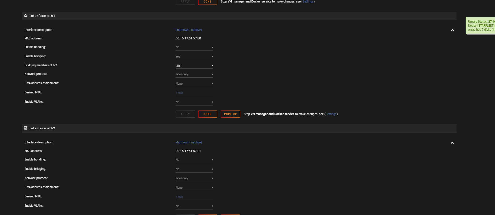

  1. Good call on that, i noticed Eth1 had bridging enabled,. I was able to pass through both devices now. Its now working!
  2. I forgot to mention. I have 3 nics. Unraid is plugged into the build in Nic. These nics aren't being used for anything. I do see it show up in the unraid network setting so it is being detected.

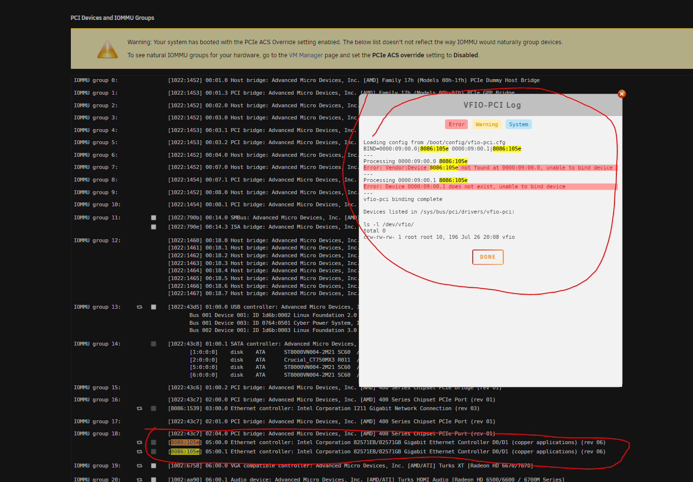

  3. If i set the ACS to both i can passthrough the one nic from the dual gigabit nic. I am not sure why its not letting select both
  4. Hi, i installed dual nic card in my board both nics are online and working. When i try to add it the passthrough device under system devices the checkbox is greyed out. Any ideas why? there is a error in the log. Sounds like it can;'t load the card into the system I am running unraid version 6.9.2 and i believe i had this working in the old version by manually editing the file but i think i removed those entries since it was no longer needed.
