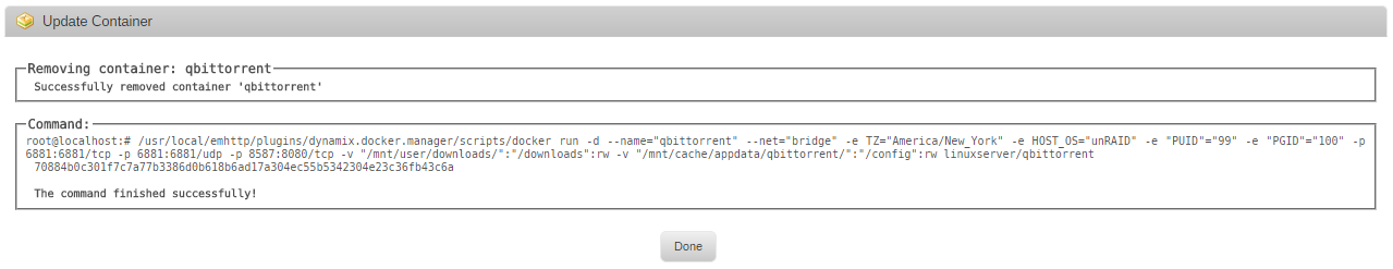

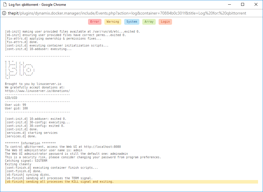

When I open the webUI - all I get is a blank page, with literally nothing on it. :S
Edited by shEiD
@Squid thanks for reminding me, added the screens.
I was getting the blank page as well. It looks like this container doesn't like having the default webui port changed. Setting the host port 3 parameter to anything other than 8080 produces the white page.
@impalerware thanks. Changing back the port to 8080 worked.
Although 8080 is quite popular port among the containers, isn't it? Hope nothing else will that hell-bent on keeping 8080 :)
Another weird thing - even after changin back to 8080 the webUI works only in Firefox and only in Chrome Incognito mode. It still gives me a blank page in regular Chrome.
