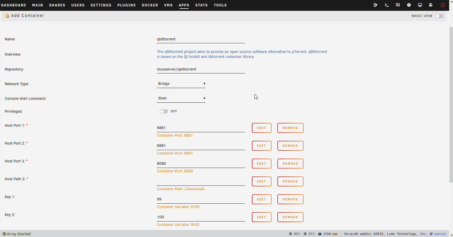

Is there a version of a qbittorrent Docker that can be set up to work on a port other than 8080? This linuxserver one can't be.
You can map any host port you want to the container port 8080
That isn't a very helpful answer, because I have already proven that no, I can't.
I would be happy to correct this lack of ability on my part, by following explicit instructions on how to do it (that I hope you can link to). But as it stands, I've tried a whole bunch of things, and I still can't get this Docker up and running with a web UI using my preferred port.
I thought Docker was supposed to be nice and straightforward, insulating the user from all the back-end fiddling and CLI junk that's normally required (especially with Linux stuff)? I have never had as much trouble with any of the maybe 20 Dockers I have running as I'm having with this one.
Edited by Karyudo

Did you create a new mapped port for the container?
Edited by j0nnymoe

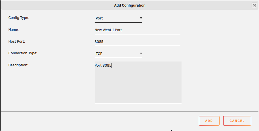

No, of course not, because that's not a step I've seen shown explicitly in any previous guide or discussion of this problem.
I've tried it now, though, and it fails (probably because of some earlier poorly-described step that I did wrong):
root@localhost:# /usr/local/emhttp/plugins/dynamix.docker.manager/scripts/docker run -d --name='qbittorrent'
--net='bridge' -e TZ="America/Los_Angeles" -e HOST_OS="Unraid" -e 'PUID'='99' -e 'PGID'='100'
-p '6881:6881/tcp' -p '6881:6881/udp' -p '8085:8080/tcp' -p '8085:8085/tcp'
-v '/mnt/disks/DB6/unRAID_UD_downloads/qbittorrent/':'/downloads':'rw'
-v '/mnt/user/appdata/qbittorrent':'/config':'rw' 'linuxserver/qbittorrent'
cd5d04a2420ae4a68c26b83d50fd9d3ac39b23caa82c879cc5144fb1fc6597c5
/usr/bin/docker: Error response from daemon: driver failed programming external connectivity on endpoint
qbittorrent (ef12dd65bbde9e5a1dc61f1c98602c7d09dfaad4685f0410fc90fe25158f0bce):
Bind for 0.0.0.0:8085 failed: port is already allocated.
I don't suppose there's a comprehensive 'how-to' document somewhere, is there?

There is no need to read a comprehensive guide on how to change the port it's using.
Please delete the container, image and the appdata for this container and start fresh. Then when you are in the template, set Host Port 3 to 8085 and the webgui will be at unraidIP:8085.
There is no reason to alter anything inside the container. In the above example, you managed to use port 8085 for two port mappings and therefor getting the error message you get.
There is nothing wrong with this container.

Delete the container, image, and appdata: check.
In template, set Host Port 3 to 8086 (I even changed this from 8085, to make sure I wasn't accidentally picking up any remnants of sins of the past): check.
WebGUI is at 192.168.1.201:8086... fail: I still get "This site can’t be reached."
-p '6881:6881/tcp' -p '6881:6881/udp' -p '8086:8080/tcp'
56855b8f2aa27525bcf010fe64f8b93bdf82127932c9dd8e8bed2b960da707db
I also tried this with --net='proxynet', which is how SABnzbd is set up (that's the Docker already using 8080, btw)... also fail.
Just for fun, I stopped SABnzbd, and used port 8080 for qbittorrent. Got the same error when starting the web GUI.
BUT! Then I actually typed in 'http://192.168.1.201:8080' and THAT WORKED. (What?! WHY???)
Edited the Docker back to 8086, tried the same "trick" and... fail.
I. don't. get it.

Again as per the readme, it states `need to change both sides` aka the container port and host port to match and you haven't done this.
tl;dr: Success!
The video clip was very helpful—thanks for taking the time to make it. [Also: nice way to confirm my suspicions that the previous "there is no reason to alter anything inside the container" poster didn't really know how to solve the problem, either. ]
To summarize the steps covered by the video clip that I duplicated in my own installation:
1. Remove Key 3.
2. Add another Port:
Container Port: 8086 (or whatever port the user chooses)
Host Port: 8086 (same as above)
3. Add another Variable:
Key: WEBUI_PORT
Value: 8086 (or whatever the choice was in Step 2)
Turns out I had added both a Variable and a Port at one point or another—but never at the same time (and I still may not have done either addition correctly).
