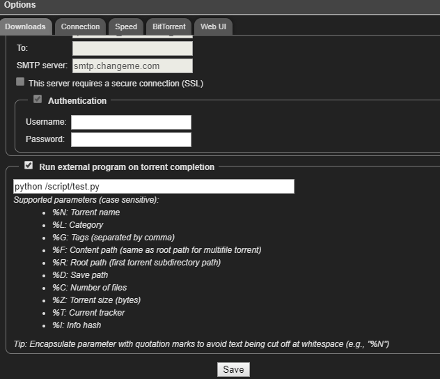

How do you get this to work?
Python or Bash. Don't care. /script/ is a path mapped into the docker for qbittorrent.

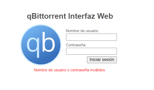

Since the last update I can not access, it gives me the wrong username or password.
I have tried to access as always from several browsers (Edge, Chrome, Firefox, IE...) with the same result.
It also does not allow me to access from the client that I have installed on Android.

I also had this problem and just fixed it.
Looks like the new update pushed qBittorrent 4.2.0, which uses a different password hashing process.
You can reset to the default account (admin:adminadmin) by editing the config file at ~/appdata/qbittorrent/qBittorrent/qBittorrent.conf
Delete the lines near the end starting with WebUI\Username and WebUI\Password_ha1
After you log in with the default and set a new username and password, the WebUI\Password_ha1 line becomes WebUI\Password_PBKDF2

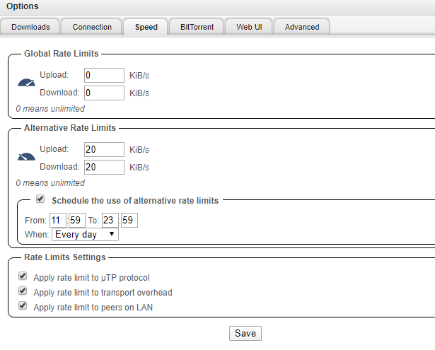

I'm new to qBT on unraid, but moved from a Windows machine.
I can schedule whatever I want in the Alternative Rate Limits window, but it seems the schedule doesn't actually trigger.
If I click the speedometer at the bottom of the page, the new speed limits do correctly apply.
Any thought as to why or how to fix this?
