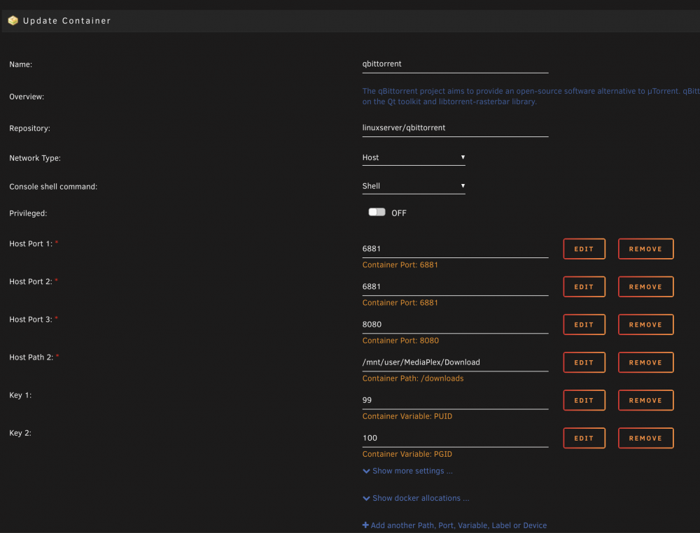

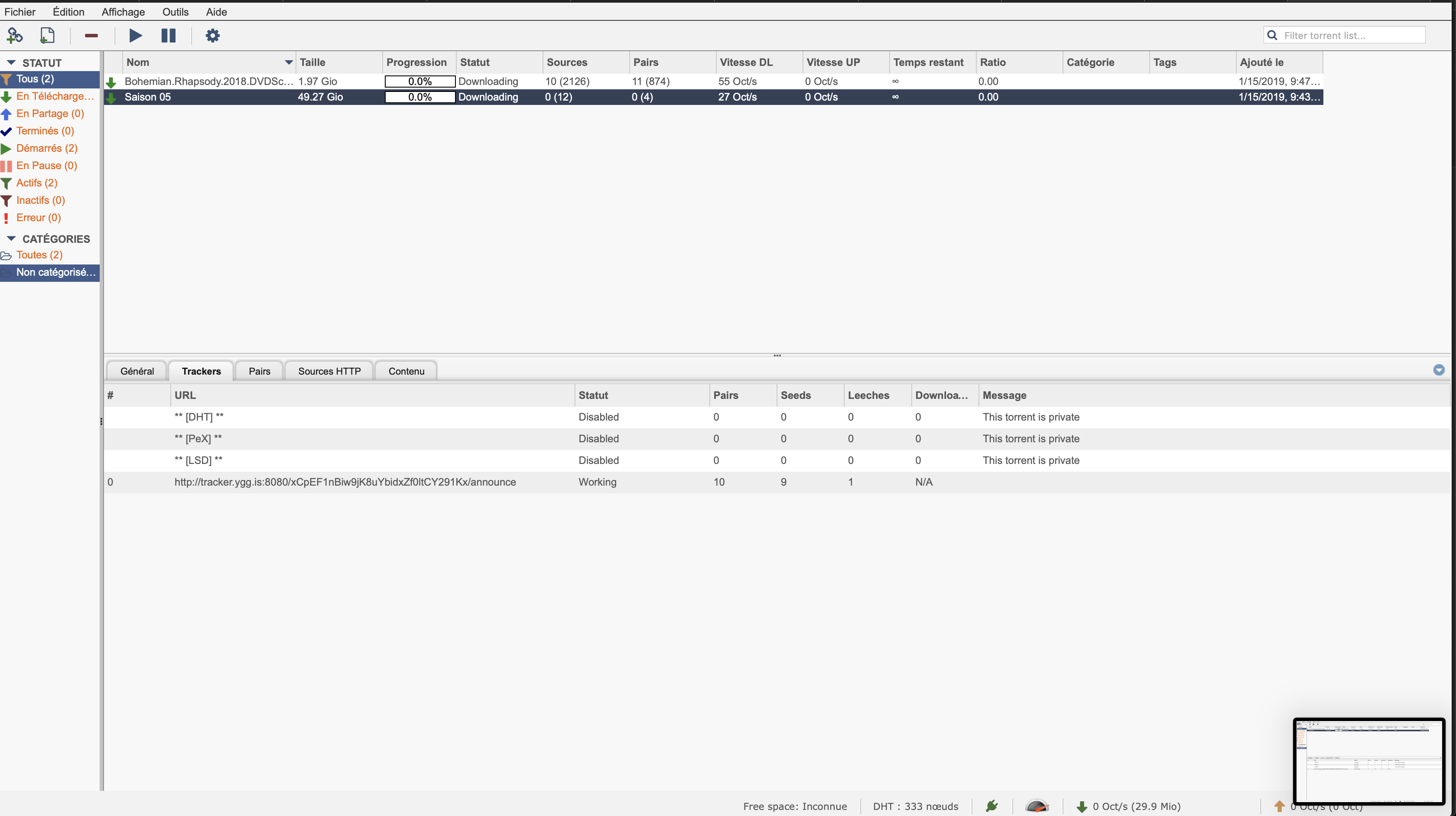

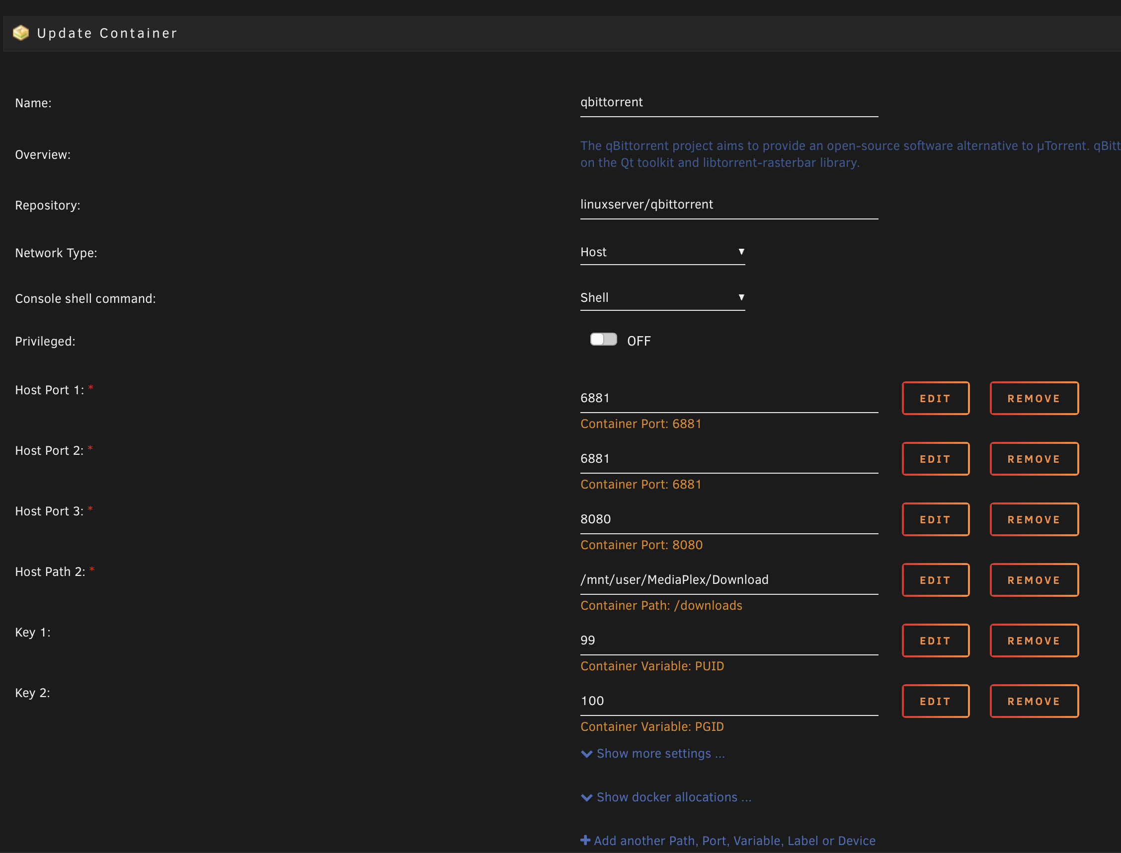

Hi everybody !
I m a noob at Unraid, I just created a new server, and I try to DL torrent file, but it s doesn't  work...
I tried with Deluge, Transmission and now with Qbittorrent.
I setup my routeur with the good forwarding port, I setup the DL folder ....
when I put a torrent files ( public or private tracker ) the files start to DL but few second after the speed drop down ! The sources are good, the trackers are working. If I put pause and resume, the torrent start to DL then stop again...
I feel it s a kind of writing issue maybe ?
If someone have any idea... :)
Thanks !!!!
Cheers
