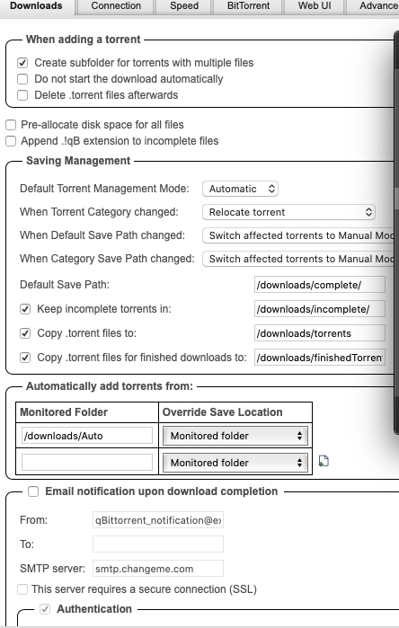

Hi All, I'm having a new problem for the last month or so.
Nothing on my setup changed, I'm running latest versions of everything.
Qbittorrent all of a sudden started to move completed torrents into my "Auto" folder i.e. the folder that is bein autowatched for new torrents.
Normally the download is moved when completed to a folder called "completed" and the torrent is moved to "finished torrents"
The relevant paths are still assigned correctly within settings, and if i manually "set download location" to the "completed" directory by right clicking the torrent it moves to the correct place on completion.

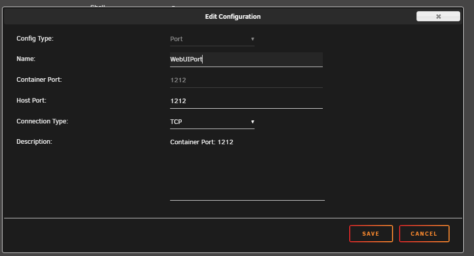

I can't use port 8080 because of my Ubiquiti controller.
So im using port 1212 but all i get is connection refused. I wonder if the docker command from the app is hardcoded to use 8080. Anyone else has this issue?
not sure why qbitorrent would use 8080 its fairly dumb as a lot web proxy uses 8080 by default.
I fixed it, I added the WEBUI_PORT in docker config.
This should  be  an option when creating it.
image.thumb.png.3e13c9536473b6550dc8a2f6b6619b32.pngU

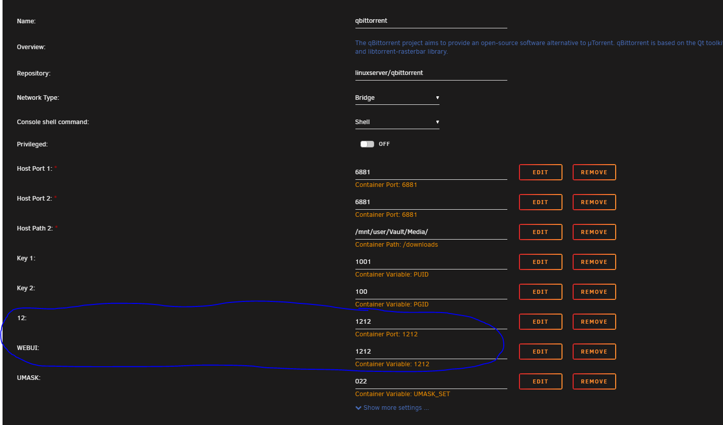

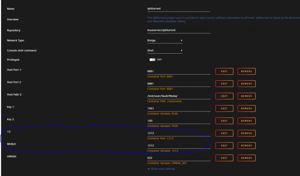

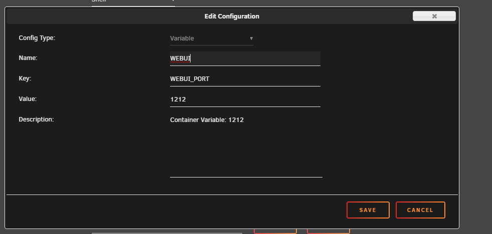

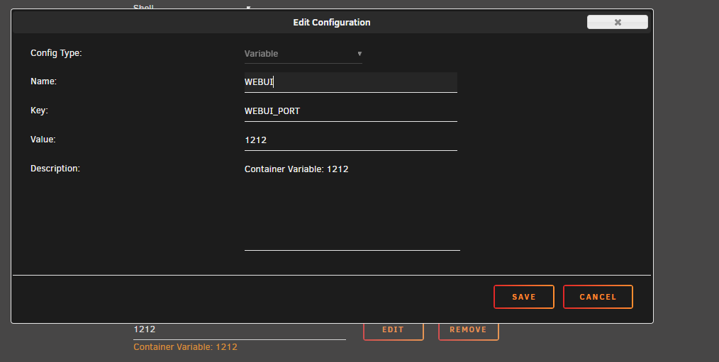

I tried to do exactly. I've gone to the support page. I've read and read. I've got Dolphin using 8080, so I need to manually change the web port.
I delete the default 6881, and change it. I add a variable path as above, and make WEBPORT_UI match the port I assigned.
The only thing I haven't done consistently is remove the line about port 8080. Do I need to remove that from the config setup?
I have tried this so many times, so many ways, and I cannot get the web page to load.
This is my config, the default port is 8080 so all you got to do is delete it.
re add it  and another variable for WEBUI_PORT
image.png.a923eed83b3b443920f7c74ad1da9089.pngimage.thumb.png.aa33e2a54b619341ab435294a4c4a783.png
