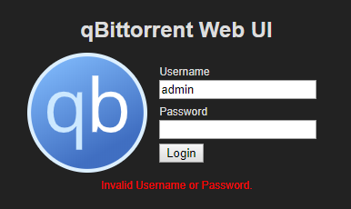

I'm new to Unraid but not to Linux or Dockers. I have read through this forum but did not find anyone who posted a solution to this issue, I did see one other with the same problem. I get to the login page, when I enter the default user name and password I receive an error of invalid username or password. This is a fresh clean install so I'm not sure what I am missing. I did get some information from the qBittorrent logs below. Any assistance would be nice.
W) 2019-07-24T11:40:32 - WebAPI login failure. Reason: invalid credentials, attempt count: 1, IP: ::ffff:10.1.253.1, username:
(W) 2019-07-24T11:40:33 - WebAPI login failure. Reason: invalid credentials, attempt count: 2, IP: ::ffff:10.1.253.1, username:
After installing the docker,
  • Invalid Username and Password (admin/adminadmin).
  • Chrome (with popup enabled), unable to open,  unless using incognito or manually hit enter in address bar.
  • Unable to change the port, as it keeps resetting to 8080.
I have tried a few things, clearing cache, removing the config file, nothing changes.
Any fixes for these?

Password and user is correct. Just checked it here on a new install.
Not sure what you mean by chrome not able to open.
If you change the webui port you also need to set a variable and also delete the existing webui port mapping as you need to set the port to the same on both host and container. Add a new one with the correct port.
Then you probably need to enable authoring mode in docker settings and delete the template url in the Qbittorrent setup so unraid isn't adding the port mapping again.

You do get to the login page?
Yes if I type the address in manually (or use the docker shortcut, and then hit enter on address bar).
And if you type in admin and adminadmin you get invalid login?
Yup, copy and paste, typed out in notepad, from website etc, nothing works.
Have you tried not pasting?
Post the log of qbittorrent from data/qbittorrent/logs in the appdata folder.

Is that log from after a login attempt? There is nothing in the logs about an invalid login.
Yeah, that is the whole log.
I'm just checking through my Anti Malware logs to see if there is still something blocking it there.

OK, I use BitDefender, and it seems that their "Online Threat Protection" is at 'fault' here. Once I added an exception, it worked. I thought I had turned everything off before that, but of course, there is no toggle for that element.
Thank you for your time, I hope that this helps you troubleshoot in the future, with the unable to use default user/pass.
