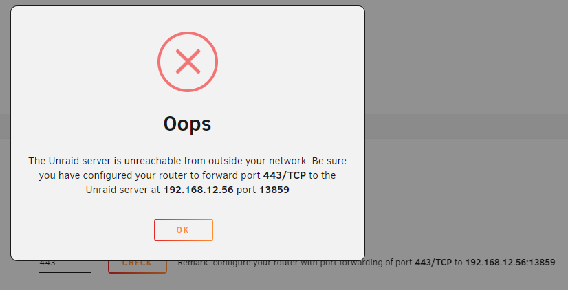

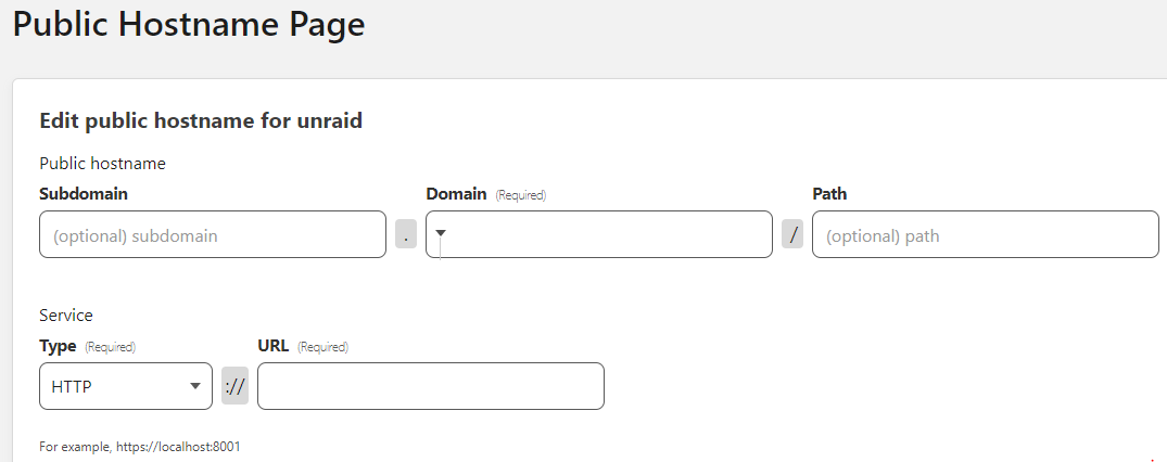

  4. Thanks! When I called Etisalat, they were clueless about the static IP (perhaps because it's reserved for business accounts only?). What is the specific name of the service you're referring to? As of cloudflare, what links/ports must include please ?
  5. (Output is anonymized, use '-vv' to see full details) Unraid OS 6.11.1 with My Servers plugin version 2022.11.29.0742 ✅ Signed in to Unraid.net as alhatmy Use SSL is no ✅ Rebind protection is disabled for myunraid.net Local Access url: http://Tower.local ✅ 192-168-12-56.hash.myunraid.net resolves to 192.168.12.56 Remote Access url: https://[redacted].hash.myunraid.net:[redacted] ✅ [redacted].hash.myunraid.net resolves to [redacted] Request: { "keyfile": "[redacted]", "plgversion": "2022.11.29.0742", "internalhostname": "Tower.local", "internalport": "80", "internalprotocol": "http", "remoteaccess": "yes", "servercomment": "Media server", "servername": "Tower", "internalip": "192.168.12.56", "externalhostname": "*.hash.myunraid.net", "externalport": "[redacted]", "externalprotocol": "https", "unraidreport": "{\"os\":{\"serverName\":\"Tower\",\"version\":\"6.11.1\"},\"api\":{\"version\":\"2.54.0\",\"status\":\"running\",\"environment\":\"production\",\"nodeVersion\":\"v18.5.0\",\"emhttpMode\":\"nchan\"},\"apiKey\":\"valid\",\"myServers\":{\"status\":\"authenticated\",\"myServersUsername\":\"alhatmy\"},\"relay\":{\"status\":\"connected\"},\"minigraph\":{\"status\":\"connected\"},\"cloud\":{\"status\":\"ok\",\"ip\":\"52.40.54.163\"},\"flashbackup\":{\"activated\":\"yes\",\"error\":\"no\"}}" } Response (HTTP 200): [] success

  10. I've attached diagnostics; could someone please confirm if this is a hardware issue? The last time this happened was around a month back, when I discovered the unraid server was still running but everything was down. tower-diagnostics-20221030-0813.zip

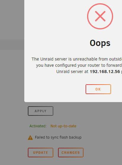

  11. I don't know how to make it work. It has something to do with blocked ports.
  12. Thank you, but I've already followed every step.. I'm certain it has to do with 443 being blocked by the ISP.
