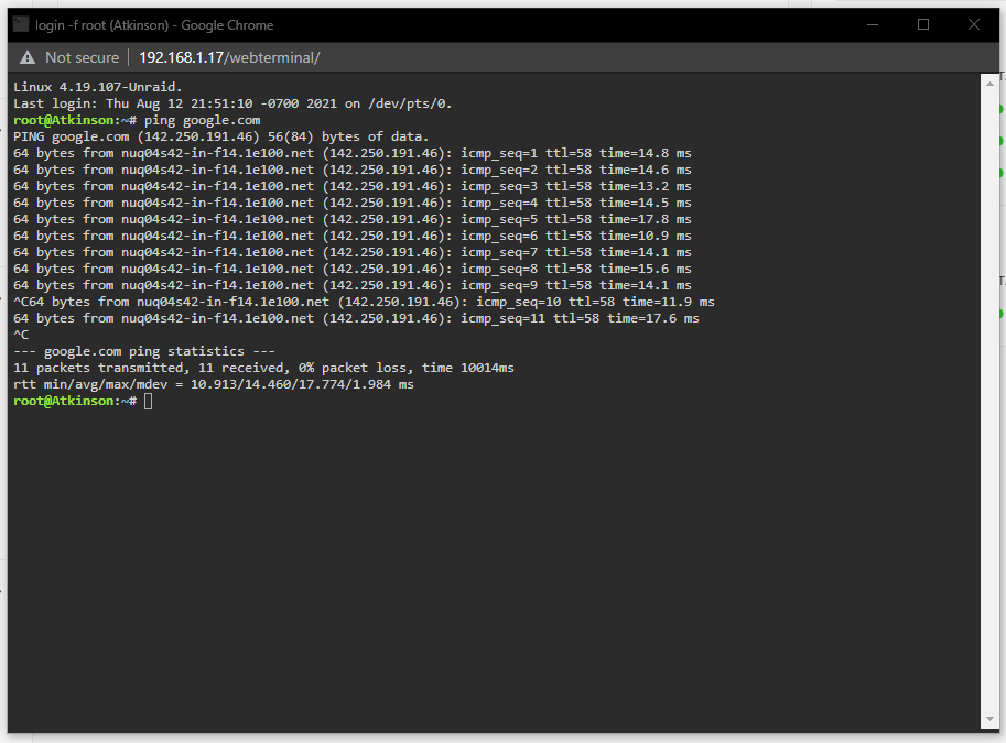

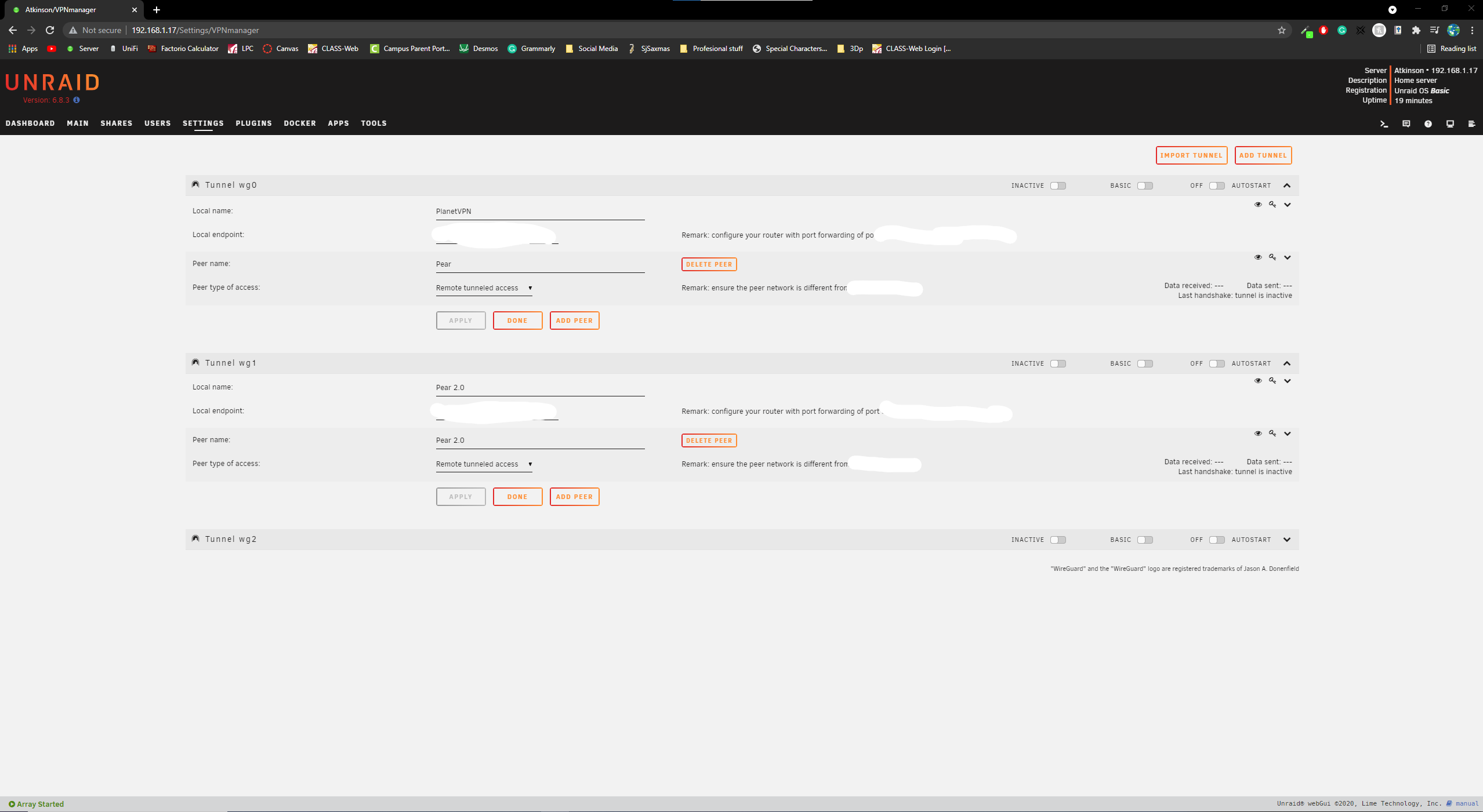

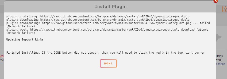

  2. I'm not taking this as a victory, it might ,will break... as this was originally an intermittent issue during the weeks leading up to the OP will continue to update. if there is any diagnostic command I should run while it seemingly works TELL ME.
  3. I've disabled it... i think. If you would rather have me uninstall it and reinstall wire guard once I fix the problem that's an option

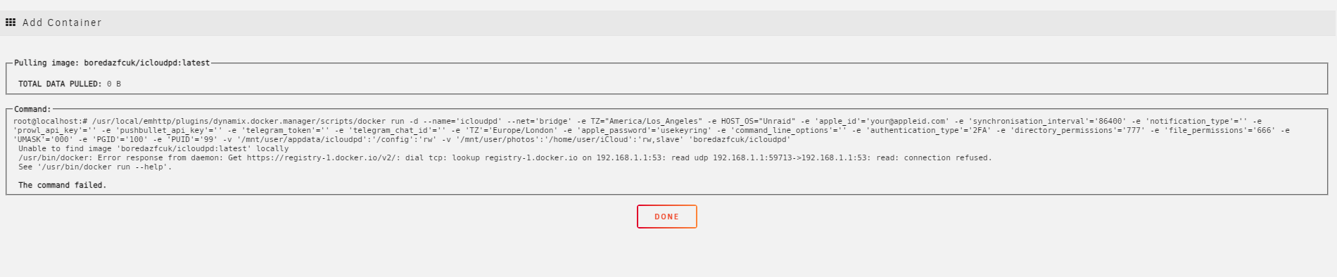

  7. I'm gonna try and bump this at midnight like an idiot because I'm tired of just living with this problem. I tried following this (https://www.redhat.com/sysadmin/beginners-guide-network-troubleshooting-linux) guide I found but honestly I have no reference on what I'm looking at. Here is my command terminal at the end. Linux 4.19.107-Unraid. Last login: Wed Aug 11 23:00:02 -0700 2021 on /dev/pts/0. root@Atkinson:~# ip link show 1: lo: <LOOPBACK,UP,LOWER_UP> mtu 65536 qdisc noqueue state UNKNOWN mode DEFAULT group default qlen 1000 link/loopback 00:00:00:00:00:00 brd 00:00:00:00:00:00 2: tunl0@NONE: <NOARP> mtu 1480 qdisc noop state DOWN mode DEFAULT group default qlen 1000 link/ipip 0.0.0.0 brd 0.0.0.0 3: gre0@NONE: <NOARP> mtu 1476 qdisc noop state DOWN mode DEFAULT group default qlen 1000 link/gre 0.0.0.0 brd 0.0.0.0 4: gretap0@NONE: <BROADCAST,MULTICAST> mtu 1462 qdisc noop state DOWN mode DEFAULT group default qlen 1000 link/ether 00:00:00:00:00:00 brd ff:ff:ff:ff:ff:ff 5: erspan0@NONE: <BROADCAST,MULTICAST> mtu 1450 qdisc noop state DOWN mode DEFAULT group default qlen 1000 link/ether 00:00:00:00:00:00 brd ff:ff:ff:ff:ff:ff 6: ip_vti0@NONE: <NOARP> mtu 1480 qdisc noop state DOWN mode DEFAULT group default qlen 1000 link/ipip 0.0.0.0 brd 0.0.0.0 7: sit0@NONE: <NOARP> mtu 1480 qdisc noop state DOWN mode DEFAULT group default qlen 1000 link/sit 0.0.0.0 brd 0.0.0.0 10: eth0: <BROADCAST,MULTICAST,PROMISC,UP,LOWER_UP> mtu 1500 qdisc fq master br0 state UP mode DEFAULT group default qlen 1000 link/ether 00:8e:25:70:01:72 brd ff:ff:ff:ff:ff:ff 11: eth1: <BROADCAST,MULTICAST> mtu 1500 qdisc noop state DOWN mode DEFAULT group default qlen 1000 link/ether 34:97:f6:85:aa:23 brd ff:ff:ff:ff:ff:ff 12: br0: <BROADCAST,MULTICAST,UP,LOWER_UP> mtu 1500 qdisc noqueue state UP mode DEFAULT group default qlen 1000 link/ether 00:8e:25:70:01:72 brd ff:ff:ff:ff:ff:ff 13: wg1: <POINTOPOINT,NOARP,UP,LOWER_UP> mtu 1420 qdisc noqueue state UNKNOWN mode DEFAULT group default qlen 1000 link/none 14: wg0: <POINTOPOINT,NOARP,UP,LOWER_UP> mtu 1420 qdisc noqueue state UNKNOWN mode DEFAULT group default qlen 1000 link/none 15: docker0: <NO-CARRIER,BROADCAST,MULTICAST,UP> mtu 1500 qdisc noqueue state DOWN mode DEFAULT group default link/ether 02:42:b5:f9:08:b6 brd ff:ff:ff:ff:ff:ff root@Atkinson:~# ip -s link show br0 12: br0: <BROADCAST,MULTICAST,UP,LOWER_UP> mtu 1500 qdisc noqueue state UP mode DEFAULT group default qlen 1000 link/ether 00:8e:25:70:01:72 brd ff:ff:ff:ff:ff:ff RX: bytes packets errors dropped overrun mcast 16550479 96181 0 4 0 0 TX: bytes packets errors dropped carrier collsns 15767237 46282 0 0 0 0 root@Atkinson:~# ip neighbor show 192.168.1.48 dev br0 lladdr 00:04:4b:fb:39:d5 REACHABLE 192.168.1.237 dev br0 lladdr 38:8b:59:04:21:dc STALE 192.168.1.21 dev br0 lladdr 70:85:c2:97:6b:47 REACHABLE 192.168.1.112 dev br0 lladdr 98:84:e3:cc:52:f0 DELAY 192.168.1.20 dev br0 lladdr 70:48:f7:d8:62:46 STALE 192.168.1.38 dev br0 lladdr 00:04:4b:fd:41:ba STALE 192.168.1.16 dev br0 lladdr e0:4f:43:13:75:ab STALE 192.168.1.59 dev br0 lladdr 7c:2e:bd:2e:f1:b4 STALE 192.168.1.201 dev br0 lladdr 1c:69:7a:17:97:60 STALE 192.168.1.113 dev br0 lladdr 26:d7:98:2a:2d:cc STALE 192.168.1.134 dev br0 lladdr c8:d9:d2:e6:72:c5 STALE 192.168.1.1 dev br0 lladdr 26:5a:4c:5e:1e:59 REACHABLE 192.168.1.209 dev br0 lladdr 46:c9:a2:82:f3:27 STALE 192.168.1.140 dev br0 lladdr 1c:30:08:21:3c:ad DELAY 192.168.1.15 dev br0 lladdr 66:3d:36:9f:21:b0 STALE root@Atkinson:~# ip neighbor delete 192.168.1.1 dev br0 root@Atkinson:~# ip neighbor show 192.168.1.48 dev br0 lladdr 00:04:4b:fb:39:d5 REACHABLE 192.168.1.237 dev br0 lladdr 38:8b:59:04:21:dc STALE 192.168.1.21 dev br0 lladdr 70:85:c2:97:6b:47 REACHABLE 192.168.1.112 dev br0 lladdr 98:84:e3:cc:52:f0 REACHABLE 192.168.1.20 dev br0 lladdr 70:48:f7:d8:62:46 STALE 192.168.1.38 dev br0 lladdr 00:04:4b:fd:41:ba STALE 192.168.1.16 dev br0 lladdr e0:4f:43:13:75:ab STALE 192.168.1.59 dev br0 lladdr 7c:2e:bd:2e:f1:b4 STALE 192.168.1.201 dev br0 lladdr 1c:69:7a:17:97:60 STALE 192.168.1.113 dev br0 lladdr 26:d7:98:2a:2d:cc STALE 192.168.1.134 dev br0 lladdr c8:d9:d2:e6:72:c5 STALE 192.168.1.1 dev br0 lladdr 26:5a:4c:5e:1e:59 REACHABLE 192.168.1.209 dev br0 lladdr 46:c9:a2:82:f3:27 STALE 192.168.1.140 dev br0 lladdr 1c:30:08:21:3c:ad STALE 192.168.1.15 dev br0 lladdr 66:3d:36:9f:21:b0 STALE root@Atkinson:~# ip -br address show lo UNKNOWN 127.0.0.1/8 ::1/128 tunl0@NONE DOWN gre0@NONE DOWN gretap0@NONE DOWN erspan0@NONE DOWN ip_vti0@NONE DOWN sit0@NONE DOWN eth0 UP eth1 DOWN br0 UP 192.168.1.17/24 wg1 UNKNOWN 10.253.1.1/32 wg0 UNKNOWN 192.168.1.1/32 docker0 DOWN 172.17.0.1/16 root@Atkinson:~# ping www.google.com ping: www.google.com: Name or service not known root@Atkinson:~# ping 192.168.1.1 PING 192.168.1.1 (192.168.1.1) 56(84) bytes of data. 64 bytes from 192.168.1.1: icmp_seq=1 ttl=64 time=0.011 ms 64 bytes from 192.168.1.1: icmp_seq=2 ttl=64 time=0.011 ms 64 bytes from 192.168.1.1: icmp_seq=3 ttl=64 time=0.010 ms 64 bytes from 192.168.1.1: icmp_seq=4 ttl=64 time=0.009 ms 64 bytes from 192.168.1.1: icmp_seq=5 ttl=64 time=0.010 ms 64 bytes from 192.168.1.1: icmp_seq=6 ttl=64 time=0.008 ms ^C --- 192.168.1.1 ping statistics --- 6 packets transmitted, 6 received, 0% packet loss, time 5115ms rtt min/avg/max/mdev = 0.008/0.009/0.011/0.001 ms root@Atkinson:~# traceroute 192.168.1.1 traceroute to 192.168.1.1 (192.168.1.1), 30 hops max, 60 byte packets 1 192.168.1.1 (192.168.1.1) 0.014 ms 0.005 ms 0.004 ms root@Atkinson:~# traceroute www.google.com www.google.com: Name or service not known Cannot handle "host" cmdline arg `www.google.com' on position 1 (argc 1) root@Atkinson:~# ip route show default via 192.168.1.1 dev br0 proto dhcp src 192.168.1.17 metric 212 10.253.1.2 dev wg1 scope link 172.17.0.0/16 dev docker0 proto kernel scope link src 172.17.0.1 linkdown 192.168.1.0/24 dev br0 proto dhcp scope link src 192.168.1.17 metric 212 192.168.1.20 dev wg0 scope link root@Atkinson:~# nslookup www.google.com -bash: nslookup: command not found root@Atkinson:~# ss -tunlp4 Netid State Recv-Q Send-Q Local Address:Port Peer Address:Port Process udp UNCONN 0 0 127.0.0.1:743 0.0.0.0:* users:(("rpc.statd",pid=1838,fd=7)) udp UNCONN 0 0 192.168.1.17:58356 0.0.0.0:* users:(("Plex Media Serv",pid=3897,fd=91)) udp UNCONN 0 0 0.0.0.0:50279 0.0.0.0:* users:(("rpcbind",pid=1833,fd=7)) udp UNCONN 0 0 127.0.0.1:34138 0.0.0.0:* users:(("Plex Media Serv",pid=3897,fd=90)) udp UNCONN 0 0 0.0.0.0:1900 0.0.0.0:* users:(("Plex DLNA Serve",pid=4014,fd=10)) udp UNCONN 0 0 0.0.0.0:1901 0.0.0.0:* users:(("Plex Media Serv",pid=3897,fd=94)) udp UNCONN 0 0 0.0.0.0:1956 0.0.0.0:* users:(("Plex DLNA Serve",pid=4014,fd=19)) udp UNCONN 0 0 0.0.0.0:51820 0.0.0.0:* udp UNCONN 0 0 0.0.0.0:51821 0.0.0.0:* udp UNCONN 0 0 127.0.0.1:35968 0.0.0.0:* users:(("Plex Media Serv",pid=3897,fd=92)) udp UNCONN 0 0 0.0.0.0:60674 0.0.0.0:* users:(("Plex DLNA Serve",pid=4014,fd=25)) udp UNCONN 0 0 0.0.0.0:44407 0.0.0.0:* users:(("rpc.statd",pid=1838,fd=8)) udp UNCONN 0 0 0.0.0.0:3667 0.0.0.0:* users:(("Plex DLNA Serve",pid=4014,fd=16)) udp UNCONN 0 0 192.168.1.17:54119 0.0.0.0:* users:(("Plex Media Serv",pid=3897,fd=93)) udp UNCONN 0 0 192.168.1.17:46072 0.0.0.0:* users:(("Plex Media Serv",pid=3897,fd=95)) udp UNCONN 0 0 0.0.0.0:5353 0.0.0.0:* users:(("avahi-daemon",pid=2467,fd=14)) udp UNCONN 0 0 0.0.0.0:55827 0.0.0.0:* users:(("avahi-daemon",pid=2467,fd=16)) udp UNCONN 0 0 0.0.0.0:56572 0.0.0.0:* users:(("Plex DLNA Serve",pid=4014,fd=28)) udp UNCONN 0 0 0.0.0.0:32410 0.0.0.0:* users:(("Plex Media Serv",pid=3897,fd=87)) udp UNCONN 0 0 0.0.0.0:32412 0.0.0.0:* users:(("Plex Media Serv",pid=3897,fd=88)) udp UNCONN 0 0 0.0.0.0:32413 0.0.0.0:* users:(("Plex Media Serv",pid=3897,fd=89)) udp UNCONN 0 0 0.0.0.0:32414 0.0.0.0:* users:(("Plex Media Serv",pid=3897,fd=86)) udp UNCONN 0 0 192.168.1.17:68 0.0.0.0:* users:(("dhcpcd",pid=1735,fd=9)) udp UNCONN 0 0 0.0.0.0:111 0.0.0.0:* users:(("rpcbind",pid=1833,fd=6)) udp UNCONN 0 0 192.168.1.17:123 0.0.0.0:* users:(("ntpd",pid=1868,fd=17)) udp UNCONN 0 0 127.0.0.1:123 0.0.0.0:* users:(("ntpd",pid=1868,fd=16)) udp UNCONN 0 0 172.17.255.255:137 0.0.0.0:* users:(("nmbd",pid=2670,fd=25)) udp UNCONN 0 0 172.17.0.1:137 0.0.0.0:* users:(("nmbd",pid=2670,fd=24)) udp UNCONN 0 0 192.168.1.255:137 0.0.0.0:* users:(("nmbd",pid=2670,fd=20)) udp UNCONN 0 0 192.168.1.17:137 0.0.0.0:* users:(("nmbd",pid=2670,fd=19)) udp UNCONN 0 0 0.0.0.0:137 0.0.0.0:* users:(("nmbd",pid=2670,fd=17)) udp UNCONN 0 0 172.17.255.255:138 0.0.0.0:* users:(("nmbd",pid=2670,fd=27)) udp UNCONN 0 0 172.17.0.1:138 0.0.0.0:* users:(("nmbd",pid=2670,fd=26)) udp UNCONN 0 0 192.168.1.255:138 0.0.0.0:* users:(("nmbd",pid=2670,fd=22)) udp UNCONN 0 0 192.168.1.17:138 0.0.0.0:* users:(("nmbd",pid=2670,fd=21)) udp UNCONN 0 0 0.0.0.0:138 0.0.0.0:* users:(("nmbd",pid=2670,fd=18)) tcp LISTEN 0 50 0.0.0.0:139 0.0.0.0:* users:(("smbd",pid=2665,fd=33)) tcp LISTEN 0 128 0.0.0.0:111 0.0.0.0:* users:(("rpcbind",pid=1833,fd=8)) tcp LISTEN 0 128 0.0.0.0:80 0.0.0.0:* users:(("nginx",pid=3278,fd=9),("nginx",pid=3277,fd=9)) tcp LISTEN 0 128 127.0.0.1:32401 0.0.0.0:* users:(("Plex Media Serv",pid=3897,fd=57)) tcp LISTEN 0 100 0.0.0.0:32469 0.0.0.0:* users:(("Plex DLNA Serve",pid=4014,fd=22)) tcp LISTEN 0 128 0.0.0.0:21 0.0.0.0:* users:(("inetd",pid=2396,fd=5)) tcp LISTEN 0 128 0.0.0.0:22 0.0.0.0:* users:(("sshd",pid=2388,fd=3)) tcp LISTEN 0 50 0.0.0.0:1815 0.0.0.0:* users:(("Plex DLNA Serve",pid=4014,fd=13)) tcp LISTEN 0 128 0.0.0.0:23 0.0.0.0:* users:(("inetd",pid=2396,fd=6)) tcp LISTEN 0 128 0.0.0.0:45303 0.0.0.0:* users:(("rpc.statd",pid=1838,fd=9)) tcp LISTEN 0 128 127.0.0.1:32600 0.0.0.0:* users:(("Plex Tuner Serv",pid=4017,fd=10)) tcp LISTEN 0 50 0.0.0.0:445 0.0.0.0:* users:(("smbd",pid=2665,fd=32)) tcp LISTEN 0 128 127.0.0.1:44767 0.0.0.0:* users:(("Plex Script Hos",pid=3933,fd=8)) root@Atkinson:~#

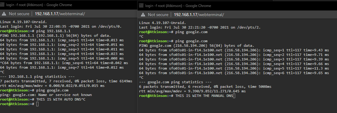

  8. recently switched to Unifi and since then my server has no internet access. The server functions perfectly for local access. I've tried to set the dns servers as 1.1.1.1 8.8.8.8 or use the built in ethernet vs the 2.5gig. I'm wondering if Unifi doesn't work perfectly with Unraid and how to tell that that's the case when all other devices work properly. Here is the diagnostics atkinson-diagnostics-20210811-1153.zip
