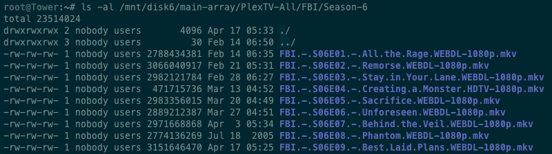

  1. Its over samba. Its fine when I write to an existing disk, its when it decides to split to a new disk and make the hierarchy.
  2. Hey, hope you can help... You can see here that the permissions are correct for a long-lived folder: However, if it then splits to another disk the folder permission seems wrong? Any ideas?

  4. Thanks for your response. The new permissions script fixes the already created directories but when I end up creating another directory the directory has the same issue. I thought the ACL was interesting but the same happens when I create a directory from a windows machine too so I don't think its my fstab entry? I have removed the dir_mode and file_mode with no success.
  5. So... I have two users: "windowspc" and "homeserver1" they both have read/write access to my "main-array" share. I connect with my ubuntu server with the following /etc/fstab entry: //192.168.4.24/main-array /mnt/storage-server-01 cifs vers=3.0,rw,_netdev,noserverino,credentials=/etc/storage-server-creds,file_mode=0666,dir_mode=0777 0 0 I create a folder on my server using the above. Its connected with "homeserver1". When doing "ls -al" on the unraid server I see I made: drwxrwx---+ 1 homeserver1 users 6 Jun 4 00:28 test/ This clearly means that when I try to view the folder on a network mount from my windows machine, which is connected with the "windowspc" user I don't have the ability to read that folder. Any ideas? TIA
