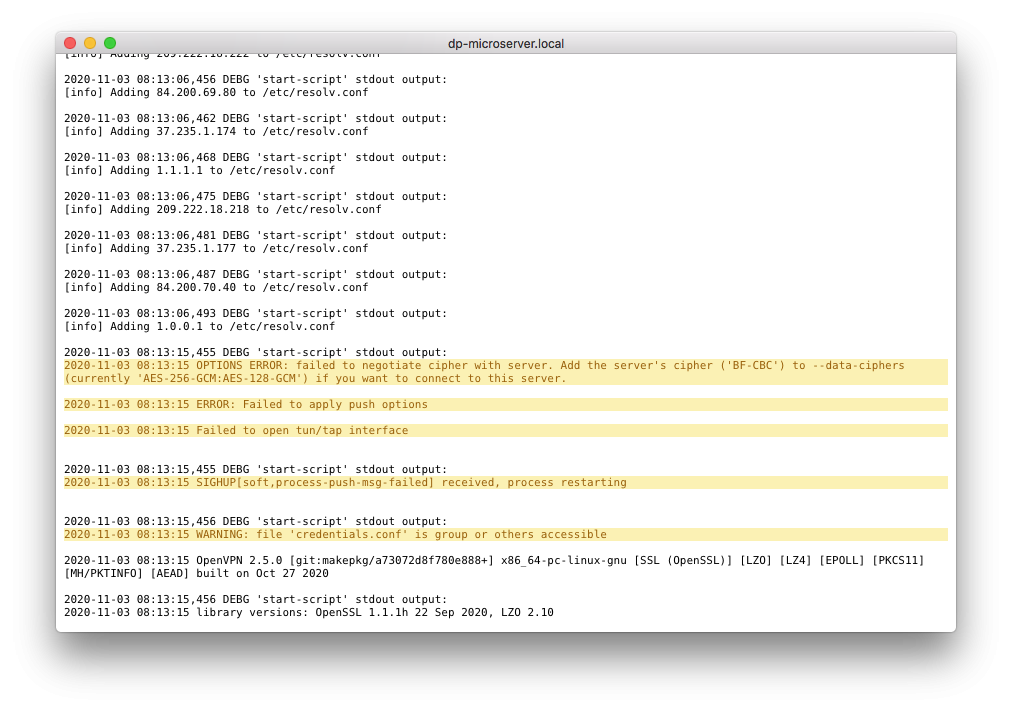

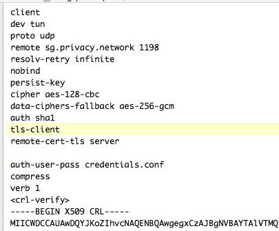

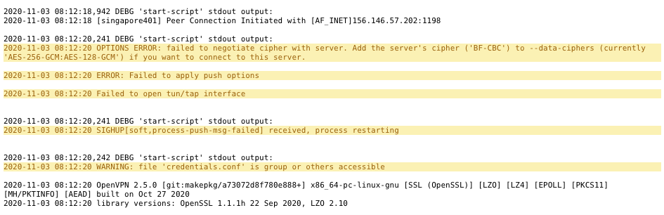

  3. Hi All, My container updated again over-night and its not working. This time, I'm getting the same cipher error as others. Im using PIA. I have done the following with no success; 1) pulled down the latest nextgen openVPN files. replaced all three on my server with new versions. 2) removed the cipher line and replaced it with fallback line from Q22 3) I tried leaving the original cipher line in and adding the fallback line immediately beneath 4) i've tried 3 different endpoints, all with the same error (Singapore, Romania, Perth) 5) i've tried with and without strict port forwarding enabled (PIA tell me all non US nextgen servers are now port forward enabled?) Any suggestions? please

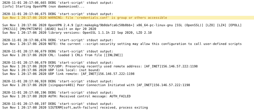

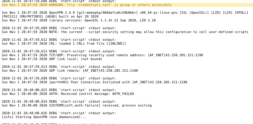

  6. Hi All, Im having trouble that i simply can't get past. My container updates overnight, I'm running the latest. Now, the VPN won't connect. the logs are giving me an AUTH_FAILED error. I've checked the FAQ and gone through the suggestions there. i've changed my password, i've tried other endpoints, i've moved over to the next-gen configs (copied the certs an the new ovpn files over), i've removed all special chars from the password, i've forced an update to ensure i was on the latest build (i was/am), etc. etc. It simply will not connect via deluge. I can however connect to the end point via a desktop openVPN client so i know the end point is up and my creds are fine. I've attached a screen shot from the log file - Im not picky at this point as to which server i connect to.. i just can't for the life of me work out whats going on???? any suggestions, idea's? anything? PLEASE HELP
