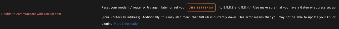

  1. Hi guys, Unraid keeps randomly losing internet connection. A reboot fixes the issue but then shortly loses internet. I've done a hard reset of my router, no difference. Any help would be appreciated. tower-diagnostics-20250605_2356.zip
  2. I've un-installed Tailscale Plugin. Unraid Apps loads up OK now. How do I do a fresh install of Tailscale? Thanks
  3. https://forums.unraid.net/topic/141156-unraid-api-error-cloud-socket-closed/ Didn't realise at first but had this api error cloud socket closed as well, the link fixed that error. Fixed Plex by re-installing. Now works great. 🤞
  4. Just ran Fix Common Problems and I'm getting the following:
  5. Hi I seem to be having all sorts of network issues atm. Had Unraid set up for years with no issues. Upgraded to the last V7, which seems to have gone great. 2 weeks later over the weekend, I'm having the following issues: Cannot connect remotely to Pi-Hole, although I can connect locally and it is blocking ads locally. Plex not showing library, locally or remotely. Can't connect to the UnRaid Apps, gets stuck on Updating content, then I get the following message: Download of appfeed failed. Community Applications requires your server to have internet access. The most common cause of this failure is a failure to resolve DNS addresses. You can try and reset your modem and router to fix this issue, or set static DNS addresses (Settings - Network Settings) of 208.67.222.222 and 208.67.220.220 and try again. Funny thing is, if I change the DNS address, It works once only then reverts to the failed message above. Tailscale Exit Node does not work anymore. Is it normal that Plex and Pi-hole are showing "all" under Container Port column. No changes to hardware or ISP. Thanks for looking Edit: I forgot to add all other Apps are working fine remotely. tower-diagnostics-20250527-1810.zip
  6. Hi Been using Plex for years with no issues. This evening started getting 400 Bad Request. Error in the Plex logs is "Critical: libusb_init failed". Not sure when Apps issue started. If I change DNS in Network Settings, I can connect to Apps, but only works once then errors. Had issues over the weekend with DelugeVPN not working as well, but I fixed that by changing from OpenVPN to Wireguard Everything else seems to be working fine. Thanks
