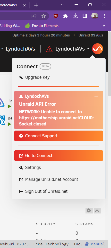

July 15, 20233 yr I have a Similar error, when I followed the renaming of network.cfg in the /boot/config folder to network.cfg.old and rebooted the system. After 10 minutes, it stiil has NOT created a new network.cfg. Any help would be appreciated. Error: Unble to connect to https://mothership.unrid.netCLOUD: sooket closed
July 16, 20233 yr 8 hours ago, LyndochAVs said: After 10 minutes, it stiil has NOT created a new network.cfg. This file only gets created if you go the network settings and make a change there. Until then it simply uses default settings.
