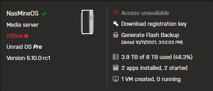

  5. I found the solution before your answer. I changed the net name on the router, after the upgrade the server change from unraid.net to myunraid.net, that simple change lock the access to it from pfSense. I suggest to put this information for the community to be aware of this beaver. Many thanks for the info by the way.
  6. After the last update, I lost the remote connections from a remote PCV in the same network. I already lost the connection server from the Internet caused of my rooter pFsense. I can only access the UI from the server directly. Does someone have a solution for this issue, especially from the same network?
  7. I can not fund a rule in PfSense to allow the traftrafficick to my WebGui of Unraid server. Can someone help me, please?

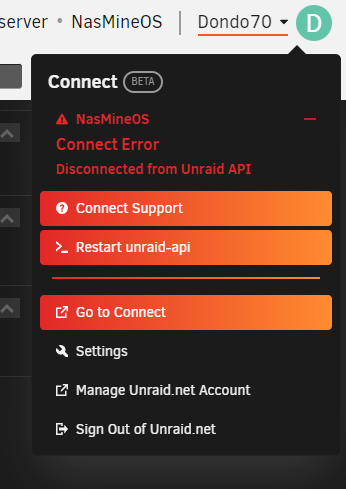

  8. Same here after upgrrade to 6.10-0 Rc2 keep unsing and is not easy
  9. I have this situation, but the server is running well. I will try to restart the API and I let you know if is going good or not.
