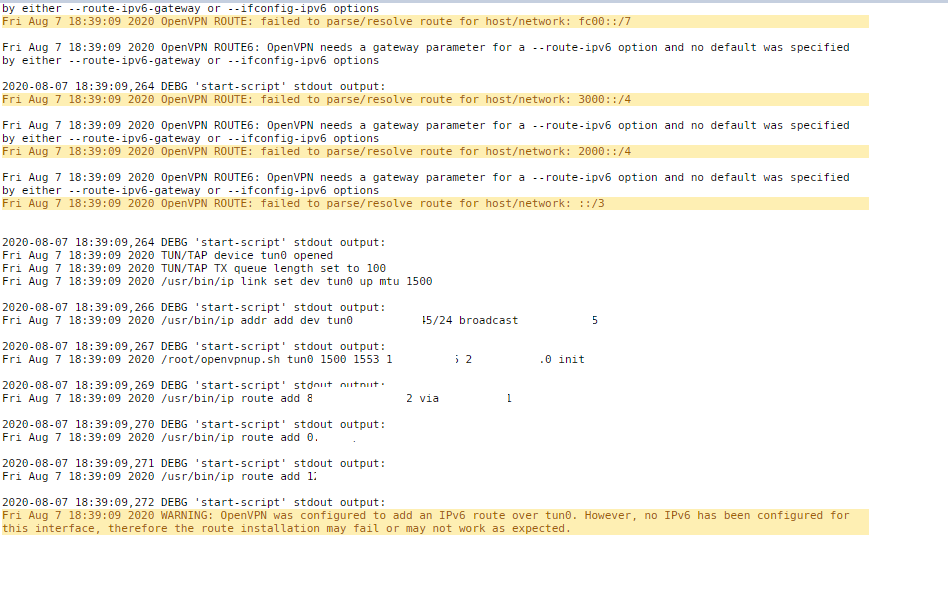

  1. Hey guys, I just wanted to try my luck again. Is anyone having an issue with slow speeds with airvpn in the delugeVPN container? I'm not even sure how to start testing for the slow speeds.

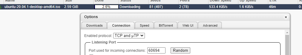

  4. your ui looks different than mine but I matched your setting (we had different settings). Mine: I'm changing my settings to: I have no way to test the port inside of delugeVPN Results:
  5. Just for fun I tried that file that you asked me to make in QBtorrent and I got the same slow speeds 😮 I will go look for itconfig like you said thanks. Also any chance you could share your delugeVPN container settings (blurring out sensible stuff) I want to compare a working one with mine, maybe I screwed something up at that level? at any rate thank you for your help and time!
  6. Roger! go to https://airvpn.org/generator/ and create a fresh - Netherlands 443 udp start delugeVPN with new config file change setting from -1 Maxium upload speed to 350kbs well bellow my max confirm port 60694 is being used and that it passes TCP check in airvpn.org/ports/ Results: Same slow speeds
  7. Hello there, Let me start by saying thanks for the awesome containers. I'm currently using DelugeVPN but the following is also true for QBtorrentVPN as I tested with both. Issue 1: AirVPN had slow speeds and no uploads, I fixed this with port forwarding. Container can upload now at around my max upload speed! Issue 2: My downloads dont go past 1.2 mbs per second, usually they hover at 500kbs down 500kbs up. Trouble shooting done so far: Try 25 different severs in the 4 continents available in AirVPN - same speeds Try all those servers again but know using ubuntu.iso as a test (lots of seeds) - this takes me to 1.2 max Try downloading ubuntu.iso on my windows vm without VPN/proxy - max 10mbs Now the same torrent inside delugeVPN this time I'm using UDP port 53 (canada) as I read online that changing ports might help - no change max speed is 1.2 average is around 500kbs. Ok so now I'm thinking, it has to be airVPN screwing with my speeds (im a noob), I decide to test this theory I'm going to install Eddie and connect to the vpn on my windows machine, forward the same port as I do in delugeVPN and see what happens - oh hey connecting to the same Canadian point yields faster speeds. Conclusion: Can I please have some help making my VPN container go faster please? My setup in step #5 goes fast even with a random port (I know this because I tested port 60694 in the /ports/ section of airvpn and the check failed yet the speed is amazing, note that the port test passes when I'm using delugeVPN and I test the port). At any rate I'm not sure where I messed up here. update 1: I was reading again (when will I learn?) and I found that maybe switching to ssl would fix my issues (though in retrospect my issues not my isp so I don't think this will fix the issue) anyway I tried to use the .ovpn file but the container refused to start with error along the lines of I cant bind to 127.0.0.1:1443 although the ssl port i picked was 53). Again i don't think this is really the path to follow to fix my issue. update 2: I figured i should see if my container is the issue I turned off the vpn and the speeds are just like my windows vm so that is not the issue either I think: I tried torrents for archive.org with the same results vpn+container = 1/10th the speed. update 3: So I was thinking maybe I'm not getting an error but I'm sure as hell getting warnings maybe one of them holds the key to my poor speeds? I get this same error every time I use my udp config files (which again are the only ones that actually run) maybe they mean something to you guys? update 4: changing the udp port to say 53 - this didn't make a difference makes sense no isp throttling but hey I gotta keep testing stuff. update 5: tcp? why not lets try that! - this was slower than UDP it usually hovered aorund 400kbs. TL;DR: I've tried a lot of things to improve the speed of my binhexVPN container but I'm unable to match the speeds I get inside of my windows vm when connected to the same server - Canada Lacerta - upd - 443 (yes I did keep testing this setup with other servers with the same results).

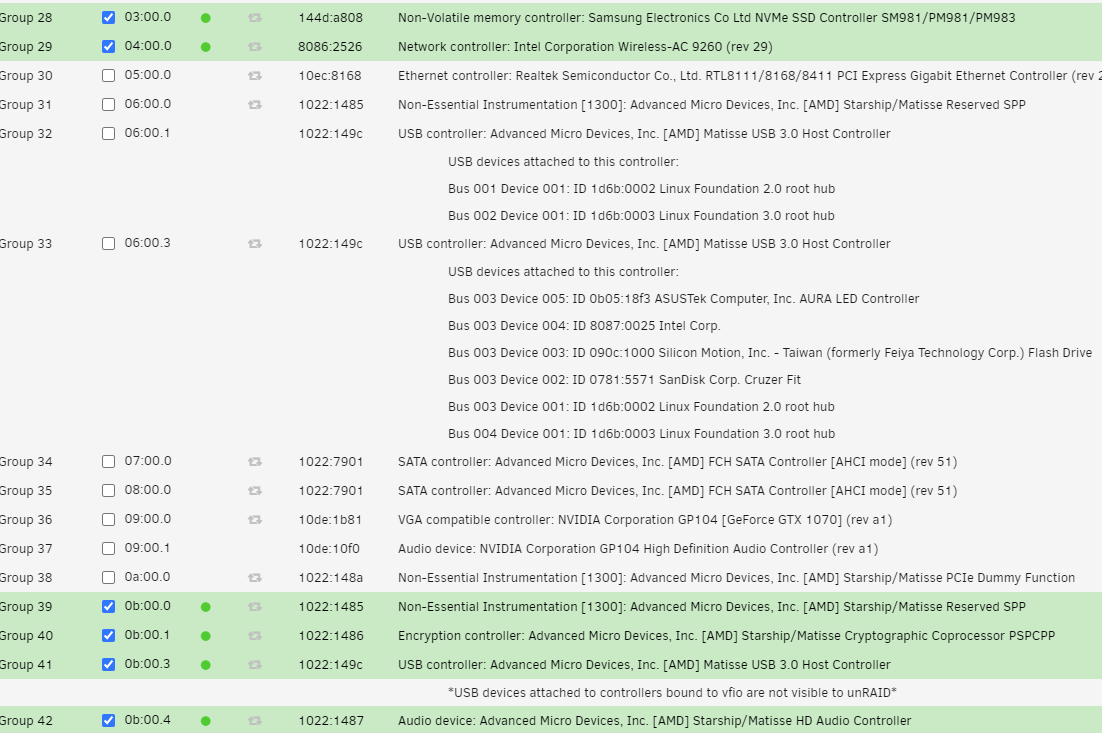

  8. Hello @Skitals, I have the same issue as the person you quoted. As you mentioned our AMD boards have a single vendorID for all the usb controllers =(. I installed VFIO-PCI Config and I use it to pass my pci drive (it works great!). But when I try to use for my audio device the computer hangs, I believe it is hanging because its grabbing all the usb controllers =/. These are my selections: My server also hangs if I try to append pcie_no_flr=1022:1485,1022:149c vfio-pci.ids=1022:1485,1022:149c as it makes my unraid usb drive unmount during boot, making it unusable. I feel the same thing happens when I ty to pass 0b:00.* devices =/. I also tried just doing it via the XML: <devices> <emulator>/usr/local/sbin/qemu</emulator> <disk type='file' device='disk'> <driver name='qemu' type='raw' cache='writeback'/> <source file='/mnt/user/isos/spaces_win_clover.img'/> <target dev='hdc' bus='virtio'/> <boot order='1'/> <address type='pci' domain='0x0000' bus='0x00' slot='0x05' function='0x0'/> </disk> <disk type='file' device='cdrom'> <driver name='qemu' type='raw'/> <source file='/mnt/user/isos/virtio-win-0.1.173-2.iso'/> <target dev='hdb' bus='sata'/> <readonly/> <address type='drive' controller='0' bus='0' target='0' unit='1'/> </disk> <controller type='pci' index='0' model='pci-root'/> <controller type='sata' index='0'> <address type='pci' domain='0x0000' bus='0x00' slot='0x03' function='0x0'/> </controller> <controller type='virtio-serial' index='0'> <address type='pci' domain='0x0000' bus='0x00' slot='0x04' function='0x0'/> </controller> <controller type='usb' index='0' model='ich9-ehci1'> <address type='pci' domain='0x0000' bus='0x00' slot='0x07' function='0x7'/> </controller> <controller type='usb' index='0' model='ich9-uhci1'> <master startport='0'/> <address type='pci' domain='0x0000' bus='0x00' slot='0x07' function='0x0' multifunction='on'/> </controller> <controller type='usb' index='0' model='ich9-uhci2'> <master startport='2'/> <address type='pci' domain='0x0000' bus='0x00' slot='0x07' function='0x1'/> </controller> <controller type='usb' index='0' model='ich9-uhci3'> <master startport='4'/> <address type='pci' domain='0x0000' bus='0x00' slot='0x07' function='0x2'/> </controller> <interface type='bridge'> <mac address='xx:54:xx:6f:xx:xx'/> <source bridge='br0'/> <model type='virtio'/> <address type='pci' domain='0x0000' bus='0x00' slot='0x02' function='0x0'/> </interface> <serial type='pty'> <target type='isa-serial' port='0'> <model name='isa-serial'/> </target> </serial> <console type='pty'> <target type='serial' port='0'/> </console> <channel type='unix'> <target type='virtio' name='org.qemu.guest_agent.0'/> <address type='virtio-serial' controller='0' bus='0' port='1'/> </channel> <input type='mouse' bus='ps2'/> <input type='keyboard' bus='ps2'/> <hostdev mode='subsystem' type='pci' managed='yes'> <driver name='vfio'/> <source> <address domain='0x0000' bus='0x09' slot='0x00' function='0x0'/> </source> <rom file='/mnt/user/isos/zotak-1070.rom'/> <address type='pci' domain='0x0000' bus='0x00' slot='0x06' function='0x0' multifunction='on'/> </hostdev> <hostdev mode='subsystem' type='pci' managed='yes'> <driver name='vfio'/> <source> <address domain='0x0000' bus='0x09' slot='0x00' function='0x1'/> </source> <address type='pci' domain='0x0000' bus='0x00' slot='0x06' function='0x1'/> </hostdev> <hostdev mode='subsystem' type='pci' managed='yes'> <driver name='vfio'/> <source> <address domain='0x0000' bus='0x03' slot='0x00' function='0x0'/> </source> <address type='pci' domain='0x0000' bus='0x00' slot='0x09' function='0x0'/> </hostdev> <hostdev mode='subsystem' type='pci' managed='yes'> <driver name='vfio'/> <source> <address domain='0x0000' bus='0x04' slot='0x00' function='0x0'/> </source> <address type='pci' domain='0x0000' bus='0x00' slot='0x0a' function='0x0'/> </hostdev> <hostdev mode='subsystem' type='pci' managed='yes'> <driver name='vfio'/> <source> <address domain='0x0000' bus='0x0b' slot='0x00' function='0x0'/> </source> <address type='pci' domain='0x0000' bus='0x00' slot='0x0b' function='0x0' multifunction='on'/> </hostdev> <hostdev mode='subsystem' type='pci' managed='yes'> <driver name='vfio'/> <source> <address domain='0x0000' bus='0x0b' slot='0x00' function='0x1'/> </source> <address type='pci' domain='0x0000' bus='0x00' slot='0x0c' function='0x0'/> </hostdev> <hostdev mode='subsystem' type='pci' managed='yes'> <driver name='vfio'/> <source> <address domain='0x0000' bus='0x0b' slot='0x00' function='0x3'/> </source> <address type='pci' domain='0x0000' bus='0x00' slot='0x0d' function='0x0'/> </hostdev> <hostdev mode='subsystem' type='pci' managed='yes'> <driver name='vfio'/> <source> <address domain='0x0000' bus='0x0b' slot='0x00' function='0x4'/> </source> <address type='pci' domain='0x0000' bus='0x00' slot='0x0e' function='0x0'/> </hostdev> <memballoon model='none'/> </devices> With and without multifunction='on' they both un mount my unraid drive.
  9. Thank you for the file! Passing the sound kept crashing my server but after adding your modified files to my usb and the pcie_no_flr to flash settings got my sound working! I'm having some issues passing a single usb hub, passing it to the windows 10 vm results in a unraid crash so I'm forced to pass the keyboard and mouse connected to it instead. I figured I could just append the id like so: IOMMU group 41: [1022:149c] 0b:00.3 USB controller: Advanced Micro Devices, Inc. [AMD] Matisse USB 3.0 Host Controller IOMMU group 42: [1022:1487] 0b:00.4 Audio device: Advanced Micro Devices, Inc. [AMD] Starship/Matisse HD Audio Controller append pcie_acs_override=downstream pcie_no_flr=1022:1487,1022:149c initrd=/bzroot But my guess didn't pan out, I still cant pass that usb hub. I'm on hour 30+ of trying to build this machine so I'm going to to bed, thank you all for your help I'm almost there this is literally the last thing I need to pass before I can go work on the dockers :).
