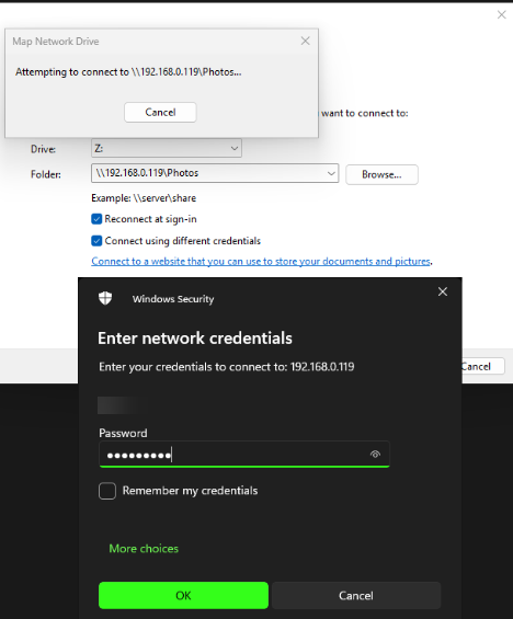

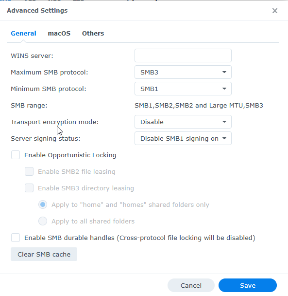

  1. Hi All, Firstly I tried to raise this topic in the docker support section but don't seem to be able to, so sorry if this is posted in the wrong section! Feel like I've exhausted all of my knowledge on trying to get Xpenology to mount a CIFS share, which is shared on my unraid server. When trying to mount the CIFS share It will eventually time out with the below message The logs on the virtual-dsm docker show a CIFS VFS: cifs_mount failed w/return code = -113 The share on unraid is a public share but I have setup a user account on unraid and the credentials are being entered in correctly on the CIFS window in Xpenology. If I try mounting the Photo share on a windows machine it works fine. I've tried various options under SMB advanced settings to lower the SMB version minimum requirement, and played around with some other options but to no avail. I also tried mounting the shares under unassigned devices on unraid , both with NFS and CIFS but still unable to connect. The main aim was for me to be able to use the mobile apps like DS File. Any help would be great. Thanks
  2. Seems to have worked now, I haven't changed anything since I raised this ticket. Today I ran unraid-api restart in terminal twice to get 'My Server' working after a Graphpl error.

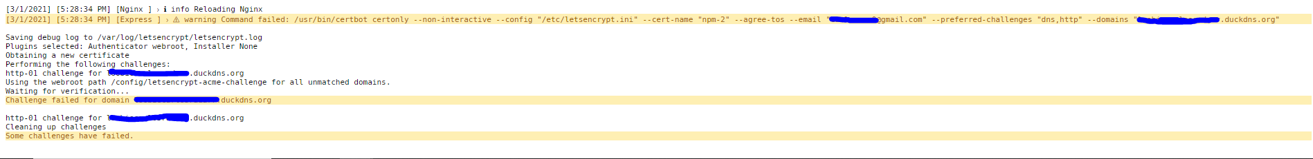

  9. Hi, I created my certificates for my sub domains around 3 months ago and all worked fine, upon renewing them I've getting the below message. I seem to have this problem constantly and generally reinstalled Nginx seem to fix it but this time it hasn't. Any ideas why this problem is occurring? I've updated Let's entrypt to SWAG and also have the duckdns and NGINX proxy manager installed (The latter is where I'm seeing the error in the logs from). Any help would be greatly appreciated. Thanks in advance.
