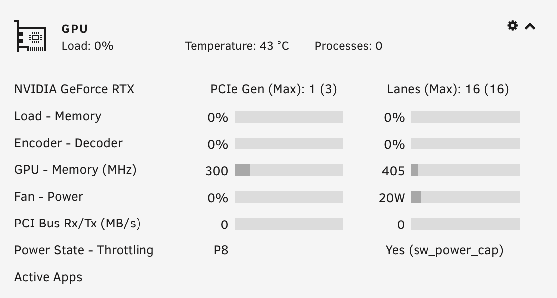

  2. If you are not using the GPU as a passthrough for a VM, but like to use it for Docker you can set it to idle mode as follows. Install the following plugins. NVIDIA drivers: https://forums.unraid.net/topic/98978-plugin-nvidia-driver/ GPU Statistics: https://forums.unraid.net/topic/89453-plugin-gpu-statistics/ UserScripts: https://forums.unraid.net/topic/48286-plugin-ca-user-scripts/ You can add the command to run at "First start of Array" only to set the GPU to idle mode on boot. Or any other schedule of course. nvidia-smi --persistence-mode=ENABLED Very nice! 👍
  3. Thanks, sounds interesting! I'm getting an error on Ubuntu even with sudo: nvidia-persistenced failed to initialize. Check syslog for more details. And the syslog: Apr 24 19:20:31 ubuntu nvidia-persistenced: Failed to lock PID file: Resource temporarily unavailable Apr 24 19:20:31 ubuntu nvidia-persistenced: Shutdown (3457) The manual says you don't need to run it directly and use nvidia-smi: Once the init script is installed so that the daemon is running, users should not normally need to manually interact with nvidia-persistenced: the NVIDIA management utilities, such as nvidia-smi, can communicate with it automatically as necessary to manage persistence mode. I was able to set it using: sudo nvidia-smi --persistence-mode=ENABLED First that increased power usage to 49W. And then it dropped back to 20W. So that seems to be an easier alternative. Thanks!
  4. My new server has a NVIDIA RTX2070 Super GPU which was having a relatively high idle power. The link to this topic discusses that and proposes as a solution to run a Windows VM which sets the GPU to use less power. Since Windows tends to do a lot of other things in the background I wanted to see if this could be done in a Linux VM as well. As mentioned by @SimonF below, an easier alternative is just setting persistence mode on the GPU: sudo nvidia-smi --persistence-mode=ENABLED So the information below is just for reference if people come here from a search engine. And it shows the reduced power usage. 🙂 The nvidia-smi tool can show the current performance mode: Performance State The current performance state for the GPU. States range from P0 (maximum performance) to P12 (minimum performance). See: nvidia-smi docs Mine says P0 which according to the manual is the highest performance which uses 38W while idle: |===============================+======================+======================| | 0 NVIDIA GeForce ... Off | 00000000:04:00.0 Off | N/A | | 0% 48C P0 38W / 215W | 0MiB / 8192MiB | 0% Default | | | | N/A | +-------------------------------+----------------------+----------------------+ You can change the performance mode using nvidia-settings: nvidia-settings -a "[gpu:0]/GpuPowerMizerMode=2" See Nvidia-settings docs. Trying to do so results in this error message: Unable to init server: Could not connect: Connection refused ERROR: The control display is undefined; please run `nvidia-settings --help` for usage information. It requires a graphical user interface which we don't have in the terminal. You can fix this by running a dummy X server as explained here: https://serverfault.com/a/1055788 After doing this my GPU was set to P8 and only uses 20W idle: |===============================+======================+======================| | 0 NVIDIA GeForce ... Off | 00000000:04:00.0 Off | N/A | | 0% 36C P8 20W / 215W | 7MiB / 8192MiB | 0% Default | | | | N/A | +-------------------------------+----------------------+----------------------+ Aso it runs a bit cooler which is a nice extra. More information and screenshots about the performance mode can be read here: https://rastating.github.io/how-to-permanently-set-nvidia-powermizer-settings-in-ubuntu/ Unfortunately I was unable to set it to P12 which should be the minimal power usage. Although it says 20W, my meter only shows around 10-15W extra after adding the GPU. Which is what it should be if I read idle power usage of a RTX2070 super online. Not sure how that is possible. In my experience this is the same as using the Windows VM. But I'd rather run a small Linux VM to keep my GPU idle power to a minimum than running a Windows VM. Still looking for a real solution, but until that I'll keep the GPU power to minimum this way when I'm not using it.

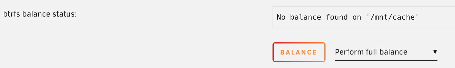

  13. Thanks! That fixed it. I ran: btrfs balance start -dusage=75 /mnt/cache and the alert was resolved. While I was waiting I explored the GUI some more and noticed there is also a button to do this:
  14. I just installed Netdata too and it's really great! But within one day I also have this alert. Did you ever find out how to solve or clear it?
