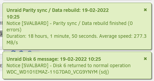

  10. That drive is connected to: LSI/Avago/Broadcom SAS 9300-8i HBA PCIe 3.0 Just to add... Power cut happened while I was copying files from unassigned disk into the array. Maybe that's why it wasn't mountable after powering back up? That's my server: - Intel Core i5-9600K 9th Gen Coffee Lake - Cooler Master Hyper H412R - ASRock B365M Phantom Gaming 4 - Crucial 32GB DDR4 RAM 2666MHz PC4-21300 CL19 - LSI/Avago/Broadcom SAS 9300-8i HBA PCIe 3.0 - Kingston DataTraveler Kyson 32GB USB 3.2 Flash Drive (Unraid) - 112TB HDD storage (data array) - 2×18TB HDD (parity array) - 2×Samsung 970 EVO Plus NVMe M.2 SSD 1TB (cache pool) - Seasonic CORE GC 650W 80 PLUS Gold - 3×120mm BeQuiet! Pure Wings 2 PWM [intake] - 2×80mm BeQuiet! Pure Wings 2 PWM [exhaust] - Logic Case SC-415A 4U rackmount - CyberPower BRICs LCD Series UPS 1000VA 600W svalbard-diagnostics-20220219-1137.zip
  11. Thank you for the help. All seems good:

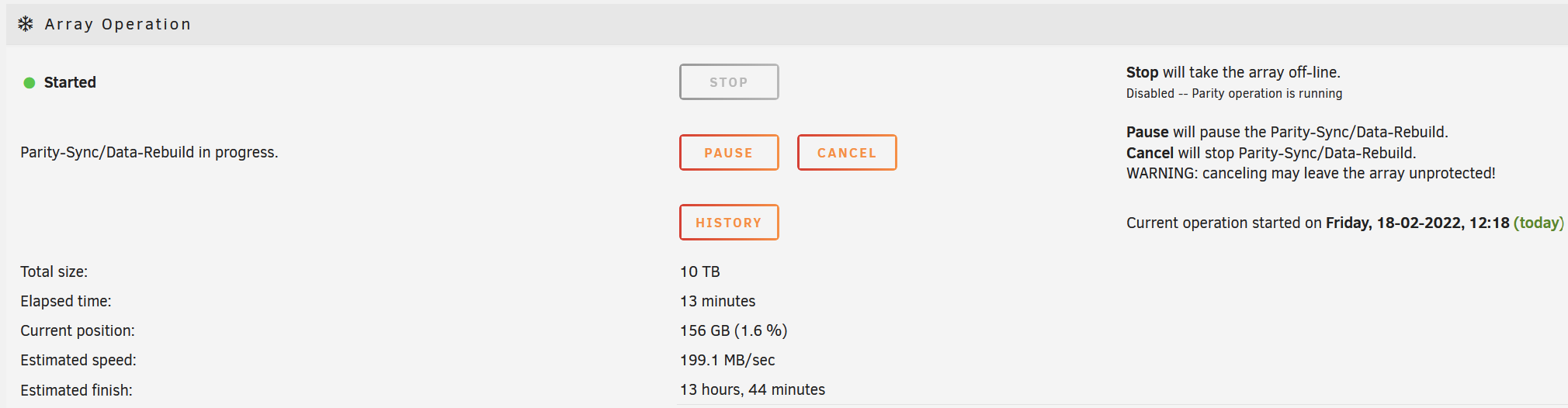

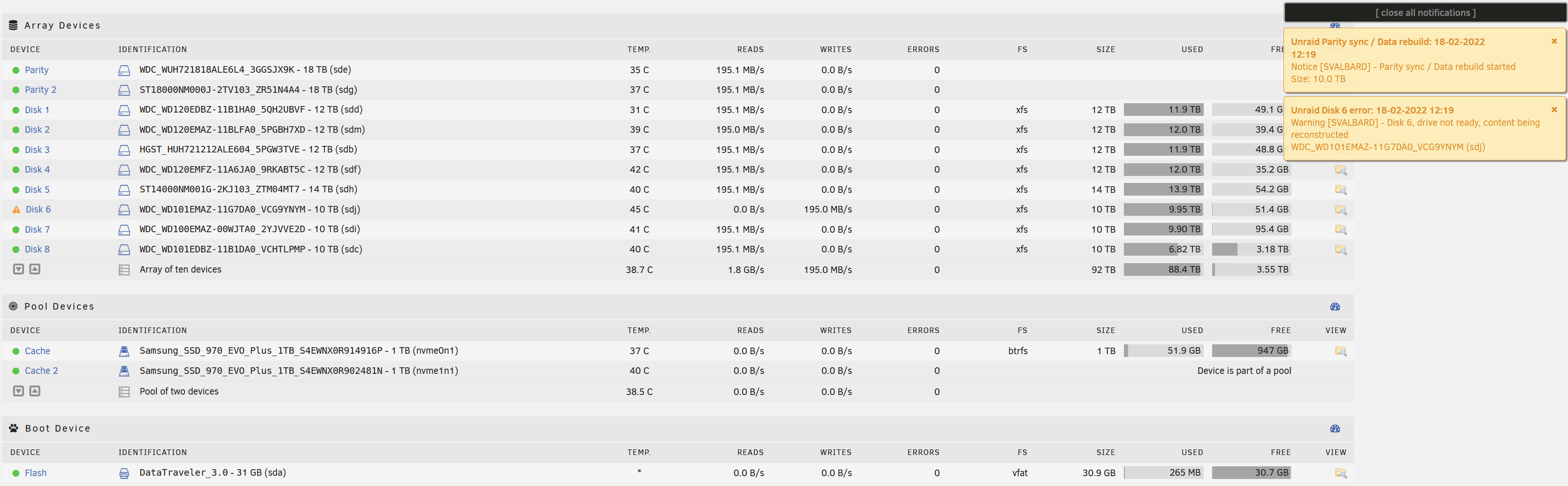

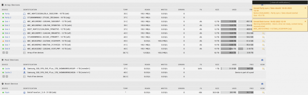

  13. I had another power cut again now, during the rebuild 🤬 Unbelievable! I will keep the server powered off until the electricity supply issues have been sorted out in my area. I will update this topic here later.
  14. I re-assigned the drive and looks like it's rebuilding now. Is that correct?
