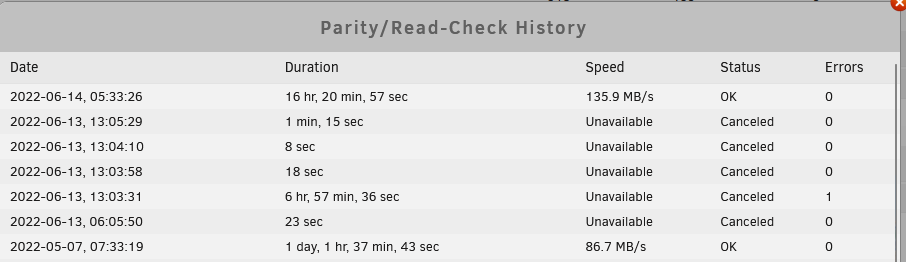

Thanks so much Jorge, let me get the whole log. All disks are XFS. I attached the whole diagnostic stack. I appreciate your reply and help. Let me know if I can provide anymore information. I also provided screenshot for times of the 1 sync error vs clean run. tower-diagnostics-20220615-1543.zip

Hey there everyone, I'm just wondering how / why this would occur. 8 disk array, dual parity, no cache. There was an unclean shutdown due to power issues (I have UPS, but don't have the automation setup to shutdown yet). There were no writes going on and disks were spun down. The next day, I ran parity check with correct disabled and it found 1 error about 60% of through. I read these forums and decided to cancel and restart the parity check with correct enabled. The parity check ran with no errors detected. What could a reason be why this happened? Should I be concerned? Here are lines related from the log: (suspect line Jun 13 07:06:23 Tower kernel: md: recovery thread: PQ incorrect, sector=807021208) Jun 13 06:05:27 Tower kernel: mdcmd (42): check Jun 13 06:05:27 Tower kernel: md: recovery thread: check P Q ... Jun 13 06:05:50 Tower kernel: mdcmd (43): nocheck Cancel Jun 13 06:05:50 Tower kernel: md: recovery thread: exit status: -4 Jun 13 06:05:55 Tower kernel: mdcmd (44): check nocorrect Jun 13 06:05:55 Tower kernel: md: recovery thread: check P Q ... Jun 13 06:08:57 Tower nmbd[6513]: [2022/06/13 06:08:57.865107, 0] ../../source3/nmbd/nmbd_become_lmb.c:397(become_local_master_stage2) Jun 13 06:08:57 Tower nmbd[6513]: ***** Jun 13 06:08:57 Tower nmbd[6513]: Jun 13 06:08:57 Tower nmbd[6513]: Samba name server TOWER is now a local master browser for workgroup HOME on subnet 192.168.122.1 Jun 13 06:08:57 Tower nmbd[6513]: Jun 13 06:08:57 Tower nmbd[6513]: ***** Jun 13 06:08:57 Tower nmbd[6513]: [2022/06/13 06:08:57.865228, 0] ../../source3/nmbd/nmbd_become_lmb.c:397(become_local_master_stage2) Jun 13 06:08:57 Tower nmbd[6513]: ***** Jun 13 06:08:57 Tower nmbd[6513]: Jun 13 06:08:57 Tower nmbd[6513]: Samba name server TOWER is now a local master browser for workgroup HOME on subnet 172.17.0.1 Jun 13 06:08:57 Tower nmbd[6513]: Jun 13 06:08:57 Tower nmbd[6513]: ***** Jun 13 07:06:23 Tower kernel: md: recovery thread: PQ incorrect, sector=807021208 Jun 13 13:03:31 Tower kernel: mdcmd (45): nocheck Cancel Jun 13 13:03:31 Tower kernel: md: recovery thread: exit status: -4 Jun 13 13:03:40 Tower kernel: mdcmd (46): check Jun 13 13:03:40 Tower kernel: md: recovery thread: check P Q ... Jun 13 13:03:58 Tower kernel: mdcmd (47): nocheck Cancel Jun 13 13:03:58 Tower kernel: md: recovery thread: exit status: -4 Jun 13 13:04:02 Tower kernel: mdcmd (48): check nocorrect Jun 13 13:04:02 Tower kernel: md: recovery thread: check P Q ... Jun 13 13:04:10 Tower kernel: mdcmd (49): nocheck Cancel Jun 13 13:04:10 Tower kernel: md: recovery thread: exit status: -4 Jun 13 13:04:14 Tower kernel: mdcmd (50): check Jun 13 13:04:14 Tower kernel: md: recovery thread: check P Q ... Jun 13 13:05:29 Tower kernel: mdcmd (51): nocheck Cancel Jun 13 13:05:29 Tower kernel: md: recovery thread: exit status: -4 Jun 13 13:12:29 Tower kernel: mdcmd (52): check Jun 13 13:12:29 Tower kernel: md: recovery thread: check P Q ... Any thoughts much appreciated. Thanks
