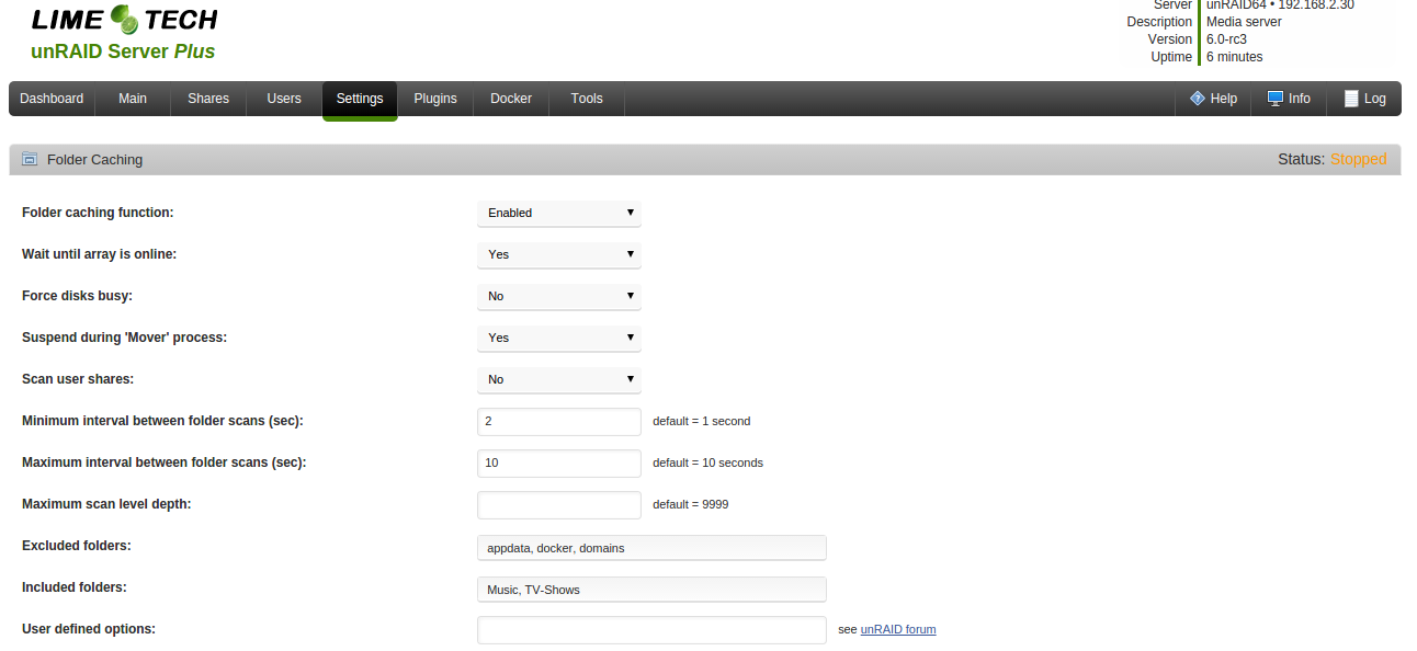

  7. I upgraded my test server to v6.0-rc3 and set up Dynamix Folder Caching only to find the status page in the GUI says it's stopped (see pix). Is this a reported problem? Any ideas about how to get it fixed? Thanks! EDIT.... I noticed some errors on the console screen after rebooting to the effect the Cache_Dirs.zip file was corrupt. Indeed it was so uninstalling and reinstalling did the trick and now it's running OK.
