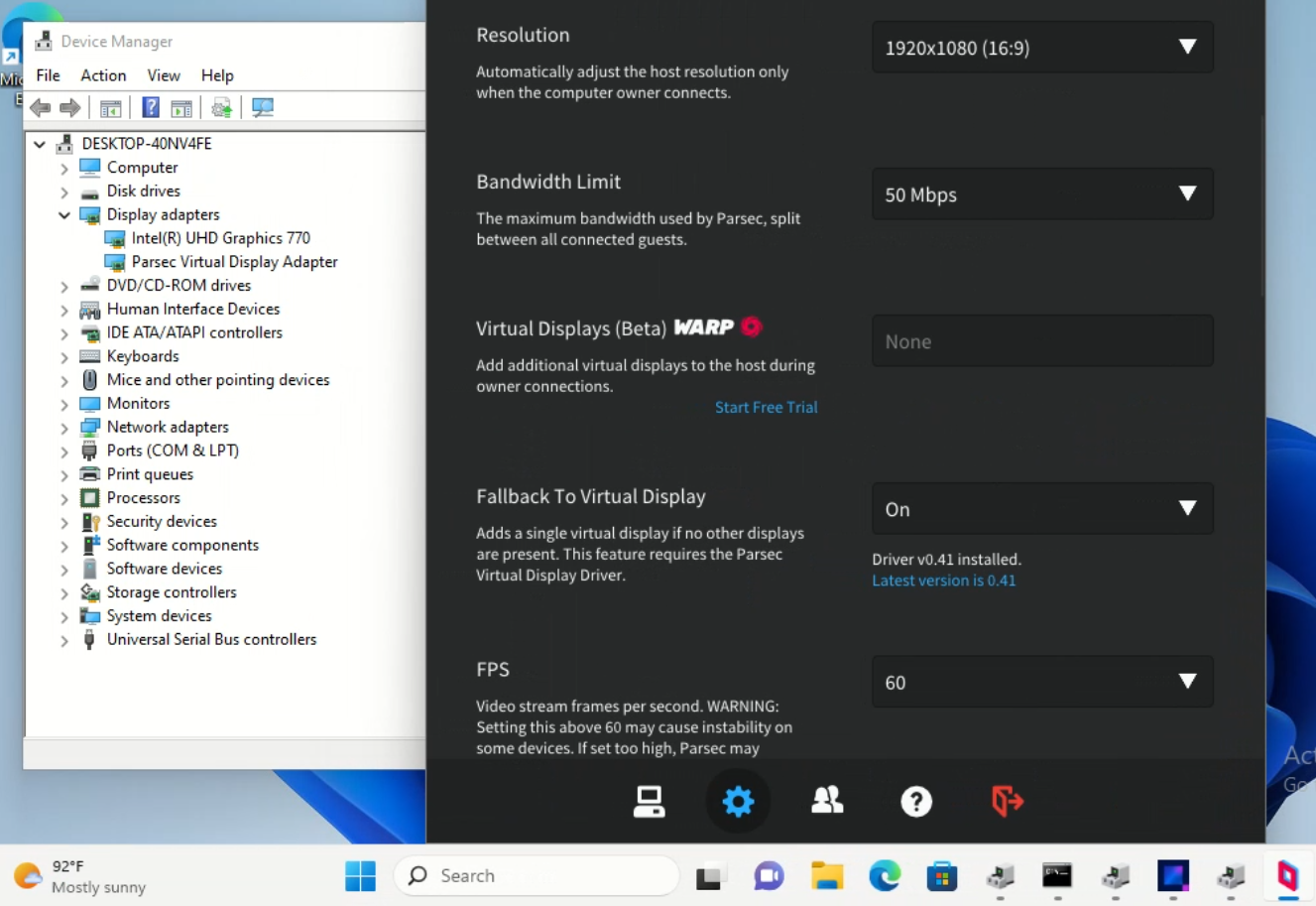

  1. Are you running a 5700 or a 5700g? The non g version doesn't have an iGPU.
  2. Unfortunately, still no joy. Here is a screenshot of parsec and my windows device manger. I am stumped. I appreciate you trying to assist.
  3. Thank you for your reply. I believe I have already done this. I installed the virtual display driver from parsec and then changed the parsec host setting to fallback to the virtual display. None of this worked. Is there anything else besides those two steps?
  4. I am currently running unraid 6.12.3 and have recently started playing around with this plugin. I have been able to passthrough one of the virtual gpu's to windows 11 and successfully install the drivers. However, parsec will not hardware encode the stream no matter what I do. The best I can get is software encoding, which obviously doesn't use the passthrough gpu. I have seen several other post stating they successfully have used parsec. Any help would be appreciated.
