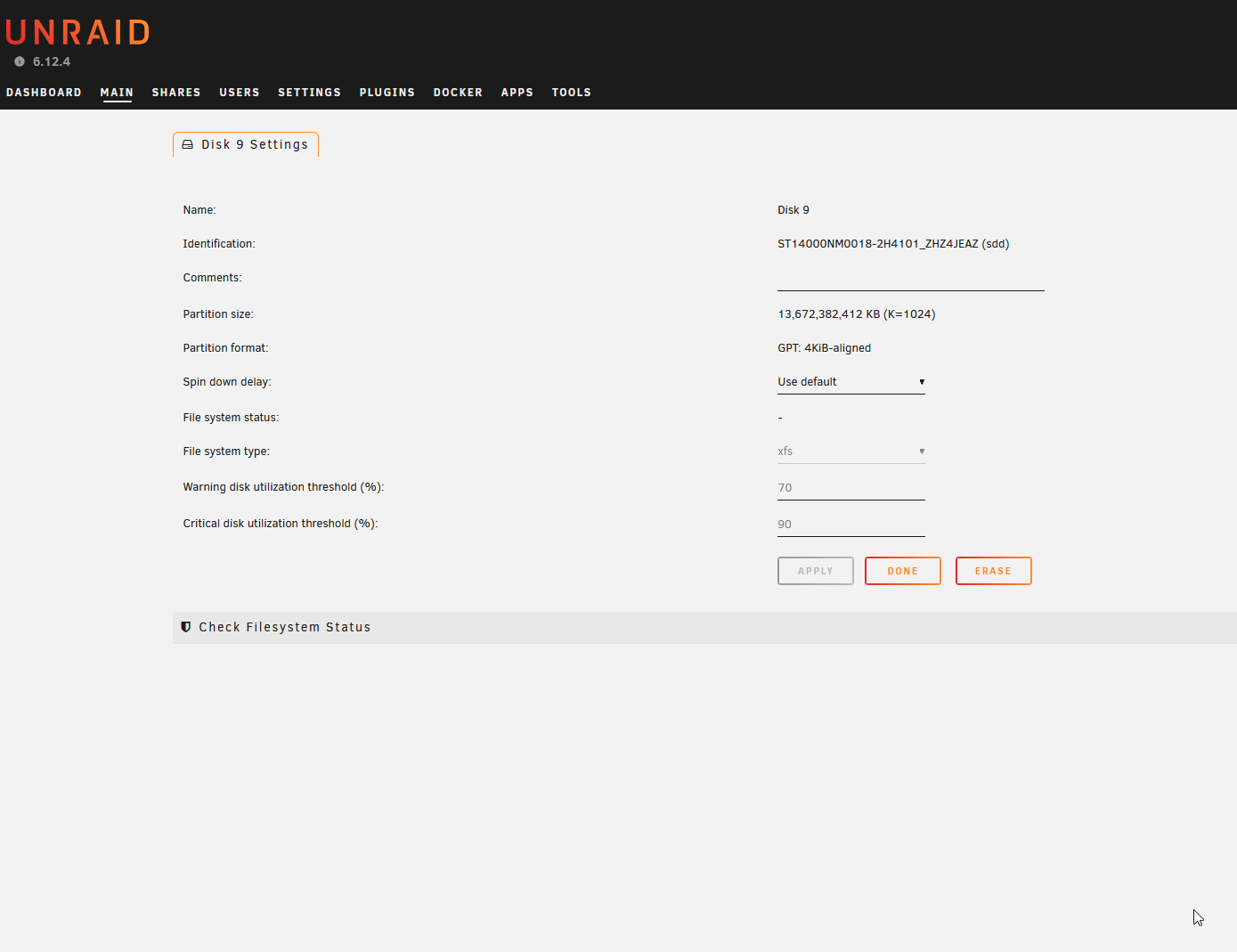

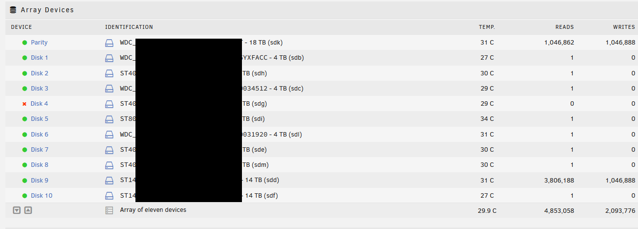

  1. @JorgeB thank you so much for all your assistance. Disk 9 is healthy and back in the array. Disk 4 is rebuilding from parity. I think it's something wrong with the SATA controller I have. I'm going to review https://forums.unraid.net/topic/102010-recommended-controllers-for-unraid/ to ensure I have a quality controller.
  2. I did notice that disk4. I haven't gotten around to figuring out what happened. Here's the output of the CLI run of xfs_repair. Is the next step to stop the array and restart it in normal mode? Phase 6 - check inode connectivity... - resetting contents of realtime bitmap and summary inodes - traversing filesystem ... - agno = 0 - agno = 1 - agno = 2 - agno = 3 - agno = 4 - agno = 5 - agno = 6 - agno = 7 - agno = 8 - agno = 9 - agno = 10 - agno = 11 - agno = 12 - traversal finished ... - moving disconnected inodes to lost+found ... Phase 7 - verify and correct link counts... XFS_REPAIR Summary Fri Nov 8 11:04:22 2024 Phase Start End Duration Phase 1: 11/08 10:58:39 11/08 10:58:39 Phase 2: 11/08 10:58:39 11/08 10:58:44 5 seconds Phase 3: 11/08 10:58:44 11/08 11:01:32 2 minutes, 48 seconds Phase 4: 11/08 11:01:32 11/08 11:01:33 1 second Phase 5: 11/08 11:01:33 11/08 11:01:39 6 seconds Phase 6: 11/08 11:01:39 11/08 11:04:21 2 minutes, 42 seconds Phase 7: 11/08 11:04:21 11/08 11:04:21 Total run time: 5 minutes, 42 seconds done
  3. @JorgeB thanks for all the help so far. I started running xfs_repair. I can't tell if it is finished or not. The read/write values haven't changed in about 20 minutes.
  4. I replaced the SATA cable on disk9. Attached are the logs and diagnostic after booting. tower-syslog-20241108-1410.zip tower-diagnostics-20241108-0810.zip

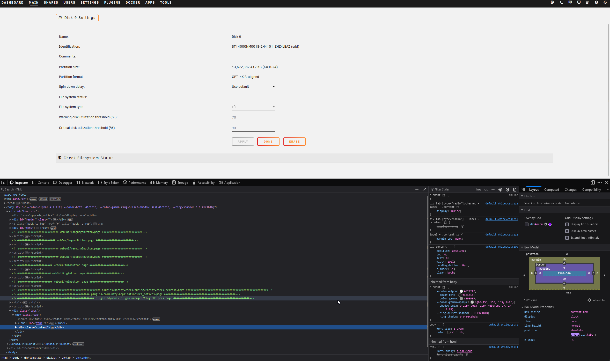

  5. I noticed this afternoon that one of the 10 disks in my pool changed to "Unmountable: Unsupported or no file system" I followed some of the conversation here: https://www.reddit.com/r/unRAID/comments/16z399w/unmountable_unsupported_or_no_file_system/ While running the xfs repair, the browser locked up because of how long the output was. When I reload the page, it no longer looks like it should. There doesn't seem to be anything going on as read/write totals on the main tab haven't changed in over an hour. In the logs, I found Nov 7 16:52:33 Tower kernel: XFS (md9p1): Corruption of in-memory data (0x8) detected at xfs_trans_cancel+0xd6/0x114 [xfs] (fs/xfs/xfs_trans.c:1098). Shutting down filesystem. Nov 7 16:52:33 Tower kernel: XFS (md9p1): Please unmount the filesystem and rectify the problem(s) Nov 7 16:52:33 Tower kernel: XFS (md9p1): Failed to recover intents Nov 7 16:52:33 Tower kernel: XFS (md9p1): Ending recovery (logdev: internal) Nov 7 16:52:33 Tower kernel: XFS (md9p1): log mount finish failed Nov 7 16:52:33 Tower root: mount: /mnt/disk9: mount(2) system call failed: Structure needs cleaning. Nov 7 16:52:33 Tower root: dmesg(1) may have more information after failed mount system call. Nov 7 16:52:33 Tower emhttpd: shcmd (74): exit status: 32 Nov 7 16:52:33 Tower emhttpd: /mnt/disk9 mount error: Unsupported or no file system Nov 7 16:52:33 Tower emhttpd: shcmd (75): rmdir /mnt/disk9 Nov 7 16:52:33 Tower emhttpd: mounting /mnt/disk10 Nov 7 16:52:33 Tower emhttpd: shcmd (76): mkdir -p /mnt/disk10 Nov 7 16:52:33 Tower emhttpd: shcmd (77): mount -t xfs -o noatime,nouuid /dev/md10p1 /mnt/disk10 Nov 7 16:52:33 Tower kernel: XFS (md10p1): Mounting V5 Filesystem Nov 7 16:52:33 Tower kernel: XFS (md10p1): Ending clean mount Nov 7 16:52:33 Tower kernel: xfs filesystem being mounted at /mnt/disk10 supports timestamps until 2038 (0x7fffffff) Nov 7 16:52:33 Tower emhttpd: shcmd (78): xfs_growfs /mnt/disk10 Nov 7 16:52:33 Tower root: meta-data=/dev/md10p1 isize=512 agcount=13, agsize=268435455 blks Nov 7 16:52:33 Tower root: = sectsz=512 attr=2, projid32bit=1 Nov 7 16:52:33 Tower root: = crc=1 finobt=1, sparse=1, rmapbt=0 Nov 7 16:52:33 Tower root: = reflink=1 bigtime=0 inobtcount=0 nrext64=0 Nov 7 16:52:33 Tower root: data = bsize=4096 blocks=3418095603, imaxpct=5 Nov 7 16:52:33 Tower root: = sunit=0 swidth=0 blks Nov 7 16:52:33 Tower root: naming =version 2 bsize=4096 ascii-ci=0, ftype=1 Nov 7 16:52:33 Tower root: log =internal log bsize=4096 blocks=521728, version=2 Nov 7 16:52:33 Tower root: = sectsz=512 sunit=0 blks, lazy-count=1 Nov 7 16:52:33 Tower root: realtime =none extsz=4096 blocks=0, rtextents=0 Nov 7 16:52:33 Tower emhttpd: mounting /mnt/cache Nov 7 16:52:33 Tower emhttpd: shcmd (79): mkdir -p /mnt/cache Nov 7 16:52:33 Tower emhttpd: shcmd (80): mount -t xfs -o noatime,nouuid /dev/sdj1 /mnt/cache Nov 7 16:52:33 Tower kernel: XFS (sdj1): Mounting V5 Filesystem Nov 7 16:52:33 Tower kernel: XFS (sdj1): Ending clean mount Nov 7 16:52:33 Tower emhttpd: shcmd (81): mount -o remount,discard /mnt/cache Nov 7 16:52:33 Tower emhttpd: mounting /mnt/torrentcache Nov 7 16:52:33 Tower emhttpd: shcmd (82): mkdir -p /mnt/torrentcache Nov 7 16:52:33 Tower emhttpd: shcmd (83): mount -t xfs -o noatime,nouuid /dev/nvme0n1p1 /mnt/torrentcache Nov 7 16:52:33 Tower kernel: XFS (nvme0n1p1): Mounting V5 Filesystem Nov 7 16:52:33 Tower kernel: XFS (nvme0n1p1): Ending clean mount Nov 7 16:52:33 Tower emhttpd: shcmd (84): mount -o remount,discard /mnt/torrentcache Nov 7 16:52:33 Tower emhttpd: shcmd (85): /usr/sbin/zfs mount -a Nov 7 16:52:33 Tower emhttpd: shcmd (86): sync Nov 7 16:52:34 Tower emhttpd: shcmd (87): mkdir /mnt/user0 Nov 7 16:52:34 Tower emhttpd: shcmd (88): /usr/local/bin/shfs /mnt/user0 -disks 2046 -o default_permissions,allow_other,noatime Nov 7 16:52:34 Tower shfs: FUSE library version 3.12.0 tower-syslog-20241108-0157.zip tower-diagnostics-20241107-1956.zip

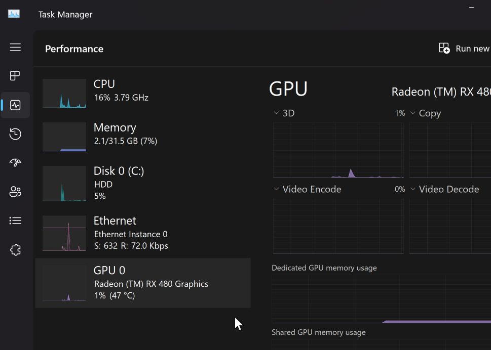

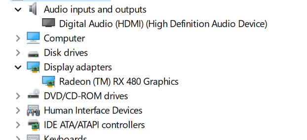

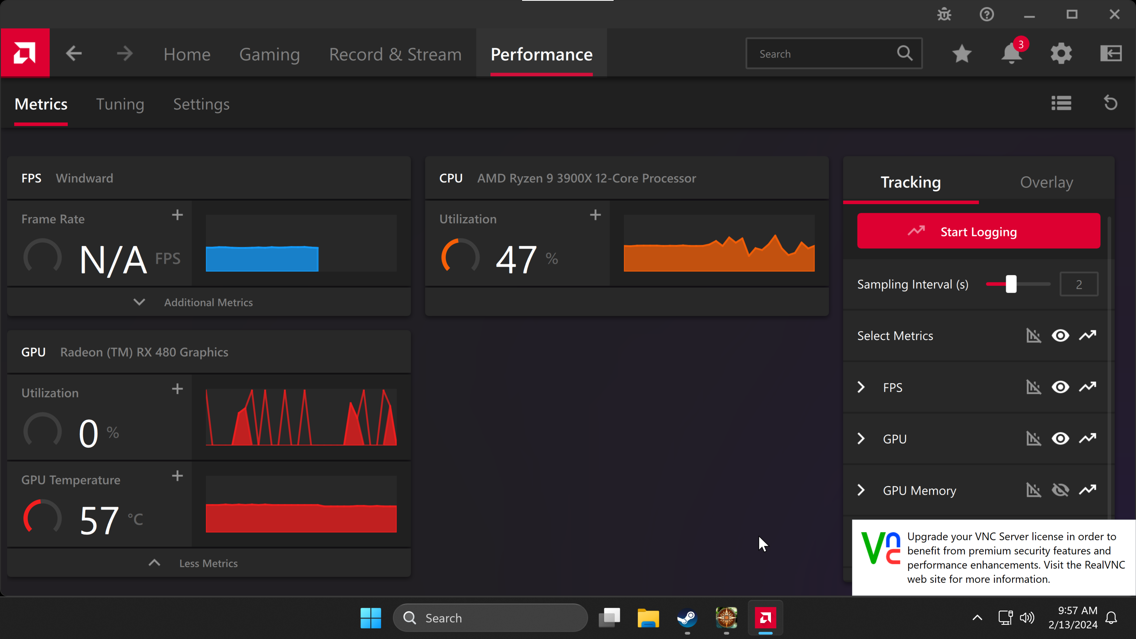

  6. Ok, I believe I have everything up and running. The final step was that the AMD "unified" driver package doesn't work. I download the driver specific to my card, and it seems like everything is working now. I have audio, and when I stream a game, it appears to be using the GPU. The graphics aren't stellar when streaming through moonlight and sunshine, but I'm sure I need to tweak some settings.

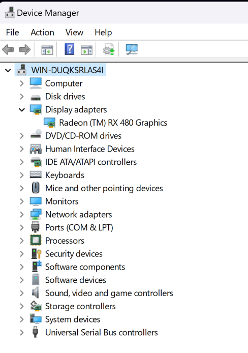

  7. Thanks! My bios needed flashed to get the latest features, including the "4g decoding" and "Re-size Bar." I have disabled both now. The Windows 11 VM boots and now has valid audio, but I still can't install AMD drivers.

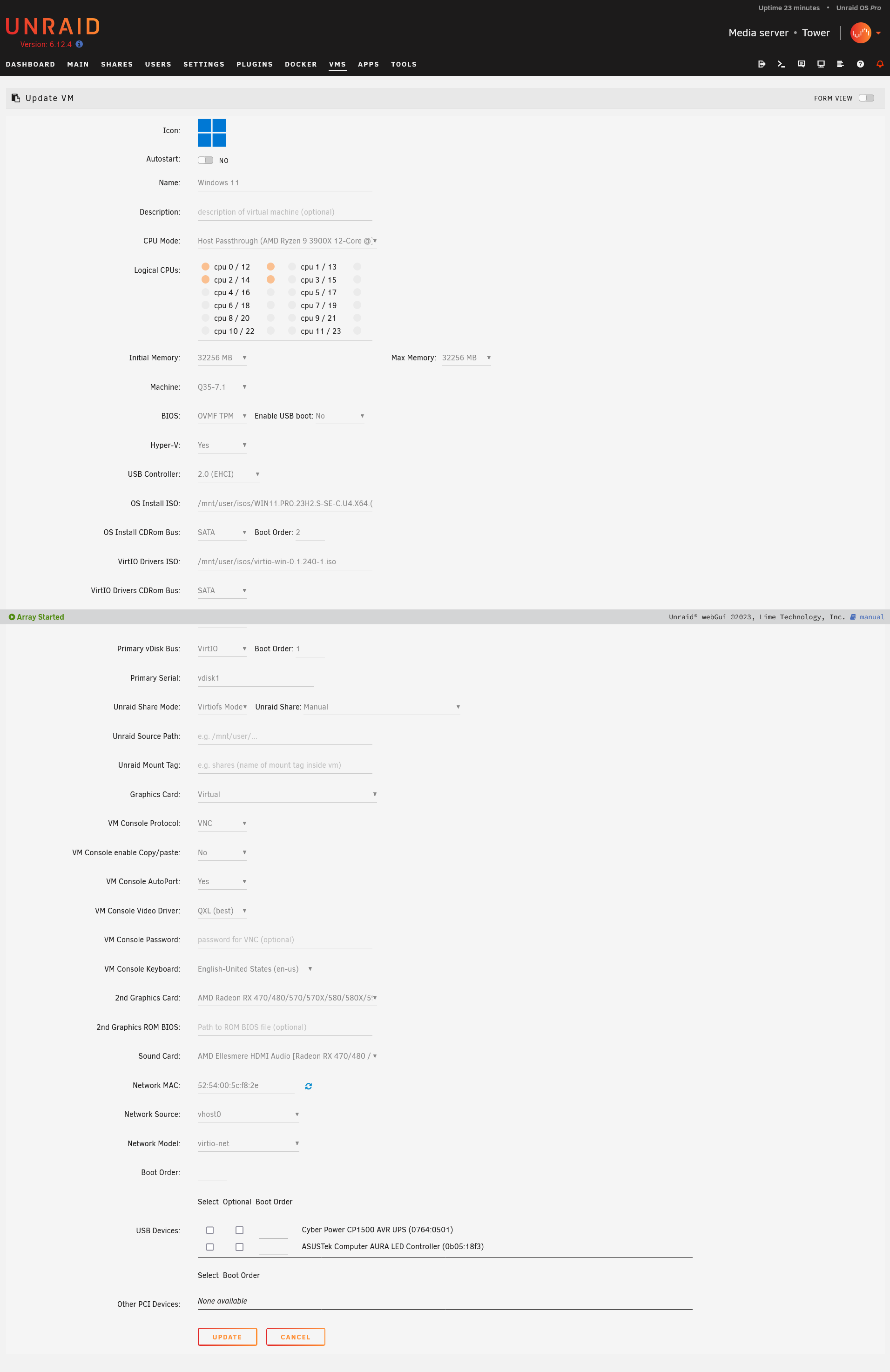

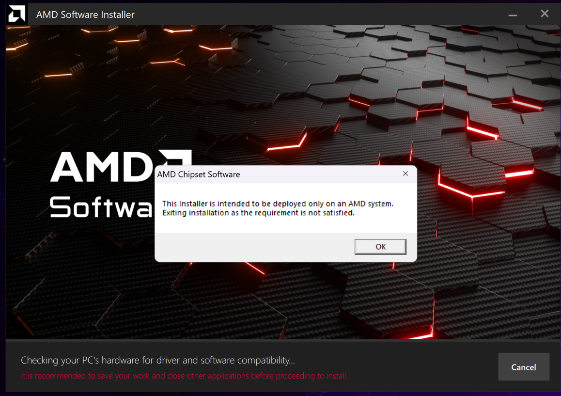

  10. I applied your recommended changes, and still can't install the AMD drivers. <?xml version='1.0' encoding='UTF-8'?> <domain type='kvm' id='17'> <name>Streamer</name> <uuid>cdf149ee-b40f-6ab3-05eb-9e97f54901cd</uuid> <metadata> <vmtemplate xmlns="unraid" name="Windows 11" icon="windows11.png" os="windowstpm"/> </metadata> <memory unit='KiB'>33030144</memory> <currentMemory unit='KiB'>33030144</currentMemory> <memoryBacking> <nosharepages/> </memoryBacking> <vcpu placement='static'>4</vcpu> <cputune> <vcpupin vcpu='0' cpuset='0'/> <vcpupin vcpu='1' cpuset='12'/> <vcpupin vcpu='2' cpuset='2'/> <vcpupin vcpu='3' cpuset='14'/> </cputune> <resource> <partition>/machine</partition> </resource> <os> <type arch='x86_64' machine='pc-q35-7.1'>hvm</type> <loader readonly='yes' type='pflash'>/usr/share/qemu/ovmf-x64/OVMF_CODE-pure-efi-tpm.fd</loader> <nvram>/etc/libvirt/qemu/nvram/cdf149ee-b40f-6ab3-05eb-9e97f54901cd_VARS-pure-efi-tpm.fd</nvram> </os> <features> <acpi/> <apic/> <hyperv mode='custom'> <relaxed state='on'/> <vapic state='on'/> <spinlocks state='on' retries='8191'/> <vendor_id state='on' value='none'/> </hyperv> </features> <cpu mode='host-passthrough' check='none' migratable='on'> <topology sockets='1' dies='1' cores='2' threads='2'/> <cache mode='passthrough'/> <feature policy='require' name='topoext'/> </cpu> <clock offset='localtime'> <timer name='hypervclock' present='yes'/> <timer name='hpet' present='no'/> </clock> <on_poweroff>destroy</on_poweroff> <on_reboot>restart</on_reboot> <on_crash>restart</on_crash> <devices> <emulator>/usr/local/sbin/qemu</emulator> <disk type='file' device='disk'> <driver name='qemu' type='raw' cache='writeback'/> <source file='/mnt/user/domains/Streamer/vdisk1.img' index='3'/> <backingStore/> <target dev='hdc' bus='virtio'/> <serial>vdisk1</serial> <boot order='1'/> <alias name='virtio-disk2'/> <address type='pci' domain='0x0000' bus='0x03' slot='0x00' function='0x0'/> </disk> <disk type='file' device='cdrom'> <driver name='qemu' type='raw'/> <source file='/mnt/user/isos/WIN11.PRO.23H2.S-SE-C.U4.X64.(WPE+).ISO' index='2'/> <backingStore/> <target dev='hda' bus='sata'/> <readonly/> <boot order='2'/> <alias name='sata0-0-0'/> <address type='drive' controller='0' bus='0' target='0' unit='0'/> </disk> <disk type='file' device='cdrom'> <driver name='qemu' type='raw'/> <source file='/mnt/user/isos/virtio-win-0.1.240-1.iso' index='1'/> <backingStore/> <target dev='hdb' bus='sata'/> <readonly/> <alias name='sata0-0-1'/> <address type='drive' controller='0' bus='0' target='0' unit='1'/> </disk> <controller type='usb' index='0' model='ich9-ehci1'> <alias name='usb'/> <address type='pci' domain='0x0000' bus='0x00' slot='0x07' function='0x7'/> </controller> <controller type='usb' index='0' model='ich9-uhci1'> <alias name='usb'/> <master startport='0'/> <address type='pci' domain='0x0000' bus='0x00' slot='0x07' function='0x0' multifunction='on'/> </controller> <controller type='usb' index='0' model='ich9-uhci2'> <alias name='usb'/> <master startport='2'/> <address type='pci' domain='0x0000' bus='0x00' slot='0x07' function='0x1'/> </controller> <controller type='usb' index='0' model='ich9-uhci3'> <alias name='usb'/> <master startport='4'/> <address type='pci' domain='0x0000' bus='0x00' slot='0x07' function='0x2'/> </controller> <controller type='sata' index='0'> <alias name='ide'/> <address type='pci' domain='0x0000' bus='0x00' slot='0x1f' function='0x2'/> </controller> <controller type='pci' index='0' model='pcie-root'> <alias name='pcie.0'/> </controller> <controller type='pci' index='1' model='pcie-root-port'> <model name='pcie-root-port'/> <target chassis='1' port='0x10'/> <alias name='pci.1'/> <address type='pci' domain='0x0000' bus='0x00' slot='0x02' function='0x0' multifunction='on'/> </controller> <controller type='pci' index='2' model='pcie-root-port'> <model name='pcie-root-port'/> <target chassis='2' port='0x11'/> <alias name='pci.2'/> <address type='pci' domain='0x0000' bus='0x00' slot='0x02' function='0x1'/> </controller> <controller type='pci' index='3' model='pcie-root-port'> <model name='pcie-root-port'/> <target chassis='3' port='0x12'/> <alias name='pci.3'/> <address type='pci' domain='0x0000' bus='0x00' slot='0x02' function='0x2'/> </controller> <controller type='pci' index='4' model='pcie-root-port'> <model name='pcie-root-port'/> <target chassis='4' port='0x13'/> <alias name='pci.4'/> <address type='pci' domain='0x0000' bus='0x00' slot='0x02' function='0x3'/> </controller> <controller type='pci' index='5' model='pcie-root-port'> <model name='pcie-root-port'/> <target chassis='5' port='0x14'/> <alias name='pci.5'/> <address type='pci' domain='0x0000' bus='0x00' slot='0x02' function='0x4'/> </controller> <controller type='pci' index='6' model='pcie-root-port'> <model name='pcie-root-port'/> <target chassis='6' port='0x15'/> <alias name='pci.6'/> <address type='pci' domain='0x0000' bus='0x00' slot='0x02' function='0x5'/> </controller> <controller type='virtio-serial' index='0'> <alias name='virtio-serial0'/> <address type='pci' domain='0x0000' bus='0x02' slot='0x00' function='0x0'/> </controller> <interface type='direct' trustGuestRxFilters='yes'> <mac address='52:54:00:aa:eb:57'/> <source dev='vhost0' mode='bridge'/> <target dev='macvtap15'/> <model type='virtio-net'/> <alias name='net0'/> <address type='pci' domain='0x0000' bus='0x01' slot='0x00' function='0x0'/> </interface> <serial type='pty'> <source path='/dev/pts/0'/> <target type='isa-serial' port='0'> <model name='isa-serial'/> </target> <alias name='serial0'/> </serial> <console type='pty' tty='/dev/pts/0'> <source path='/dev/pts/0'/> <target type='serial' port='0'/> <alias name='serial0'/> </console> <channel type='unix'> <source mode='bind' path='/var/lib/libvirt/qemu/channel/target/domain-17-Streamer/org.qemu.guest_agent.0'/> <target type='virtio' name='org.qemu.guest_agent.0' state='disconnected'/> <alias name='channel0'/> <address type='virtio-serial' controller='0' bus='0' port='1'/> </channel> <input type='tablet' bus='usb'> <alias name='input0'/> <address type='usb' bus='0' port='1'/> </input> <input type='mouse' bus='ps2'> <alias name='input1'/> </input> <input type='keyboard' bus='ps2'> <alias name='input2'/> </input> <tpm model='tpm-tis'> <backend type='emulator' version='2.0' persistent_state='yes'/> <alias name='tpm0'/> </tpm> <graphics type='vnc' port='5900' autoport='yes' websocket='5700' listen='0.0.0.0' keymap='en-us'> <listen type='address' address='0.0.0.0'/> </graphics> <audio id='1' type='none'/> <video> <model type='qxl' ram='65536' vram='65536' vgamem='16384' heads='1' primary='yes'/> <alias name='video0'/> <address type='pci' domain='0x0000' bus='0x00' slot='0x01' function='0x0'/> </video> <hostdev mode='subsystem' type='pci' managed='yes'> <driver name='vfio'/> <source> <address domain='0x0000' bus='0x0b' slot='0x00' function='0x0'/> </source> <alias name='hostdev0'/> <address type='pci' domain='0x0000' bus='0x04' slot='0x00' function='0x0' multifunction='on'/> </hostdev> <hostdev mode='subsystem' type='pci' managed='yes'> <driver name='vfio'/> <source> <address domain='0x0000' bus='0x0b' slot='0x00' function='0x1'/> </source> <alias name='hostdev1'/> <address type='pci' domain='0x0000' bus='0x04' slot='0x00' function='0x1'/> </hostdev> <memballoon model='none'/> </devices> <seclabel type='dynamic' model='dac' relabel='yes'> <label>+0:+100</label> <imagelabel>+0:+100</imagelabel> </seclabel> </domain>
  11. Something I have noticed, is that if I configure the VM from the start to have the primary graphics card as Virtual, and the AMD GPU as secondary, the XML for the VM contains a <graphics> and a <video> block. <graphics> for the Virtual and <video> for the GPU. But, if I create a new VM and only associate the GPU, no Virtual, then I get neither the <graphics> nor the <video> block, as seen below. <?xml version='1.0' encoding='UTF-8'?> <domain type='kvm'> <name>Windows 11</name> <uuid>8fc51eea-8800-c6be-6de2-c4d63d111eaf</uuid> <metadata> <vmtemplate xmlns="unraid" name="Windows 11" icon="windows11.png" os="windowstpm"/> </metadata> <memory unit='KiB'>4194304</memory> <currentMemory unit='KiB'>4194304</currentMemory> <memoryBacking> <nosharepages/> </memoryBacking> <vcpu placement='static'>4</vcpu> <cputune> <vcpupin vcpu='0' cpuset='0'/> <vcpupin vcpu='1' cpuset='12'/> <vcpupin vcpu='2' cpuset='2'/> <vcpupin vcpu='3' cpuset='14'/> </cputune> <os> <type arch='x86_64' machine='pc-q35-7.1'>hvm</type> <loader readonly='yes' type='pflash'>/usr/share/qemu/ovmf-x64/OVMF_CODE-pure-efi-tpm.fd</loader> <nvram>/etc/libvirt/qemu/nvram/8fc51eea-8800-c6be-6de2-c4d63d111eaf_VARS-pure-efi-tpm.fd</nvram> </os> <features> <acpi/> <apic/> <hyperv mode='custom'> <relaxed state='on'/> <vapic state='on'/> <spinlocks state='on' retries='8191'/> <vendor_id state='on' value='none'/> </hyperv> </features> <cpu mode='host-passthrough' check='none' migratable='on'> <topology sockets='1' dies='1' cores='2' threads='2'/> <cache mode='passthrough'/> <feature policy='require' name='topoext'/> </cpu> <clock offset='localtime'> <timer name='hypervclock' present='yes'/> <timer name='hpet' present='no'/> </clock> <on_poweroff>destroy</on_poweroff> <on_reboot>restart</on_reboot> <on_crash>restart</on_crash> <devices> <emulator>/usr/local/sbin/qemu</emulator> <disk type='file' device='disk'> <driver name='qemu' type='raw' cache='writeback'/> <source file='/mnt/user/domains/Windows 11/vdisk1.img'/> <target dev='hdc' bus='virtio'/> <serial>vdisk1</serial> <boot order='1'/> <address type='pci' domain='0x0000' bus='0x03' slot='0x00' function='0x0'/> </disk> <disk type='file' device='cdrom'> <driver name='qemu' type='raw'/> <source file='/mnt/user/isos/WIN11.PRO.23H2.S-SE-C.U4.X64.(WPE+).ISO'/> <target dev='hda' bus='sata'/> <readonly/> <boot order='2'/> <address type='drive' controller='0' bus='0' target='0' unit='0'/> </disk> <disk type='file' device='cdrom'> <driver name='qemu' type='raw'/> <source file='/mnt/user/isos/virtio-win-0.1.240-1.iso'/> <target dev='hdb' bus='sata'/> <readonly/> <address type='drive' controller='0' bus='0' target='0' unit='1'/> </disk> <controller type='usb' index='0' model='ich9-ehci1'> <address type='pci' domain='0x0000' bus='0x00' slot='0x07' function='0x7'/> </controller> <controller type='usb' index='0' model='ich9-uhci1'> <master startport='0'/> <address type='pci' domain='0x0000' bus='0x00' slot='0x07' function='0x0' multifunction='on'/> </controller> <controller type='usb' index='0' model='ich9-uhci2'> <master startport='2'/> <address type='pci' domain='0x0000' bus='0x00' slot='0x07' function='0x1'/> </controller> <controller type='usb' index='0' model='ich9-uhci3'> <master startport='4'/> <address type='pci' domain='0x0000' bus='0x00' slot='0x07' function='0x2'/> </controller> <controller type='sata' index='0'> <address type='pci' domain='0x0000' bus='0x00' slot='0x1f' function='0x2'/> </controller> <controller type='pci' index='0' model='pcie-root'/> <controller type='virtio-serial' index='0'> <address type='pci' domain='0x0000' bus='0x02' slot='0x00' function='0x0'/> </controller> <controller type='pci' index='1' model='pcie-root-port'> <model name='pcie-root-port'/> <target chassis='1' port='0x8'/> <address type='pci' domain='0x0000' bus='0x00' slot='0x01' function='0x0' multifunction='on'/> </controller> <controller type='pci' index='2' model='pcie-root-port'> <model name='pcie-root-port'/> <target chassis='2' port='0x9'/> <address type='pci' domain='0x0000' bus='0x00' slot='0x01' function='0x1'/> </controller> <controller type='pci' index='3' model='pcie-root-port'> <model name='pcie-root-port'/> <target chassis='3' port='0xa'/> <address type='pci' domain='0x0000' bus='0x00' slot='0x01' function='0x2'/> </controller> <controller type='pci' index='4' model='pcie-root-port'> <model name='pcie-root-port'/> <target chassis='4' port='0xb'/> <address type='pci' domain='0x0000' bus='0x00' slot='0x01' function='0x3'/> </controller> <controller type='pci' index='5' model='pcie-root-port'> <model name='pcie-root-port'/> <target chassis='5' port='0xc'/> <address type='pci' domain='0x0000' bus='0x00' slot='0x01' function='0x4'/> </controller> <controller type='pci' index='6' model='pcie-root-port'> <model name='pcie-root-port'/> <target chassis='6' port='0xd'/> <address type='pci' domain='0x0000' bus='0x00' slot='0x01' function='0x5'/> </controller> <interface type='direct' trustGuestRxFilters='yes'> <mac address='52:54:00:12:20:d5'/> <source dev='vhost0' mode='bridge'/> <model type='virtio-net'/> <address type='pci' domain='0x0000' bus='0x01' slot='0x00' function='0x0'/> </interface> <serial type='pty'> <target type='isa-serial' port='0'> <model name='isa-serial'/> </target> </serial> <console type='pty'> <target type='serial' port='0'/> </console> <channel type='unix'> <target type='virtio' name='org.qemu.guest_agent.0'/> <address type='virtio-serial' controller='0' bus='0' port='1'/> </channel> <input type='mouse' bus='ps2'/> <input type='keyboard' bus='ps2'/> <tpm model='tpm-tis'> <backend type='emulator' version='2.0' persistent_state='yes'/> </tpm> <audio id='1' type='none'/> <hostdev mode='subsystem' type='pci' managed='yes'> <driver name='vfio'/> <source> <address domain='0x0000' bus='0x0b' slot='0x00' function='0x0'/> </source> <address type='pci' domain='0x0000' bus='0x04' slot='0x00' function='0x0'/> </hostdev> <hostdev mode='subsystem' type='pci' managed='yes'> <driver name='vfio'/> <source> <address domain='0x0000' bus='0x0b' slot='0x00' function='0x1'/> </source> <address type='pci' domain='0x0000' bus='0x05' slot='0x00' function='0x0'/> </hostdev> <memballoon model='none'/> </devices> </domain>
  12. I deleted the entire VM and started again, this time with an HDMI cable plugged into a monitor. The results are the same. I can't install AMD drivers and it says no audio output device.

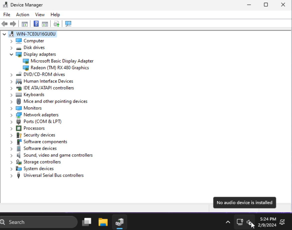

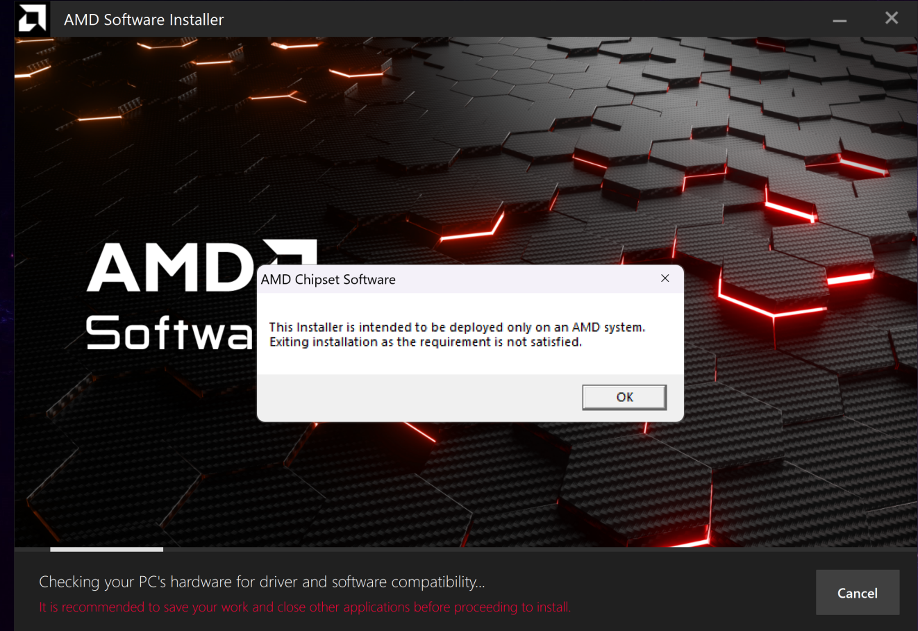

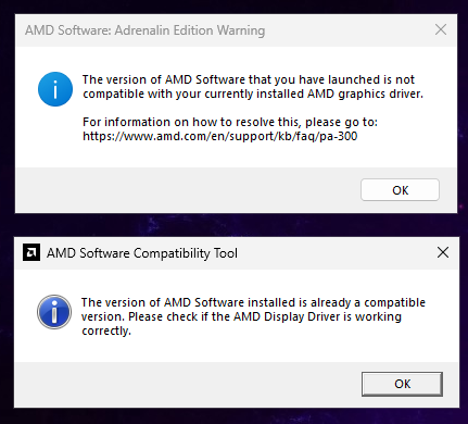

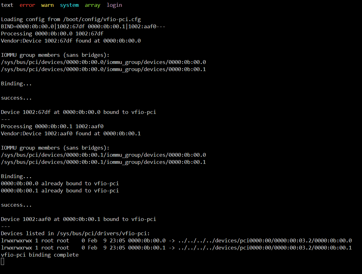

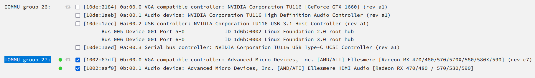

  13. I do not have anything connected to the GPU. I plan on using it for game streaming via Sunshine/Moonlight. I haven't installed any of the game streaming stuff, as I'm waiting until I figure out the GPU drivers. Good to know though that it will say no audio device installed until I plugin a monitor. Shouldn't it at least list an audio device in the Device Manager though?
