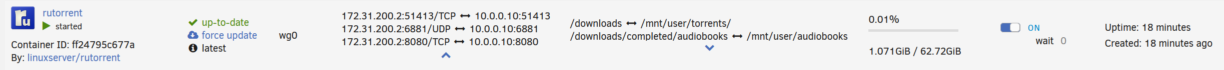

I gave up and installed a different version of a Docker app for rutorrent as the one I was using hadn't been updated in years. The new container can be accessed via its local network IP.

I recently went through the process of upgrading my server to the latest release of unraid. This introduced the newer “VPN tunneled access for docker” option. I have reconfigured my rutorrent container to use the newly created wg0 network type. Unfortunately, it seems as if I can't access the rutorrent web gui anymore at 10.0.0.10:8080. I assume this is because the rutorrent container is set to only have access to networking via the WireGuard VPN, which removes it from my local 10.0.0.x network? According to my attached screenshot, it seems like the container has internet access.
