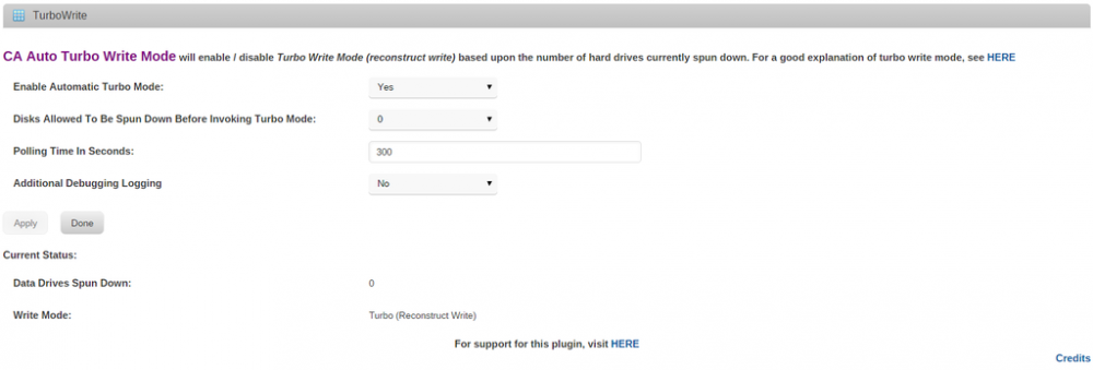

CA Auto Turbo Write Mode
A simple plugin which will automatically enable or disable Turbo Write Mode (aka reconstruct write mode) based upon the number of drives which are currently spinning.
Turbo Write Mode can significantly increase the write speed to your protected array (my system it doubles it).  See This Post for a discussion about it.  Note that unRaid's setting of Automatic does not enable / disable turbo mode based upon the number of drives spinning.  unRaid's setting of "Automatic" simply disables turbo write mode.
CA Auto Turbo Mode also has a feature where you can enable or disable Turbo Mode on a set schedule.  For instance to always to have it enabled when mover runs, etc.
Full help text is available within the plugin
Install it via the Apps tab (Community Applications).  Either search for turbo or you can also find it within the Additional CA Modules section

Is there a suggested number for "Disks Allowed To Be Spun Down Before Invoking Turbo Mode:"? I have 3 Cache SSD's Disks, 6 Data HDD and 1 Parity HDD. Current spindown time is set to 30 minutes
Thanks.
Thanks.
Set it to however many disks you want to spin up when a write happens (turbo mode all disks have to be spinning)...  Really up to you and no recommended setting
