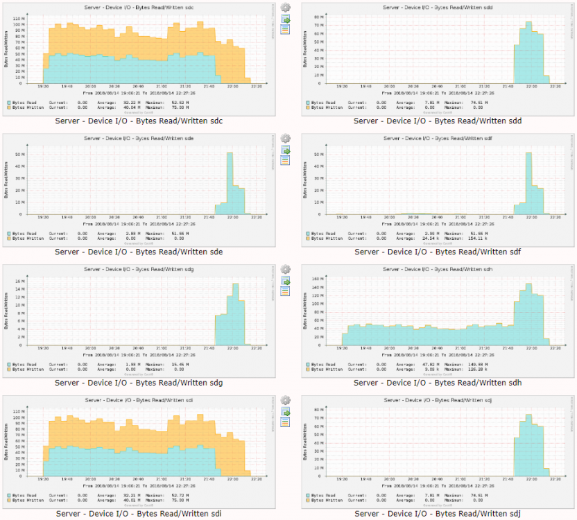

    With a parity disk active (write corrections on), cache off, copying one TB of small files to a share over gigabit ethernet from a USB 3.0 drive I was getting 10-15MB/s... I paused the transfer, selec
