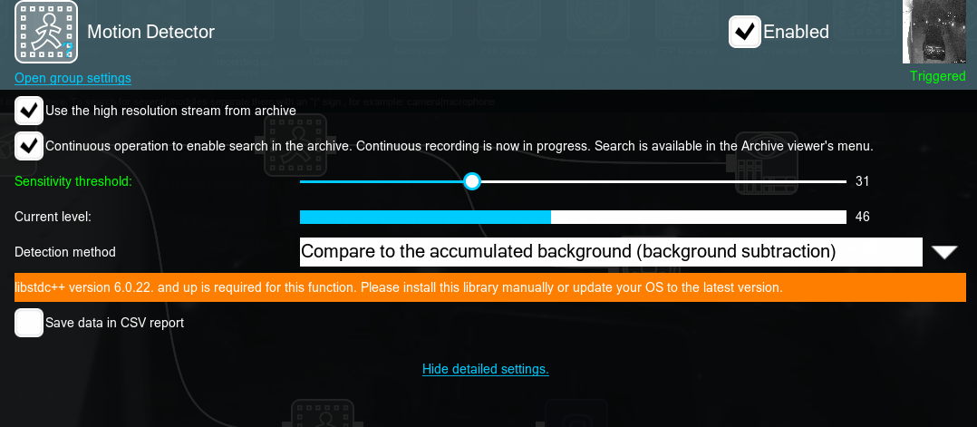

  4. What is the current state of this container? It appears that @coppit is no longer maintaining it, so has anyone forked it and make any updates? I noticed that Archive Search is no longer functioning, and my Motion Detector is now complaining about not having the a new enough library. My guess is this is a dependency that just needs to be updated in the dockerfile, but I'm not sure.
