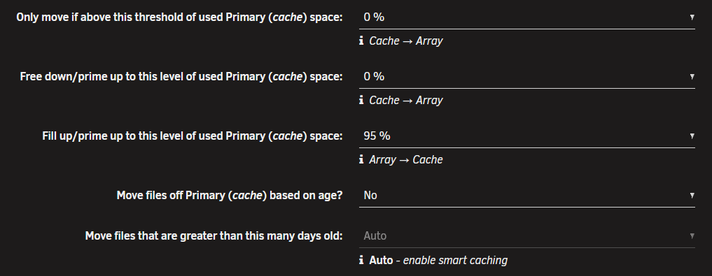

  3. I'm having a similar issue. Except I have my schedule set for once at day at 1am. I have it set to move everything off that it can. (See settings below.) The mover is running in my case. For instance, last night it ran for 30 minutes. I have disabled the built in mover schedule.
