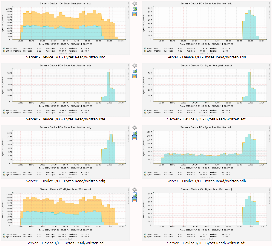

I turned on turbo/reconstruct-write part way through a 600GB move from one disk to another, and this is what I got in stats. Roughly twice the write throughput
Cacti graphs:
sdc is parity
sdh is the source disk
sdi is the destination disk
Edited by koyaanisqatsi
Cacti graphs:
sdc is parity
How do you generate these graphics?
