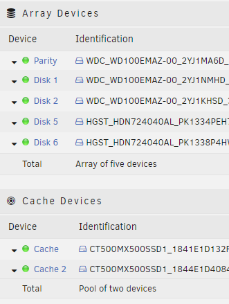

I have a similar issue: 4 drives shown as spun down even though the MAIN tab has them spun up.
image.png.d01f5c2f8183a5c9f1b7783dd861cd7b.pngimage.png.e5164684f84f917eac64ee25e9eb4333.png
I enabled debug logging and shortened the polling time. I also issued the spin up command to no avail.

What might help is those 4 disks (1/2/5/6) are on a Dell H310 Perc in IT Mode. The card has never given me trouble otherwise. Here is hdparm and it recognizes my cache drives as being active (on Intel Chipset) but not the drives on the H310:

Think I'm just SOL because of the H310?

Also the plugin is indicating I have 2 spun down drives, but all my drives spun up and none of them never spin down so I would rather uninstall the utility but want to make sure I have the correct syntax and placement of the command in the GO file. Thanks.
No need to do it in the go file. Go to Settings -> Disk settings and change "Tunable (md_write_method)" from "Auto" to "reconstruct write".
Damn, so many options and settings all over I miss them easily. Thanks for pointing that out. After I work on my media player read speed tests for a bit I'll make that change and be done with it. :)
Thanks!
