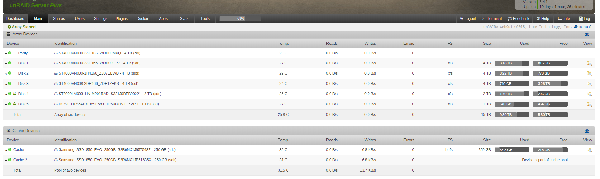

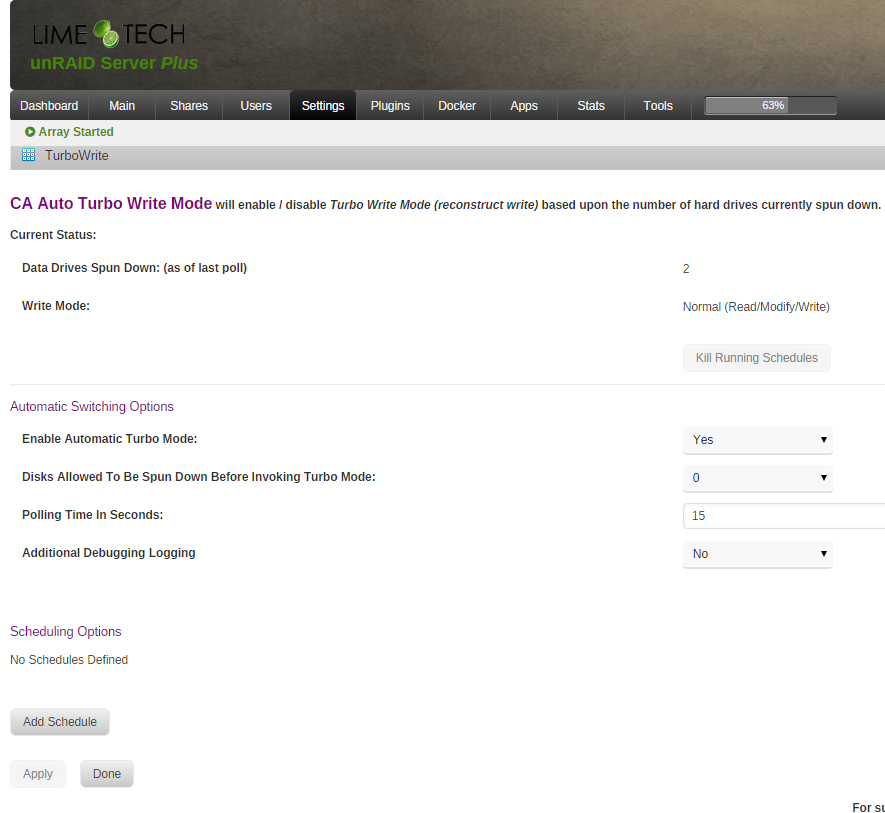

I just installed this plugin for the first time (I'm on unRAID 6.4.1), but it doesn't seem to detect that my drives are spun up when they are. Specifically, it thinks that two of them are down when all of them are up (I invoked the spin up command). I've waited more than the polling period, but it doesn't climb higher than 2.
Two of my disks are encrypted - could it be related to that?
Screenshots attached.
Can you temporarily enable debug logging, spin up all the drives, wait for the polling period to finish a couple of times, and then upload your diagnostics.  After that, disable debug logging as it'll really spam your syslog
Interesting... to give you less to wade through in the log, I thought I'd reboot the machine to clear it before sending the diags, and after reboot, the script correctly detected that all disks were spun up, and turbo mode was enabled.
But a few seconds later, it incorrectly thought that one disk was spun down, so then disabled it.
Unfortunately, I didn't think to enable debug logging *before* I rebooted, so didn't enable it in time to catch this behaviour.
I'm happy to reboot again if it helps get to the bottom of the problem.
I've attached my diags, generated about 2 minutes or so after enabling debug (I have a 15 second time out). By this time the 'spun down' count had risen to 2 again.
percy-diagnostics-20180224-1133.zip
Just an update: it's now detecting that all disks are spun up again.
...and then to 1 disk spun down again.
Latest diags attached.
percy-diagnostics-20180224-1159.zip
When the drives are spun up, it is returning active/idle from
hdparm -C /dev/sdX
Its a hair strange though that the command returns unknown when its spundown (I'm assuming).  Usually it states standby
Can you spindown all the drives and rerun the test?
My option here is that when it states "unknown" is to either assume thats its up or down or ignore it.  Currently I'm assuming anything other than "active" means spundown.
Unknown is only supposed to be returned when the drive doesn't support the command.  But it clearly does since the drives bounce between active/idle and unknown
Side Note:  I think that running this every 15 seconds is way way overkill
Edited by Squid
Ok, attached is my latest diagnostics, taken after all 5 disks were confirmed spun down.
I realised that I'd forgotten to disable the logging on CA Auto Turbo after I enabled it a few days ago, so sorry if they're a bit hefty in content.
percy-diagnostics-20180226-1523.zip
Just a quick note that after I uploaded this file, I went to change the polling time to 90 seconds and I noticed that it was reporting that only 2 disks were spun down, even though all my disks were spun down.
So I re-generated the diagnostics, in case something interesting happened in the intervening time since I last uploaded them.
percy-diagnostics-20180226-1527.zip
