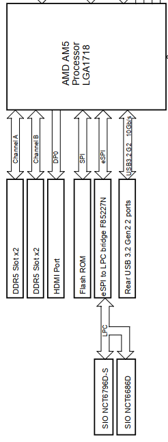

  3. Same with a Asrock X670E Taichi + 7950x I get no sensor detected when I run sensors-detect from the shell. I was able to manually configure the drivers.conf file for the Dynamic System Temp plugin and placed k10temp and nct6775 in it. But only k10temp, nvme, and amdgpu sensors show in the dropdown list. According to the manual (page 11) it shows that they are using chips NCT6796D-S and NCT6686D. Are these supported by nct6775? If I try to run "modprobe nct6775" from the shell I get "modprobe: ERROR: could not insert 'nct6775': no such device"
