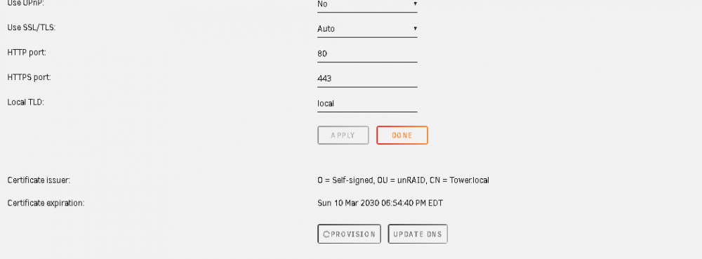

December 26, 20205 yr Hi I am trying to encrypt my disks, but first according to space invaders i need to get HTTPS. when I Provision it keeps spinning and nothing happens! i have been waiting for more then half an hour. no error so far what should i do? ssl is set to auto Edited December 26, 20205 yr by ssinseeme

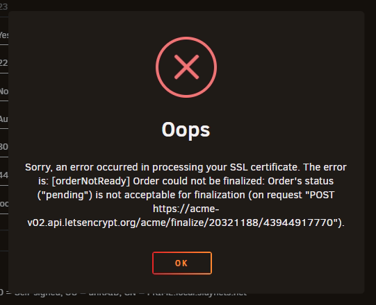

November 24, 20215 yr Did some further testing by swapping out the flash drive, since for this build I was still using the trial key. Still got the same issue. I updated to 6.10.0-rc2 and then tried again, still the same issue. But the system log revealed something with 6.10 that did not exist in 6.9. Below is the excerpt from the log: Nov 24 09:09:17 PRIME emhttpd: shcmd (114): /usr/bin/php -f /usr/local/emhttp/webGui/include/ProvisionCert.php Nov 24 09:09:17 PRIME root: Error: Server was unable to provision SSL certificate Nov 24 09:09:17 PRIME emhttpd: shcmd (114): exit status: 1 Nov 24 09:09:17 PRIME emhttpd: shcmd (115): /etc/rc.d/rc.nginx reload Nov 24 09:09:17 PRIME root: Checking configuration for correct syntax and Nov 24 09:09:17 PRIME root: then trying to open files referenced in configuration... Nov 24 09:09:17 PRIME root: nginx: the configuration file /etc/nginx/nginx.conf syntax is ok Nov 24 09:09:17 PRIME root: nginx: configuration file /etc/nginx/nginx.conf test is successful Nov 24 09:09:17 PRIME root: Reloading Nginx configuration... Nov 24 09:09:20 PRIME nginx: 2021/11/24 09:09:20 [alert] 2269#2269: *9524 open socket #26 left in connection 8 Nov 24 09:09:20 PRIME nginx: 2021/11/24 09:09:20 [alert] 2269#2269: *9522 open socket #18 left in connection 10 Nov 24 09:09:20 PRIME nginx: 2021/11/24 09:09:20 [alert] 2269#2269: *9512 open socket #13 left in connection 16 Nov 24 09:09:20 PRIME nginx: 2021/11/24 09:09:20 [alert] 2269#2269: aborting The second line says it was not able to provision the cert. Do not know if this is a bug or if the unRAID provision site (https://keys.lime-technology.com/account/ssl/provisioncert) has an issue. Got the site URL from looking through the php file from the first line in the log excerpt above. Should this be reported as a bug?

December 2, 20214 yr Would you please try it again? Let's Encrypt had an incident around that time: https://letsencrypt.status.io/
December 3, 20214 yr 18 hours ago, ljm42 said: Would you please try it again? Let's Encrypt had an incident around that time: https://letsencrypt.status.io/ @ljm42 Is there anything else I can try to resolve this?
December 3, 20214 yr 4 minutes ago, StanC said: @ljm42 Is there anything else I can try to resolve this? We haven't seen this before and are looking into it. The (sort of) good news is that this doesn't appear to be a widespread problem, I have a feeling your specific certificate request got borked during their outage yesterday. We're trying to figure out how to reset it.
December 6, 20214 yr On 12/3/2021 at 8:37 AM, ljm42 said: We haven't seen this before and are looking into it. The (sort of) good news is that this doesn't appear to be a widespread problem, I have a feeling your specific certificate request got borked during their outage yesterday. We're trying to figure out how to reset it. @ljm42 I am not apposed to this, since this is a brand new build with nothing on it. But would it help if I restart with a clean build (fresh copy of unRAID OS, new server name, etc.)? Or is it that my email address is being blocked by LetsEncrypt? Edited December 7, 20214 yr by StanC
December 8, 20214 yr I don't think there is really anything to be done on your end. But I do see that Let's Encrypt has some maintenance coming up on Dec 8th and 9th, I'm hoping that will help: https://letsencrypt.status.io/
December 11, 20214 yr On 12/7/2021 at 4:01 PM, ljm42 said: I don't think there is really anything to be done on your end. But I do see that Let's Encrypt has some maintenance coming up on Dec 8th and 9th, I'm hoping that will help: https://letsencrypt.status.io/ @ljm42 I have finally got it working 😀 I did end up recreating the thumb drive after exporting my license key. I wanted to start with a clean build. Since this is my VM Workstation Build (in my signature). Also I wanted to change out a NVMe drive and move the thumb drive to an internal USB 2.0 port, all my external ports are 3.x. I swap out a WDC Black NVMe 1TB with a Sabrent Rocker 4+ 1TB, the WDC was running at 50 degrees which kept sending alerts. The Sabrent runs at around 36 degrees. After swapping out components and went about getting it configured and then went to provision it again. I got a the DNS Rebinding Error message - different but making progress. I am using OPNsense as my router, so I needed to add the necessary Host Override in Unbound DNS service. After that I was able to get the certificate 👍 So now I am good to go. Thanks again.
