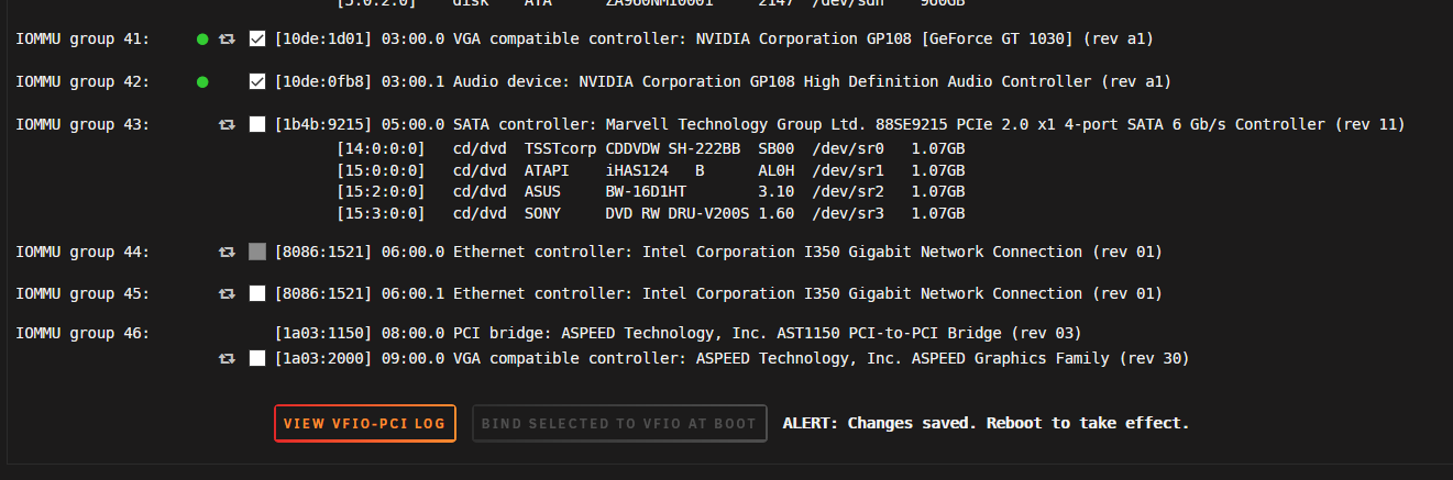

slipstream Posted April 4, 2021 Posted April 4, 2021 (edited) Hi All,I have hit a brick wall and I am kindly requesting help from anybody in the community that may know anything about the error I am getting shown below after I run the SpaceInvaderOne vBIOS dump script. Okay dumping vbios file named 1030fanless.rom to the location /mnt/user/isos/vbios/ cat: rom: Input/output error Um.... somethings gone wrong and I couldn't dump the vbios for some reason Sometimes when this happens all we need to do to fix this is 'stub' or 'bind to the vfio' the gpu and reboot the server This can be done in Unraid 6.8.3 with the use of the vfio config plugin or if you are on Unraid 6.9 or above it can be done directly from the gui in Tools/System Devices .....So please do this and run the script again Additionally, I get the same error even after I perform the fix SpaceInvaderOne mentions in the video link below relating to binding to the Nvidia VFIO which the screen capture below shows I followed: https://www.youtube.com/watch?v=FWn6OCWl63o I am running 6.9.1. My motherboard is a Supermicro X10SRH-CF. My CPU is XEON and my GPU is an Nvidia GT 1030. The script does not fix my Nvidia passthrough problem and the recommendation to bind to the VFIO and then reboot does not work. Has anybody out there in the community successfully passed through an Nvidia GT 1030 card? I am beginning to think I should return this card to Amazon and buy some other card. However, not sure which one to buy. Any tips welcome. Does anybody out there have any suggestions on what else I can try to get this script to work correctly? Lastly, if anybody in the community can email SpaceInvader One the link to this post it will be much appreciated. I would like to know what additioanal troubleshooting I can perform so I can get this script to work successfully. Thank you. Edited April 4, 2021 by slipstream Quote

Auxilium Posted March 10, 2024 Posted March 10, 2024 Unbinding the driver helps (0000:08:00.0' is card address and vfio-pci is driver name, replace either accordingly to what you have atm): echo '0000:08:00.0' > /sys/bus/pci/drivers/vfio-pci/unbind echo '0000:08:00.0' > /sys/bus/pci/drivers/vfio-pci/bind Quote
