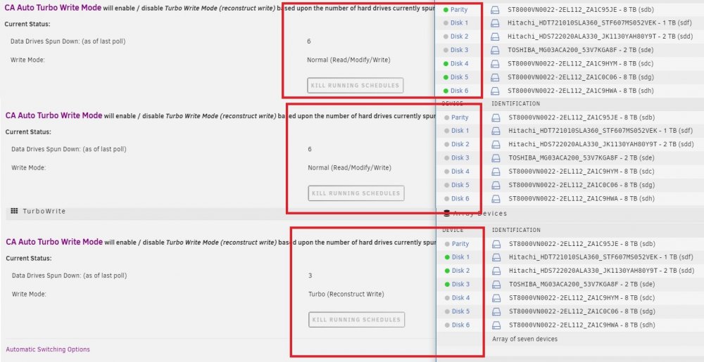

  • Ok, thanks. Will look in to it. Never seen 0 spun down. Always at least 1. Edit: hm, sdg is spun up. smartctl -i -n standby /dev/sdg seems to work better. Nothing "unknown" with smartc

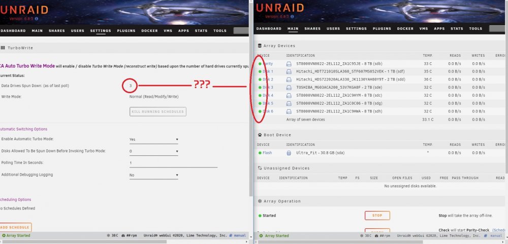

The current status drives spun down (as of last poll) sits at 3 all the time (i have 3 drives plus a parity in my array), even when all drives are spun up, and the polling time is set very short.
I can get it to activate turbo writes by setting the Disks Allowed To Be Spun Down Before Invoking Turbo Mode to 3, but I want to be able to set this to 2 or 1 so that turbo writes will only kick in if most of my drives are spun up anyway.
EDIT: had a reab back about smartctl and hdparm, and looks like my USB enclosure for my drive isnt passing this info through correctly :(

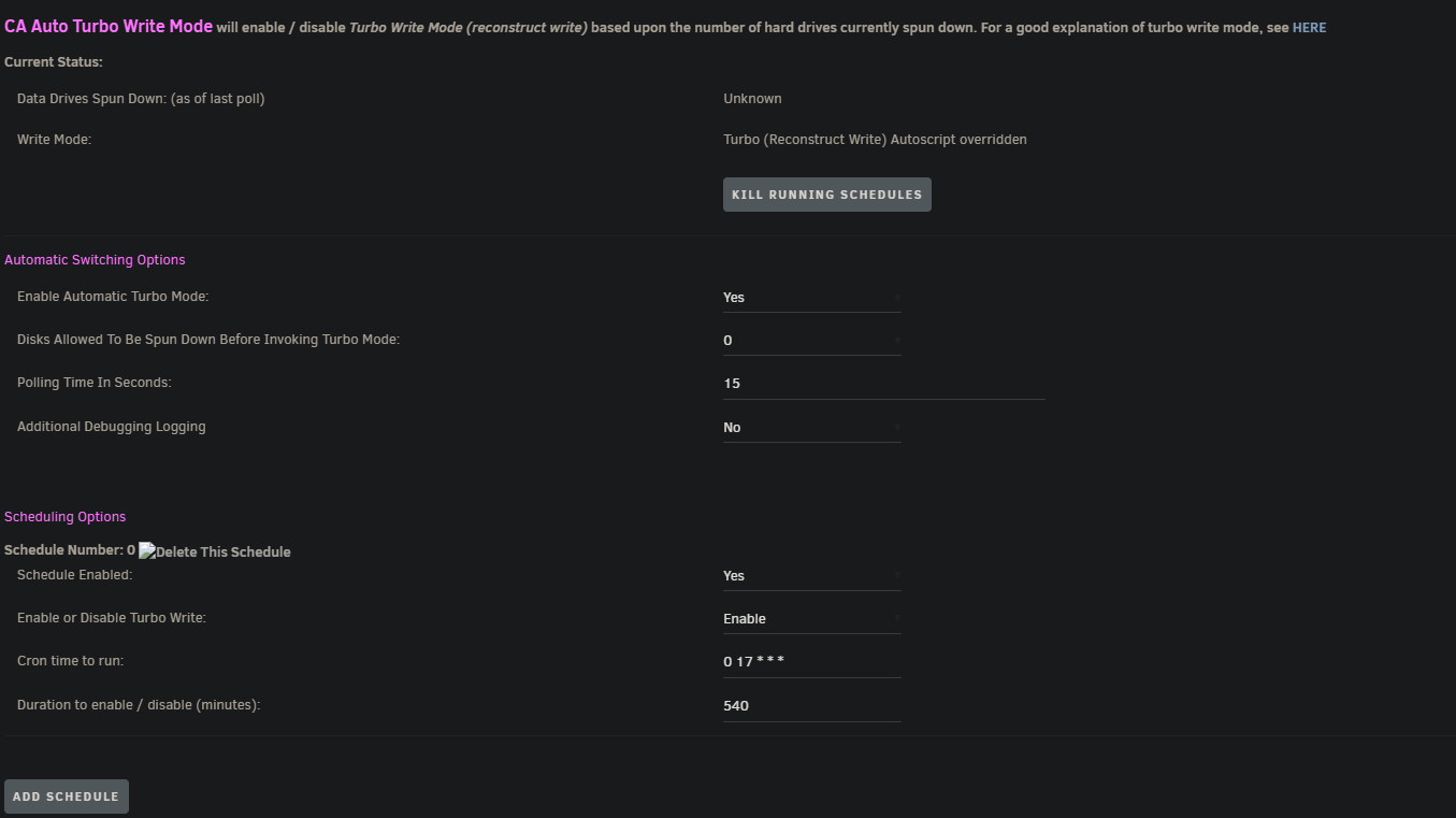

I just set a schedule for my drives last night, but I dont understand the error I am seeing. Can someone help me with this? My goal is to only have turbowrite on from 5pm to 2am, and have the drives able to spin down any other time.
